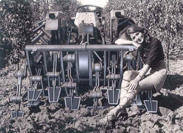

   / Tiller has problems on new tractor #6
Greetings Scaper,
The rotavator scoops like a shovel and lifts and throws the dirt at the same time it is operated like normal tiller but with a reciprocating crankshaft that lifts and pushes the shovels in the ground and then throws the dirt behind it.
Not wanting to open old wounds, but have you recieved the replacement PTO shaft yet for your snow blower?:thumbsup::
   / Tiller has problems on new tractor #7
I like the old B&W picture better..
Have never seen one of those..
   / Tiller has problems on new tractor #8
YES SIR,
That handsome woman is in distress and needs some
help repairing her rotary spader alright!!!!
I wonder how many that sold after that picture?:drool:;):laughing::thumbsup:
