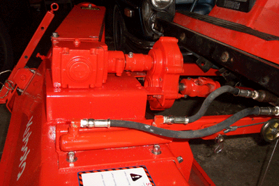

What about the direction of rotation? Is the direction the same as it was before modification?
   / Tiller for Front Mount Tractor
Good question, Jerry. Actually there were two aspects of the drive train that had to be dealt with, direction and speed of rotation. The tiller was designed for 540 rpm ccw rotation. The pto on the tractor is cw roatation at 1100 rpm in low range. I found a 2:1 reversing gear box which I installed between the tiller gear box and the drive shaft. The attached picture is with the shield between the tiller gear box and the reducing gear box removed.
