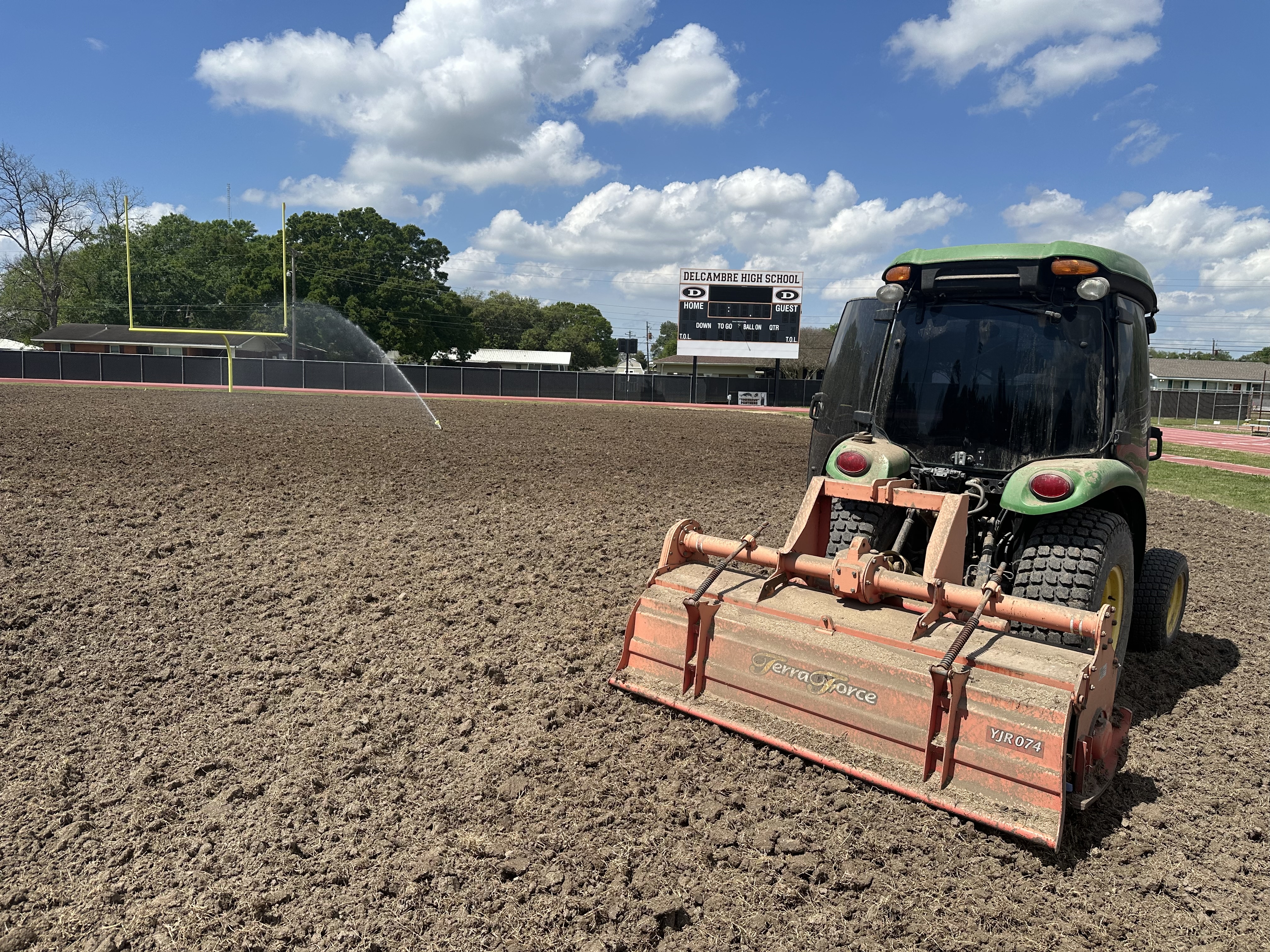

I have a JD 3720 which is about the same horsepower as the 4044 (probably a little less). I have a Ansung 74" tiller on it and it handles it well. If I put the tiller all the way down, it will slow the engine down. I do use it a lot and I'm on my 3rd set of blades. But it hasn't always been used on my JD 3720.
