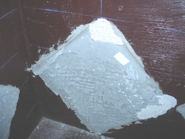

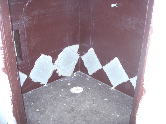

Wife hired a friend to do tile in shower. he got the first row on. Dunno if it needs to be known but the tile is going in, on the diagonal.
She doesn't lilke how he spaced his first row and wants to redo it. Of course, the "glue" has dried.
He used Versabond, Fortified thin-set mortar if I picked the correct bag out of the mess.
The tile is adhered to 1/2" Durrock.
My question is... she's adament about wanting to redo this row or at least three pieces on one wall.
Can I "easily" remove the tile from the durrock without breaking the substrate or should I just plan on removing that piece and reinstalling a new piece of Durrock?
The Durrock has the rubber mat behind it too (going across floor as second water barrier)
Thoughts?

Just wondering if you have fired the friend? If not maybe you should take him out for a beer and explain what is going on. Darn if he comes in and looks at what you might do, who knows what will happen.
So if he is still on the job then tell him what he has to do and go from there. There is a bunch of tile to lay so I wouldn't expect him to want to lay a row and then have someone come in and inspect and mark any that need to replace.
As far as taking some of the tiles off from the durrock you might be able to get the tile off, but if you damage the rock you should replace or repair the piece.
I have replaced damage tile, normally it is tiles that have been down for a long period of time. You have to cut free all of the grout and then take a hammer and cold chesel and hit the tile to crack it, once cracked then I have a Fein Multimaster tool that can get under the tile and cut loose the bond.
I don't think you want to run out and buy the tool as it is not cheap, basic unit is over 200 and the tile kit alone sales for over 130 dollars, so for two or three tiles it might not be worth the expense.

The tile should come off the substrate pretty easily with a chisel. If you have any questions about tiling I would recommend Ceramic Tile, John Bridge Tile, Marble and Stone
There are a bunch of professionals over there that are more than willing to help out DIY guys.
BTW, a tile shower is one of the most difficult things to do correctly. I'm planning to do some tile showers and have read quite a bit. There needs to be a waterproof membrane in the shower. The tiles are not waterproof, moisture will get behind them.

I'm with ya on that Kevin... We had him build up the concrete floor, add the membrane, another layer of concrete... then on the entire shower walls, we installed durrock and over THAT he painted on some kind of purple stuff (I forget what it is). I installed 2x12's in between the studs as a backer board for the rubber matt to be attached to. It's supported 100% and not just tacked to the studs. The purple stuff is some kind of sealant that supposedly would allow me to use the shower "today" without any kind of tile and it would be waterproof.
This shower, other than the framing & plumbing, is one thing I wanted to hire out completely. Water is one thing I don't want to mess with because as I told the wife, we'd only have one chance to get it right.

It sounds like you've done things correctly. Those other tiles should just pop off.

The tile will come off with a chisel.

I wouldn't do anything without first talking with the guy doing the work. In tile work you often have areas where the pattern is less than perfect because it affects the pattern in another area. It's common to have some area of the project be something of a compromise. He may have a very good reason for that area looking like it does, or maybe not. Anyway you need to think of the entire layout not just one area.
