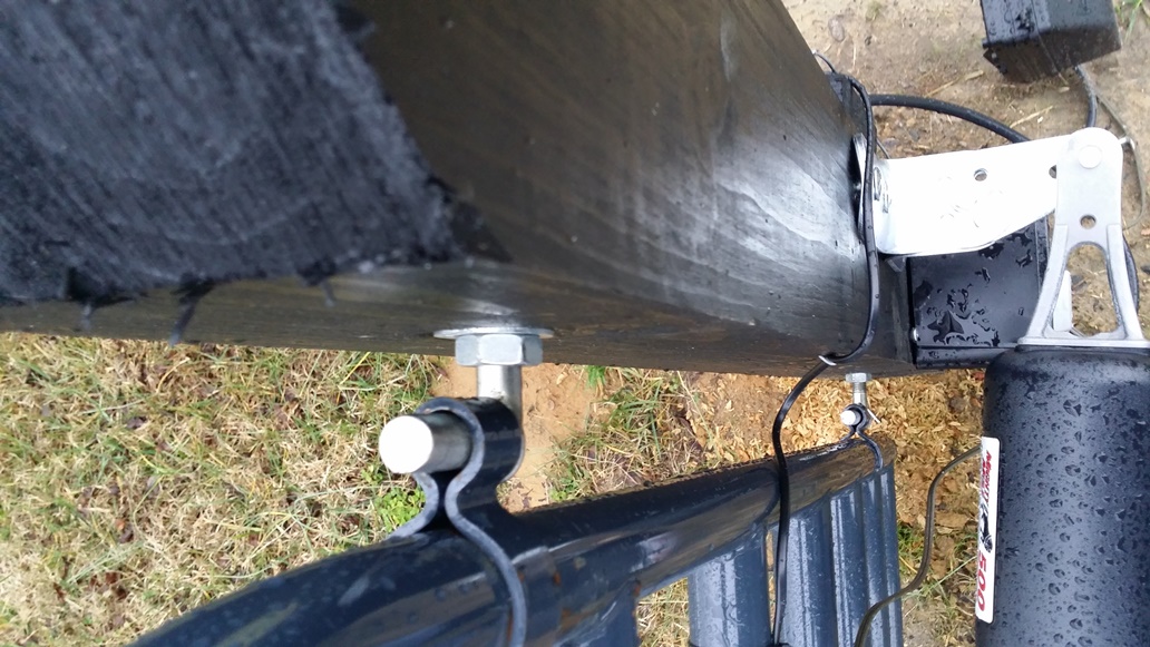

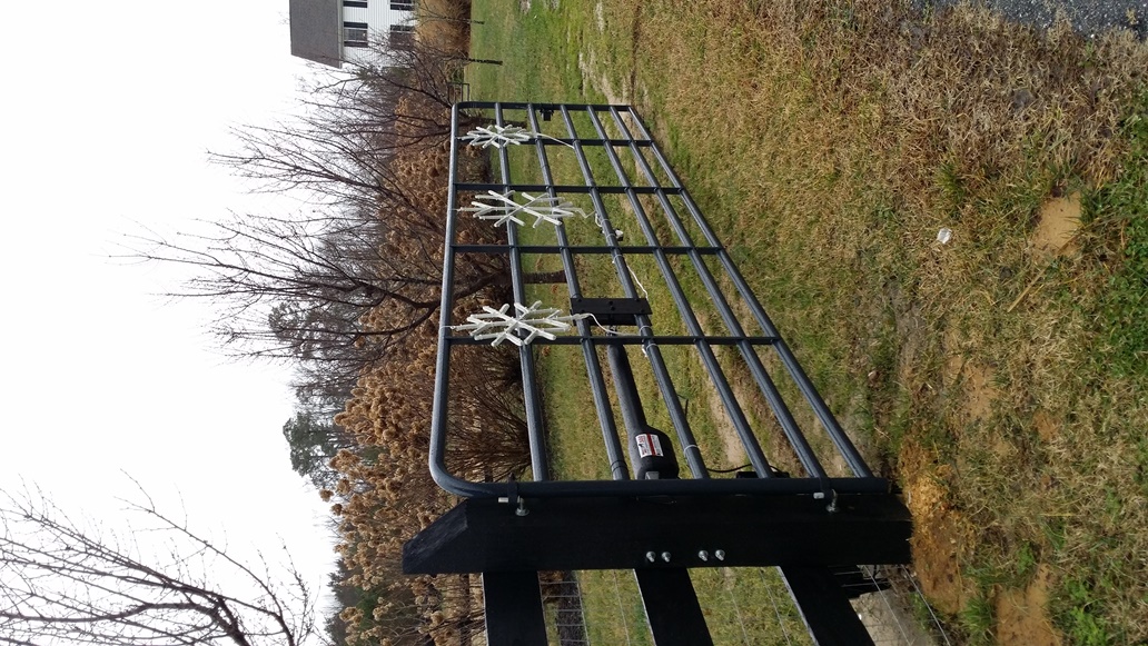

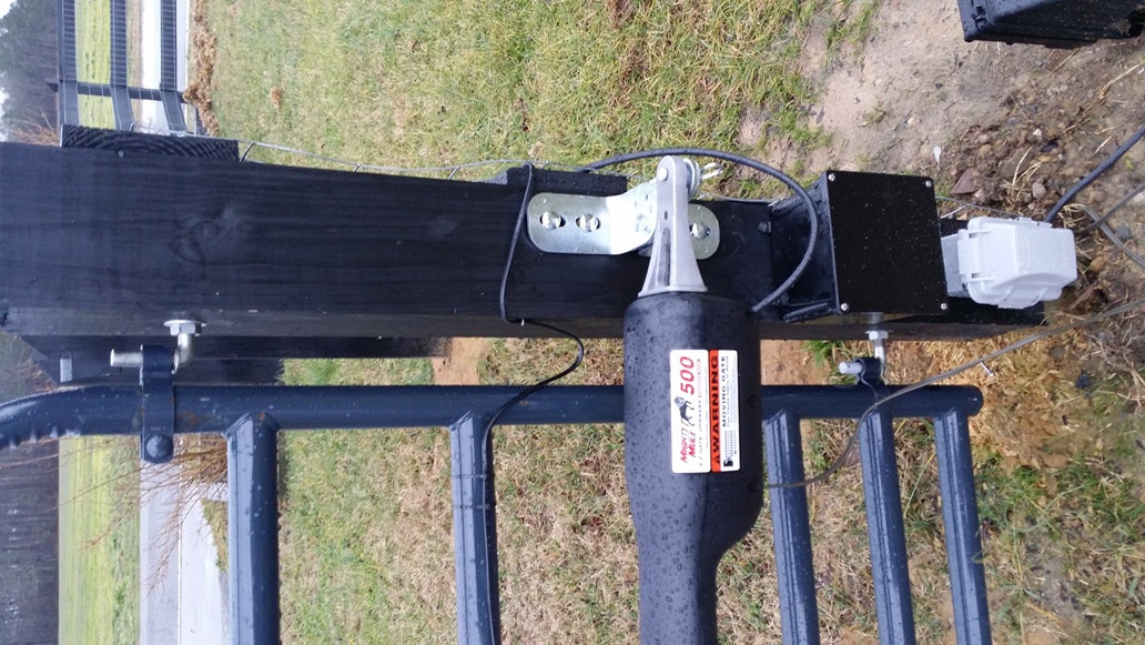

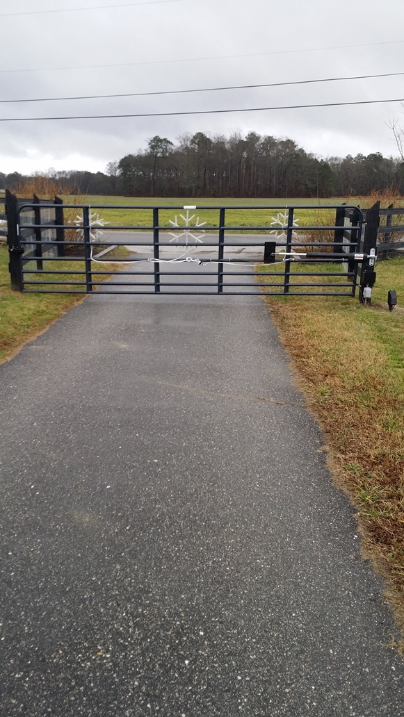

I guess a picture is worth a thousand words, so...
Canted
Straight and level when closed
Droops when closed while level closed.
Bottom bolts is pushed out to allow for slack in the hinge.
Better view of bottom bolt pushed out.
You can see that I have the bottom bolt screwed out to get the gate to level when closed. The 2 bolts are perfectly level. The 6x6 post is set 4' deep in concrete. In order to get it so that it doesn't drag the ground when closing, I had to rotate the top mount, but that leaves it canted when closed. I'd prefer it to be straight and level in all directions. Seems the only way to achieve that is with bearing hinges.
