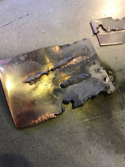

OK, my setup....
Scratch Start Tig
100% Argon
#6 Cup
Matheson Select 3.32 Blue Tip E3 Tungsten Electrode
Everlast PowerArc 200st
Setup for 16 Guage Mild Steel
25 Amps on Meter
15CFM on Argon
Results - A lot of burn through.

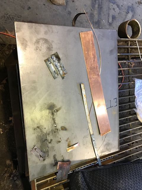

Setup for 24 Guage Copper
20 Amps
15CFM
Results - Incineration. By the time I got a puddle I burned through. I tried laying some filler copper on top, see if that would help, torched right through.
While I am a beginner, I am not sure the issue is me. Maybe 20 Amps is too much for this stuff (WOO HOO I get to buy a real tig machine) but I think not. All the charts and while none I have found mention 24 guage copper, it seems to me that I need a lot more than 20 amps to make it happen.
Looking for any and all comments.

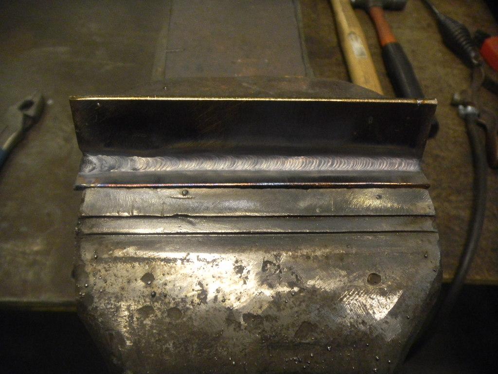

My PowerArc 200ST runs about 10 to 15-amps hotter than any of my other welders. I've never been very good at welding that thin of material:eek:. There was a time in my life where I thought 3/8-inch thick metal was sheet metal:D. I think something that thin, a foot pedal would come in real handy.
Here is some Tig welds I made with my PowerArc 200ST.

   / Tig Welding Failure, what am I doing wrong
Yup, I hung up my scratch tig kit today. I reversed the Polarity, and while it spread out the heat, once the copper got hot it still just vaporized no matter how I moved. It is clear to me that the 20 amps my meter reads on my welder is more like 50.... There is probably some way to check this...
Anyway, I did tig on thicker metal, and it works pretty sweet. Slow as snot but I get it and I get how cool it could be.
The downside is that I am 100 in the hole on a scratch start tig system I will not use. The upside is that I see a nice tig rig in my future.... Tigging is pretty cool, I don't want to say easy but I get how it is an attractive way to weld.
