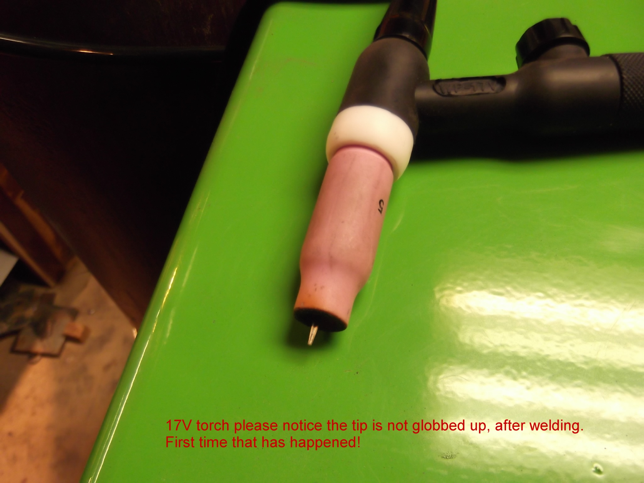

IMG_20121117_165336_859.jpgIMG_20121117_165303_772.jpgPicture 015.jpgPicture 007.jpg17V torch.jpg
here is mine, a little PA160 by Everlast.. I stick weld with it up to 160 amps with a 60% duty cycle. ( I have never used above 140 though). and I TIG weld with it with a 17V torch and regulator and argon cylinder. Stick for the big stuff, and TIG for the little/thin stuff.
