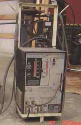

For about 10-years I Tig welded with this machine.

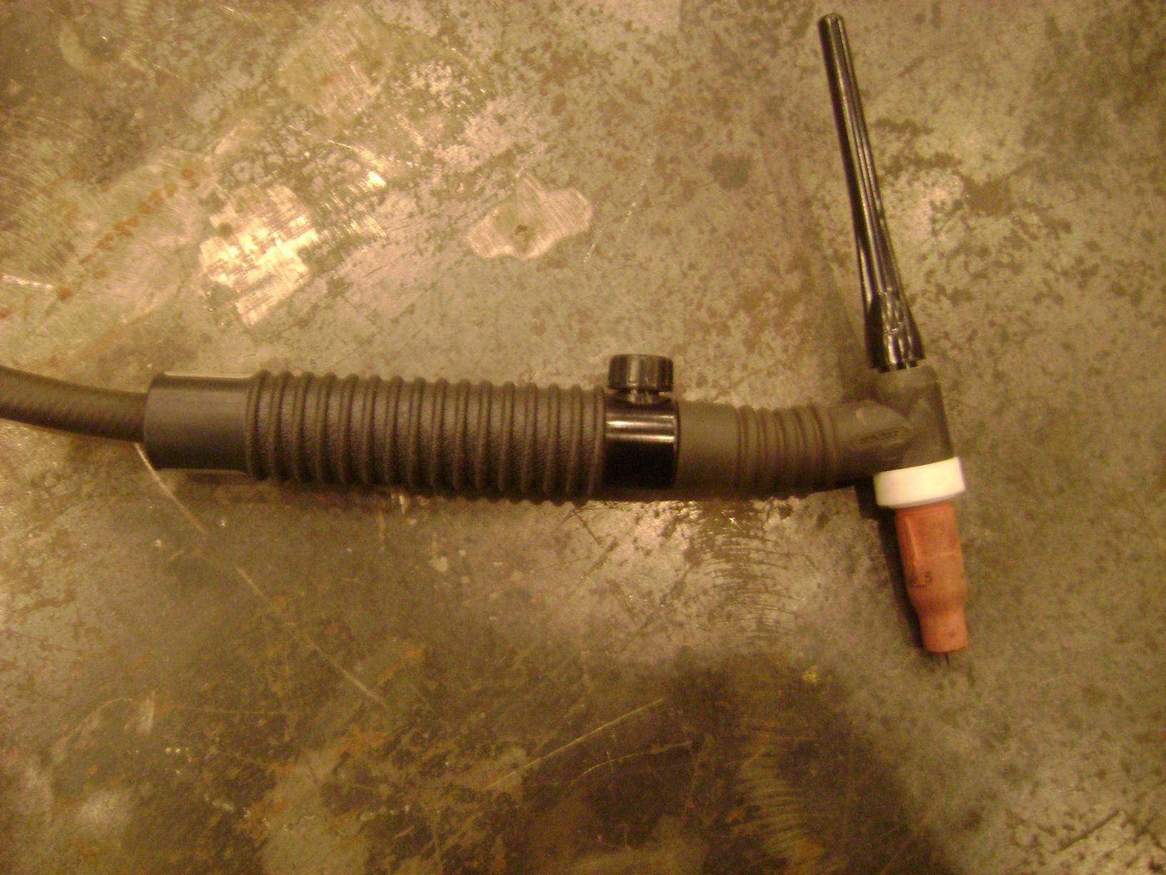

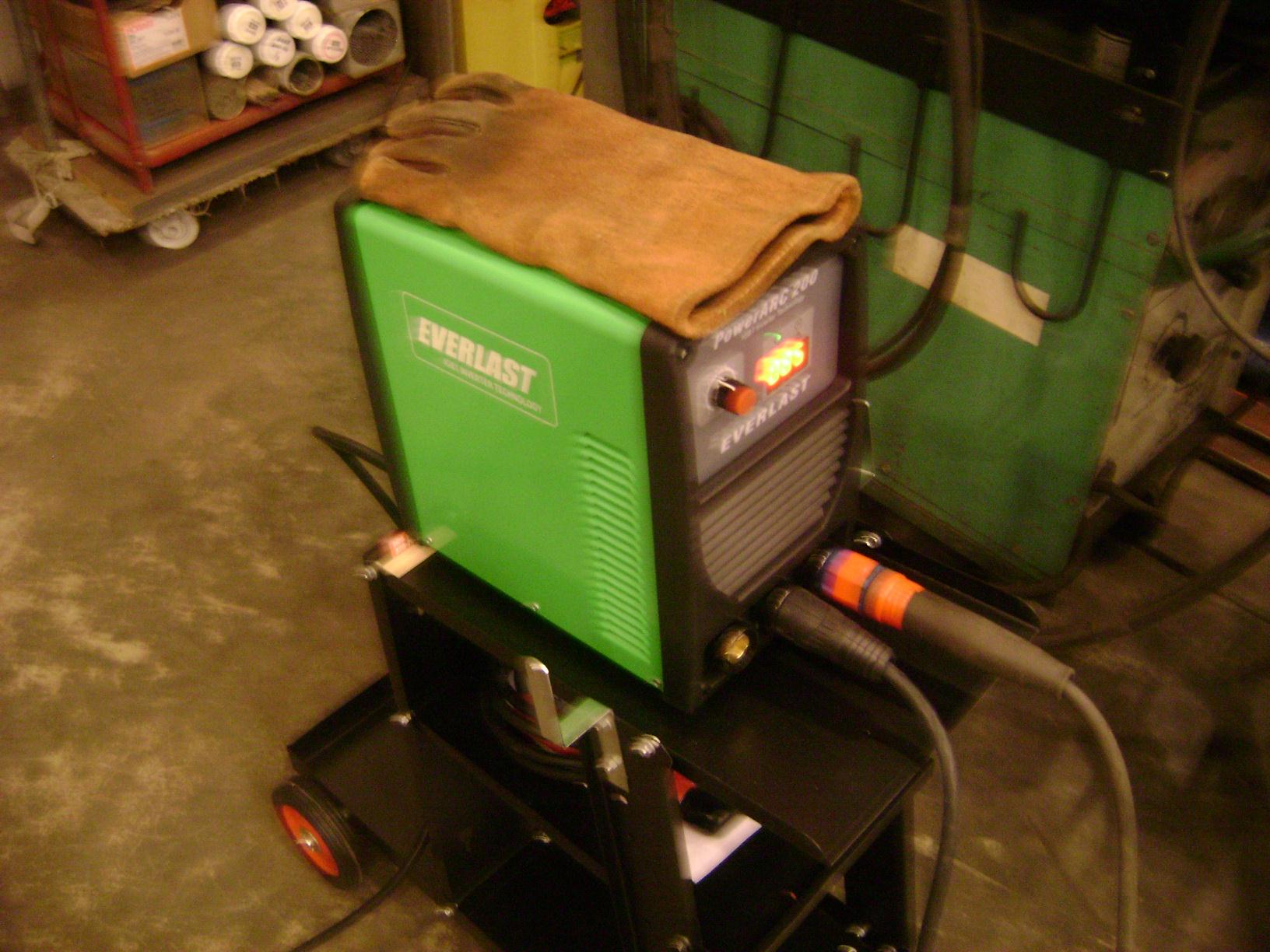

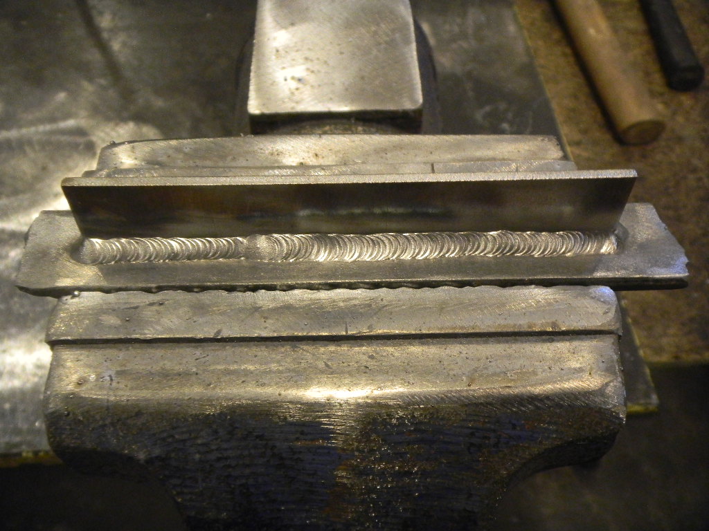

When I first got my Everlast PowerArc 200 I played with my scratch start Tig torch just to see how it would do. Little stainless steel to mild steel.

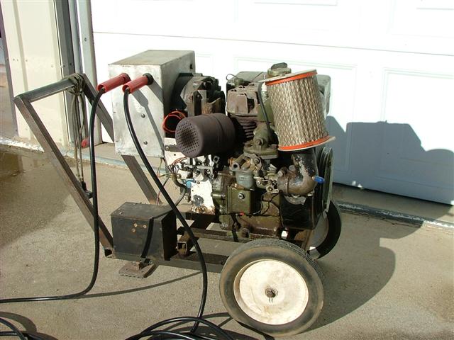

I made a portable DC welder using a modified car alternator. It would drive a tig torch quite nicely. I made a foot pedal to control the amperage. The high frequency ripple in its output seemed to improve the welding action, at least that was my perception.
