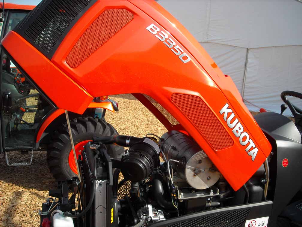

First, it only impacts new tractors above 30hp. I expect the major impact to be initial cost.
Here is the new Kubota B3350. With this new CUT, you get electronic FI control and a cool-looking
stainless steel exhaust system. You can see the 2 sensors on this one, used to monitor
the Diesel particulate filter/burner. The Kubota factory guy says you should not need to service
it for 2000-3000 hours, but then it will cost over $500 to do so. No urea system on this one.
