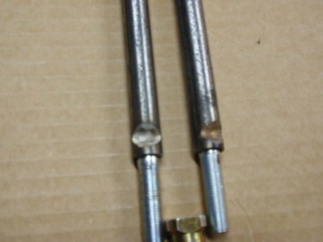

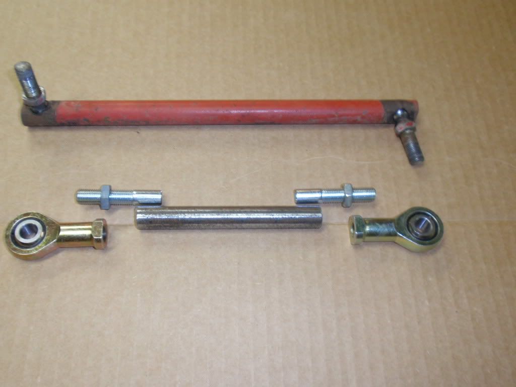

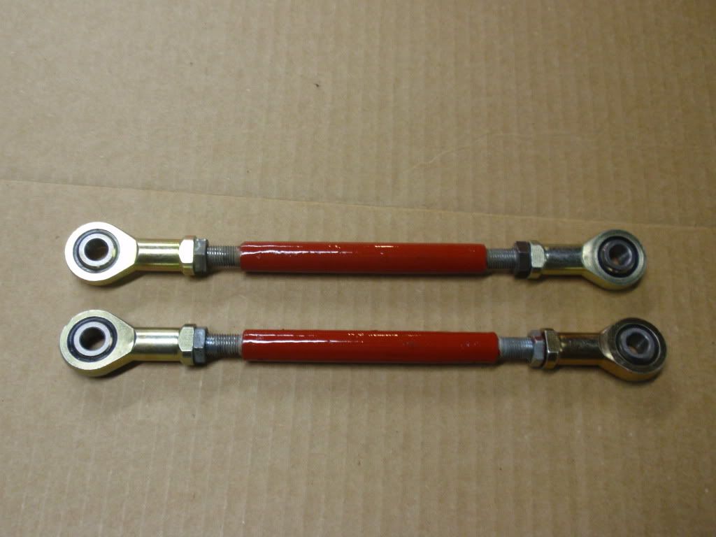

I posted this in another forum----
I made these for my C175--
The Tie Rod Ends are Stens 245-068 All are Right hand 3/8-24 thread. I cut off the heads of three bolts and welded them inside a 3/8 sch. 40 pipe.
While welding the studs, I decided that a long length of 3/8-24 all thread, could be slipped through a section of pipe after running a 3/8 drill bit through it. That would require no welding. The pipe would then be used for cosmetic purposes. I already had the bolts and some scrap pipe.
My total cost was less then $30.00 for the Rod Ends.
http://i1136.photobucket.com/albums/n498/Yelrug/P4050018.jpg
http://i1136.photobucket.com/albums/n498/Yelrug/P4040004.jpg
http://i1136.photobucket.com/albums/n498/Yelrug/P4040016.jpg
http://i1136.photobucket.com/albums/n498/Yelrug/P4040010.jpg
