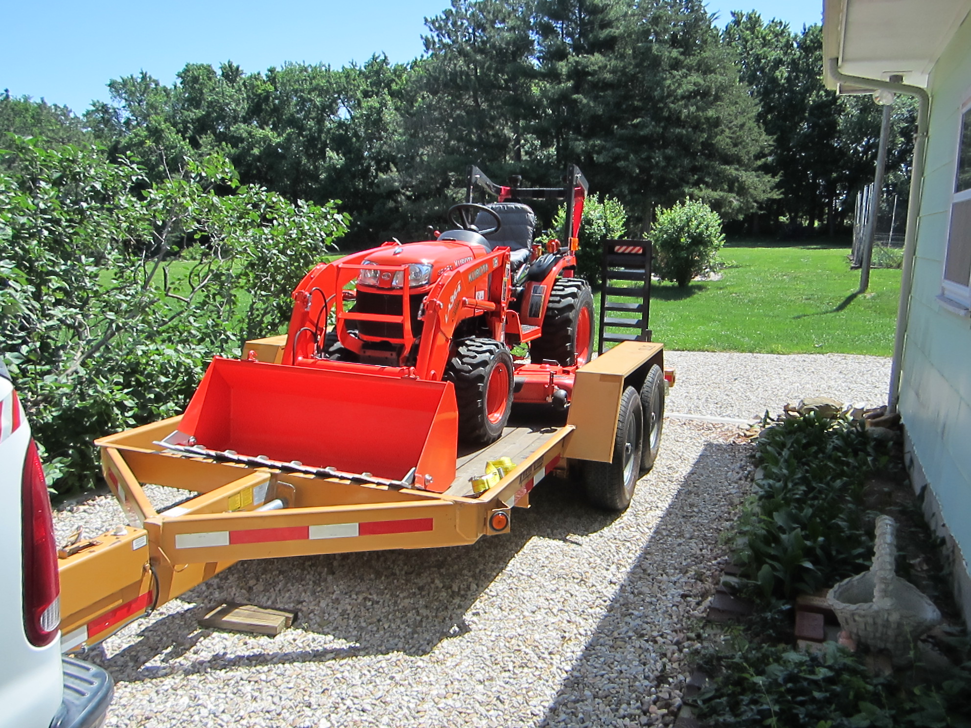

Hey everyone, I know this has been brought up before and I have done a lot of searching on the internet, but I'm trying to figure out ideas for tie down points on compact tractor. I'm looking for pictures to give me ideas. I'm trying to decide if I want to weld a chain hook to a flat plat of steel and then bolt it to the frame of the tractor or do something else. Any ideas would be greatly appreciated. Thanks

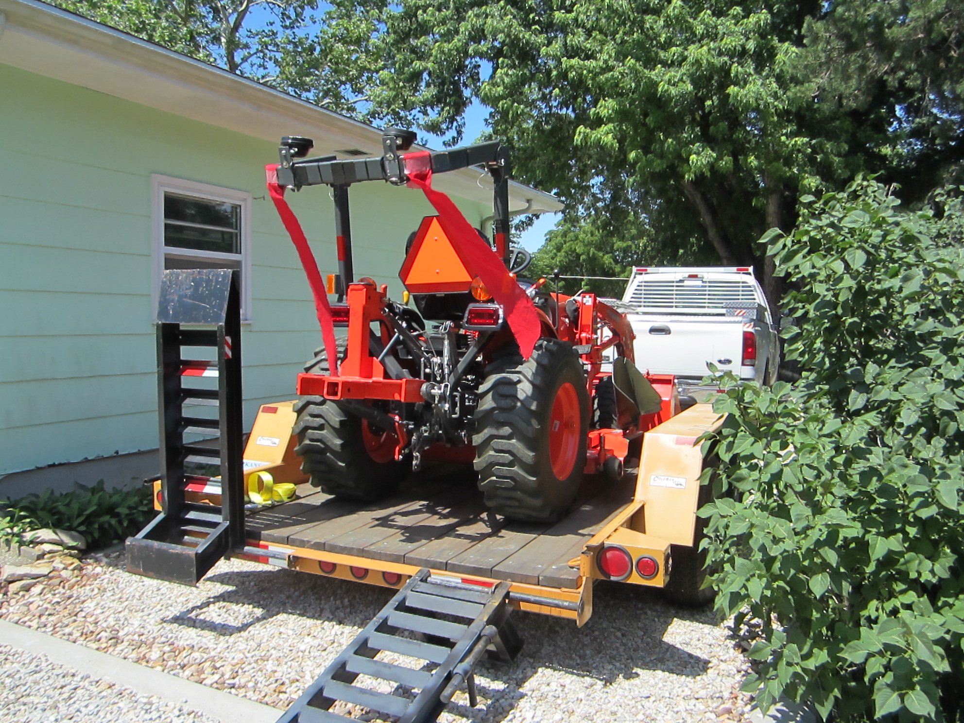

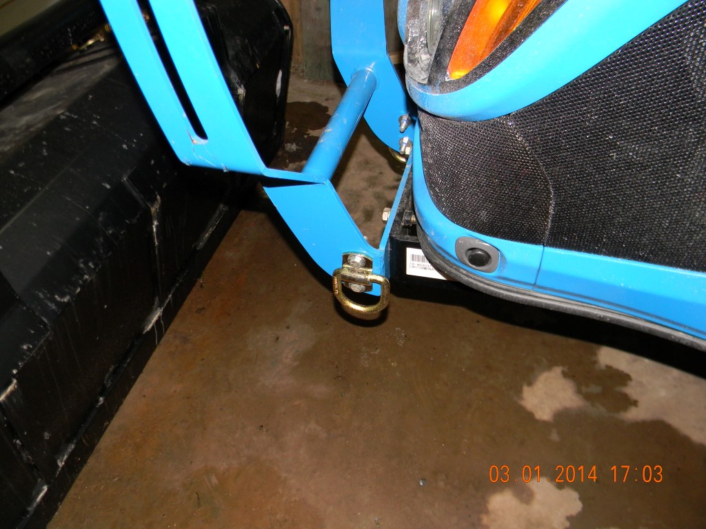

I bolted a couple D-rings to my brush guard and use a twisted clevis on the rear as tie down points.

My tractor has hooks on the rear welded from the factory.
On the front i welded hooks to plate steel then drilled it to fit the factory holes that also attached the FEL

I use straps that are carefully placed over/under the front and rear axle. I am agile and can weave the strap through the tractor axles to the D-rings at each corner. Rub points are cushioned with some old towels. Didn't have to modify anything for my B2620. This serves for mounting with only the MMM attached. FEL uses another strap. I don't have a Rear mower.505.JPG509.JPG

I had a couple D rungs welded to the back of my ROPS. It allows me to go over anything that may be attached to the rear of the tractor without grief. Also welded a couple at the front of the grill guard.
