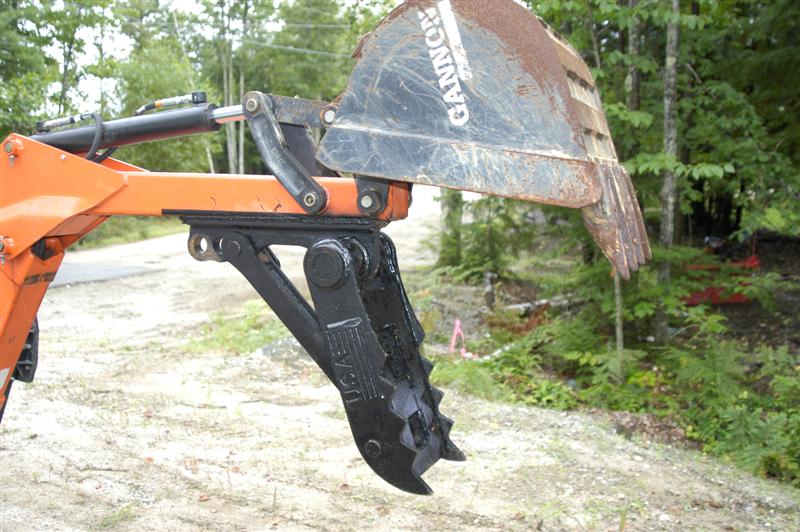

Here's where I bought mine. Great quality, good service and a lot of choice.
I wasn't sure about size on mine. I sent them the make & model of my BH and a few measurements they asked for.
You'd think my thumb was custom made.
Excavator Thumbs by USA Attachments

I put a thumb on my L48, extra wide thumb for rock work, thumb is on same pivot pin as bucket which is very important. Also, having a wide thumb, as opposed to KX model excavators stock thumbs which I have as well, it allows you to close the thumb on a big scoop of dirt and load trucks with your bucket curled out for that extra reach. When working with large rocks and and a skinny thumb, it wants to pivot the rock one direction of the other. Addington equipment in Chichester, NH did mine. $3-4K for L48 thumb professionally installed. Best money spent.

I have A USA Attachments MT830 on my L39 and currently have on order a custom HT4214 pin on bucket hydraulic thumb for my new to me Komatsu PC75UU-2E. Total cost with installation will be about $3000 as the excavator is already plumbed.
