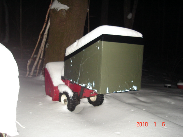

Another possibility: when I regularly used my walk-behind blower I had the same problem- no matter what I did, water would get inside the cable(s) and freeze; I had to set the throttle to a start position before shutting it down, so it could at least start the next time (still do that, just in case).
What I did to solve the problem was fashion a cover for the engine and controls area out of 1" styrofoam board- it drops over the handles & controls, and extends all the way up to just behind the exit chute. When that cover is put on right after the unit's shut down, the residual heat from the engine melted all the water & snow, not just on the controls & cables, but all over. Then it just dripped off. Also kept snow off the whole thing between use. Never had a problem after that.
I covered it with iron-on plastic model airplane covering to make it waterproof and slick. Any way you could do the same for the troublesome area?
