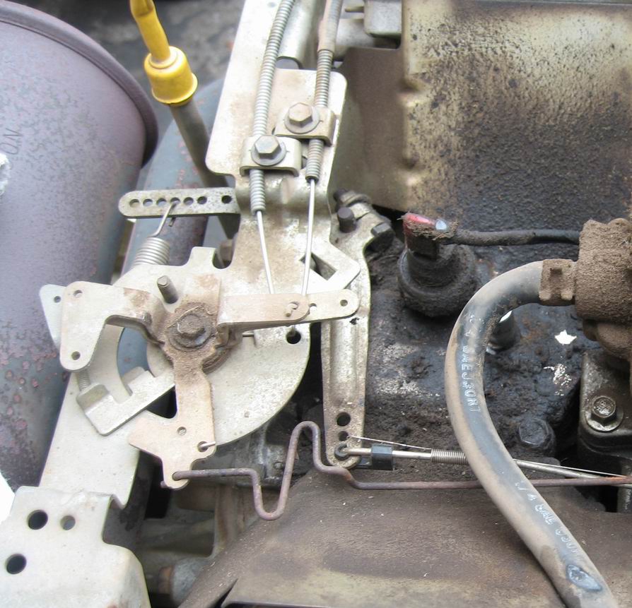

Can someone take some pictures of their Cub Cadet 1863 or 1864 throttle assembly for me. A spring fell off the underside while replacing the throttle cable and it is not obvious where it goes.

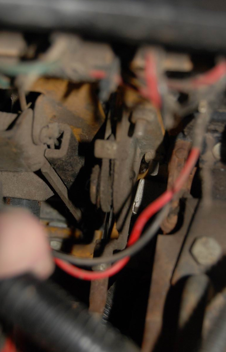

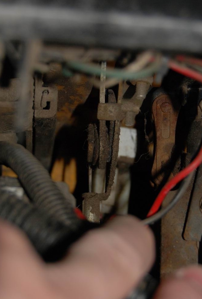

I looked over my 1864 and the attached photos are the best I could do in the tight confines of the underside of the instrument panel.

   / Throttle assembly on Cub 1863 / 1864
Thanks,

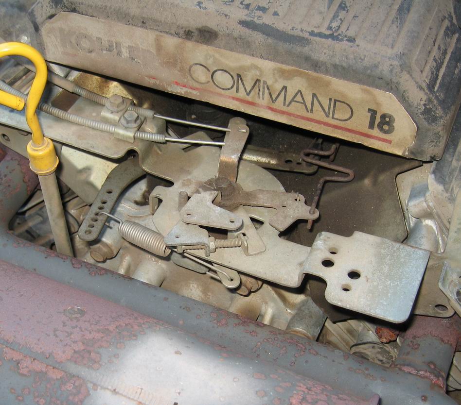

I should have been more clear, The spring fell off the underside of the lingage at the carb, not at the control panel.
Can I trouble you for another picture or two?
   / Throttle assembly on Cub 1863 / 1864 #4
Do either of these help?
Perfect. Thanks again.
