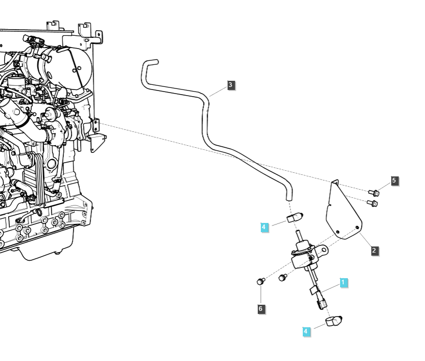

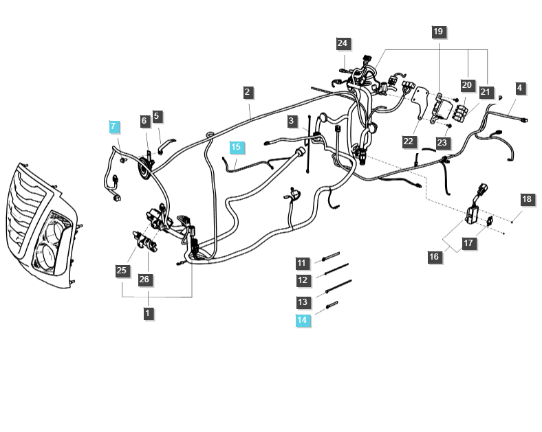

Hello, I have owned this LS XU5055 for ten years now and have had this same problem since it was new. After a few minutes of using the brush mower on the tractor the throttle returns to an idle and the hand throttle becomes unusable. I can continue using the foot throttle but it only lasts a few more minutes before it too becomes unusable. It will remain idling but that is all. Once it sits and cools for a time it will return to normal operations for a few minutes again. It also happens in the winter when I am pushing snow so it isn't due to heat. I sure could use some advice on how to correct this problem! I contacted the dealer when it first started but obviously he did nothing to correct it.

Looking at the schematics & wiring diagram, I'd check the connections to the feed pump (24 in the second image).
   / Throttle action becomes inoperable #5
Normally there should be fault codes displayed on the dash when this happens. Check all the grounds and wire connectors. It is possible the hand or foot throttle sensor is defective, but sometimes a bad crank sensor can affect the throttle because they share the same 5 volt power supply from the ECU. A dealer with the laptop service tool can monitor the function of the hand and foot throttle and can also see a screenshot of engine parameters in the stored data log when the fault occurred. They can also see fault code history even if no codes are active now.

Something else to check is the main battery ground to frame & the connections for the main fuse off the positive post. I had all kinds of wonky electrical issues until I replaced both cables/posts/and the main fuse set-up.
   / Throttle action becomes inoperable #8
There should be an error code. Every time the tractor throttles itself down, it does it for a reason. Well, the tractor thinks it does it for a reason, if that reason is warranted or not. The point is, every time the tractor does something the operator does not expect, the tractor tells the operator what it is. They can only 'speak' to us in code: error codes.
Your tractor is going into limp mode for a reason. You might be correct with the cooling cycle. Check to make sure your radiator is completely clean and you have a full radiator. Also, check the coolant for protection. Too much straight antifreeze is not good. 50/50 mix.
The next thing to check is your chassis ground. As others have mentioned, a bad ground has been the cause of many issues with these tractors. Take it off, use a grinder and remove the paint, use dialectic grease (or even vasoline) to coat the connection, and use a new bolt to attach the ground back to the bare metal.
If the problem continues, check the sensors. The only real way I know to do this is with a dealers help. You'll need one of their laptops.
