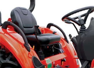

Does anyone know what might be wrong when I mover the lever that raises and lowers the hitch and nothing happens. I have never done anything since I got it but I didn't use the 3 pt. then. Now I need it and would like to know where to begin finding what's wrong. There is no pump sound when I mover the lever in either direction. The lift arms are in the up position.
Ron
   / Three point hitch #2
Make sure the valve down by your feet is not turned closed.
   / Three point hitch #3
If you have rear remotes, be sure the lever is centered (not in detent).
   / Three point hitch #4
Have you read the Three Point Hitch section in your Kioti Owner's Manual?
   / Three point hitch #5
As Murphy says, there is a dial, between your feet, that controls how fast an implement, on your 3-point, lowers. Some are marked fast / slow, others are + / -, etc.
Try rotating control opposite from where it is now. Without an implement on your 3-point, you may have to stand on one of your 3-point arms to get it down.
