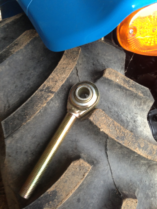

My 5030 came with a cat 2 & cat 1 end for the top link you screw in the end as you need to change. It was behind the seat on the floor.

Here is my cat 2 end for the top link

You will likely never miss 3" of adjustment on the top link. Go with category 2 and just use reducing bushings for your pins.and if you ever have a reason for the extra adjustment just put the standard top link back on for that rare instance when you feel like spending 10 minutes screwing it out and in.

Ozley - THANK YOU - I got one too but forgot about it - am embarrassed about that The tractor end of the top link is set up for 3/4" pins only and I didn't stop to think about the other end being interchangeable.
Thanks to all of you you helped clear up my confusion and fuzzy brain on this issue.
