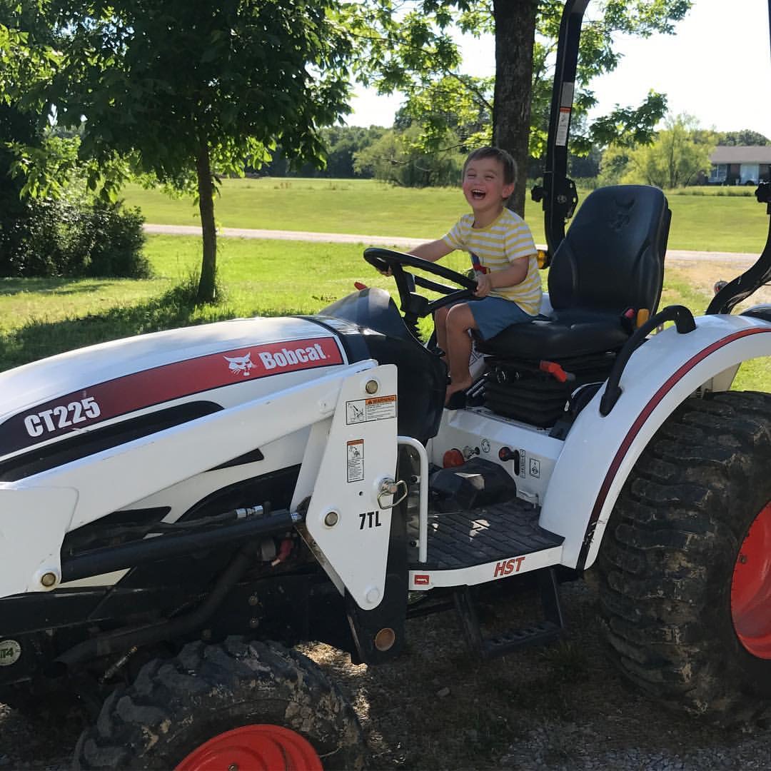

Found the culprit.. Hasn't found a button, switch, or knob he didn't want to push, turn, flip, etc..

Wow it still looks like new.
   / Three point hitch not lowering #6
the little guy looks proud of messing with you to...
   / Three point hitch not lowering #7
From this granddaddy that is a great picture. Sure tells a big story.
Thanks guys. He plays with tractors all the time. Has tractor pajamas, etc.. I know next year it'll be something else, but right now he loves tractors, and his Pops (or maybe it's just the tractor, ha)
tman, I washed it before he came up last time. It's a mess right now. It does only have 120 hrs on it. I keep it inside too. If it wasn't for the wrens that moved into the barn,,, well, maybe being white helps.
