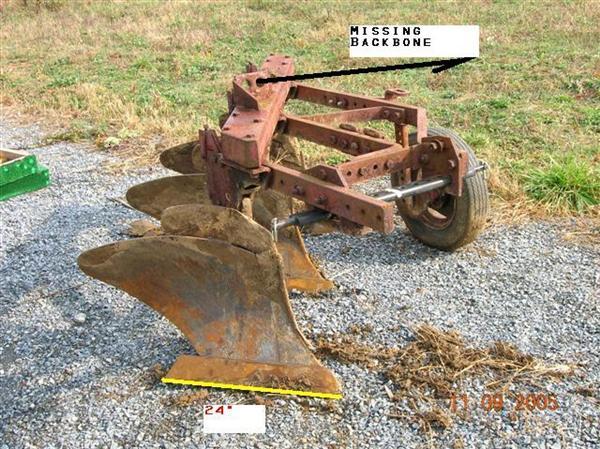

Here are the pics. The backbone is missing. It broke at an old weld at the "T" where the third point of the hitch attaches.

What happened was I noticed Kevin listed a 3-bottom plow in his profile, along with his JD 4710. I was curious as to how big that plow was, and how well his 4710 pulled it.
Can't tell if it's a 3x12, 3x14, or 3x16 in the pics yet, but I'd say that's a pretty good pull in any case for a CUT.
(Especially for a hydro! /forums/images/graemlins/wink.gif

I'd be real curious as to how that plow would work hooked to a 3pt, and how it could possibly be adjusted to do a decent job plowing. Not that I doubt it can be done, but real curious.
Seems the 3pt drawbar slipped in there is way too high to pull the plow without it putting undue compression on the top arm. But that is just a 'feeling' without knowing.
Would you have some pics of it hooked up and in the ground?
Or will you be getting it repaired and in the ground yet this fall or not until Spring?
Anxious to see how it turns out, and apologize for horning in on your thread with TIMB /forums/images/graemlins/tongue.gif
Must be the "backbone" is the top link?

Several things. 1st. The drawbar obviously is a 3-point drawbar that has been "adapted" to the plow. On a factory-built plow drawbar, there would be an offset at each end to make the plow run level whit one wheel of the tractor in the plowed furrow. (from the previous round)
Generally, plows will run about half as deep as the width of the bottom. The "shins" on that plow look mighty tall. I'd say it's a 16" bottom.
I'm at a loss as to what brand of plow that is. If I was to bet, I'd say it's an Allis Chalmers, but could be a Case. It COULD be an A-C "Snap-Coupler" plow from the WD-45/D-15,17,19 days. If that was the case, there was no top link "mast".
BUT.... That would be a VERY easy plow to convert to 3-point hitch. If it's a 3X16" plow, you PROBABLY will need 55 or 60 HP (at the minimum) to drag it through "average" soils. (At a depth it was intended to plow at) In addition, I'd say you would need 6000lbs (+) (again, in "average" soils)
See if you can identify the plows manufacturer.
(I've got 2 different 3-botton plows right now, one John Deere model 416A and one Ford model 101) Did I mention I have this "thing" for old plows?

Plow is a Farmall Fast Hitch 3 bottom plow that someone has cut the 2 Fast Hitch arms off. I had one for my Farmall 340. Had to remove one of the plows. Tractor could not pull three. Attached is a old ad of a Fast Hitch Plow.
/ Three Bottom Plow for TIMB #10
Yep! You're right! I was thinking A-C or Case because of what I saw as "Orange" paint, but since you mentioned IH, it started looking faded red. Looke like IH "Super Chief" bottoms now that you mention it. Good catch!

"That would be a VERY easy plow to convert to 3-point hitch"
I was wondering if he could just use a chain for the top link to give it a try-out.

I think, like most ground engaging attachments, that the top link is in compression when at plowing depth. I believe that is how depth control works, by being sensitive to the compression when engaging 'hard-to-plow' ground (or too deep) and the depth control raising the plow enough to relieve that 'compression' on the top link.
The 3pt drawbar bolted to this plow appears to be way inside the furrow plow, making it unlikely the right wheel would run in the furrow. Maybe this works this way but it just looked a bit awry. I'd like to see a pic of the plow hooked to the tractor.

Beenthere's right. That top link would be in compression when plowing. The original "Ferguson System" 3-point used that compression to "read" the draft load.
Still, that plow could be easily converted.

I agree the toplink and A mast on the plow is for compression and draft control, however, if this plow was originally a 2 point hitch Farmall/IH, It probably depended on the hydraulic down pressure of the Farmall lift to keep the plow in the ground?--Ken Sweet

Wow! This forum is amazing. I post a couple of picture of an old rusted hulk of an implement, with pieces missing, and a few guys have it identified and know of the
missing parts! Here are some pictures to clear up the details.

Here is the offset drawbar which also broke at an old weld on one of the pins. Yes, I "modified" it using what I had on hand, which is a straight drawbar.
