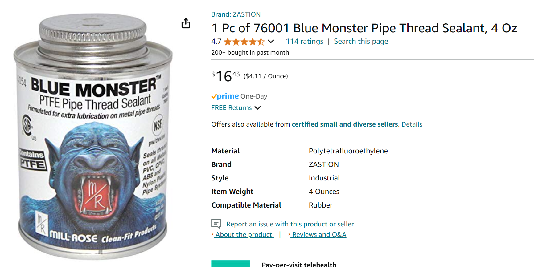

I use Blue Monster on everything
I have that but worry about being sloppy and getting it into fluid. I also have loctite 592 that I have used on engines, but never hydraulic systems.
