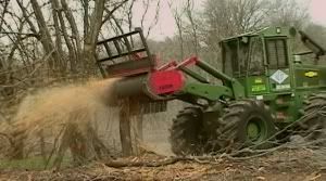

Timber King TK711

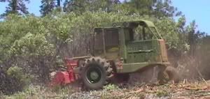

Franklin has a few options.

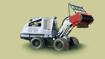

or this one by Geo-boy, it comes in both 200 and 260 horse power.
Anyone have any experience with these type of rubber tired machines in the field?

The Jarraff Geo Boy has the cool factor, but weighing in at 12 ton, with a 200hp Cummings, Fecon Bull Hog, 10 ton winch and 16 ply forestry tires, only medium sized countries need apply.

The only drawbacks I see to the New Holland and the Geoboy are the tires sliding on sloped terrian and getting hung on a tree (sliding down onto the tree). But for larger tracks of land a tired tractor has a definite advantage. You also have to consider who will run it. What would you want someone running, that's my delimia(spell). My tractor is just to unstable and damage could be inflicted quickly. If another tractor is in the future I will but with that in mind.

You can get more power out of a smaller unit if you look hard enough. The franklins are big, heavy and practically take a fuel truck to follow it around.
I would look at a bi directional tractor or a ptgator or gyro track before I looked at a big tractor like a franklin.
