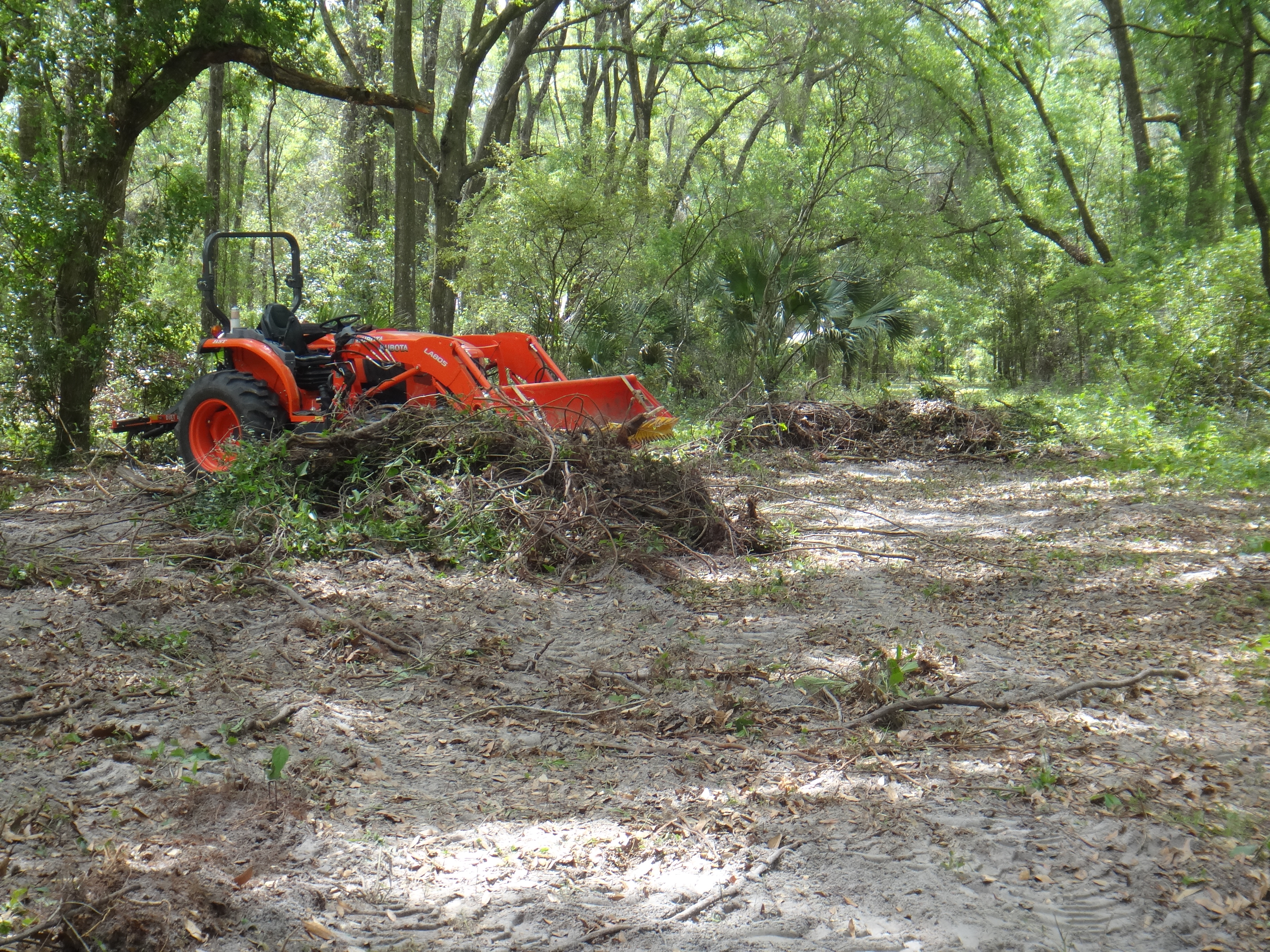

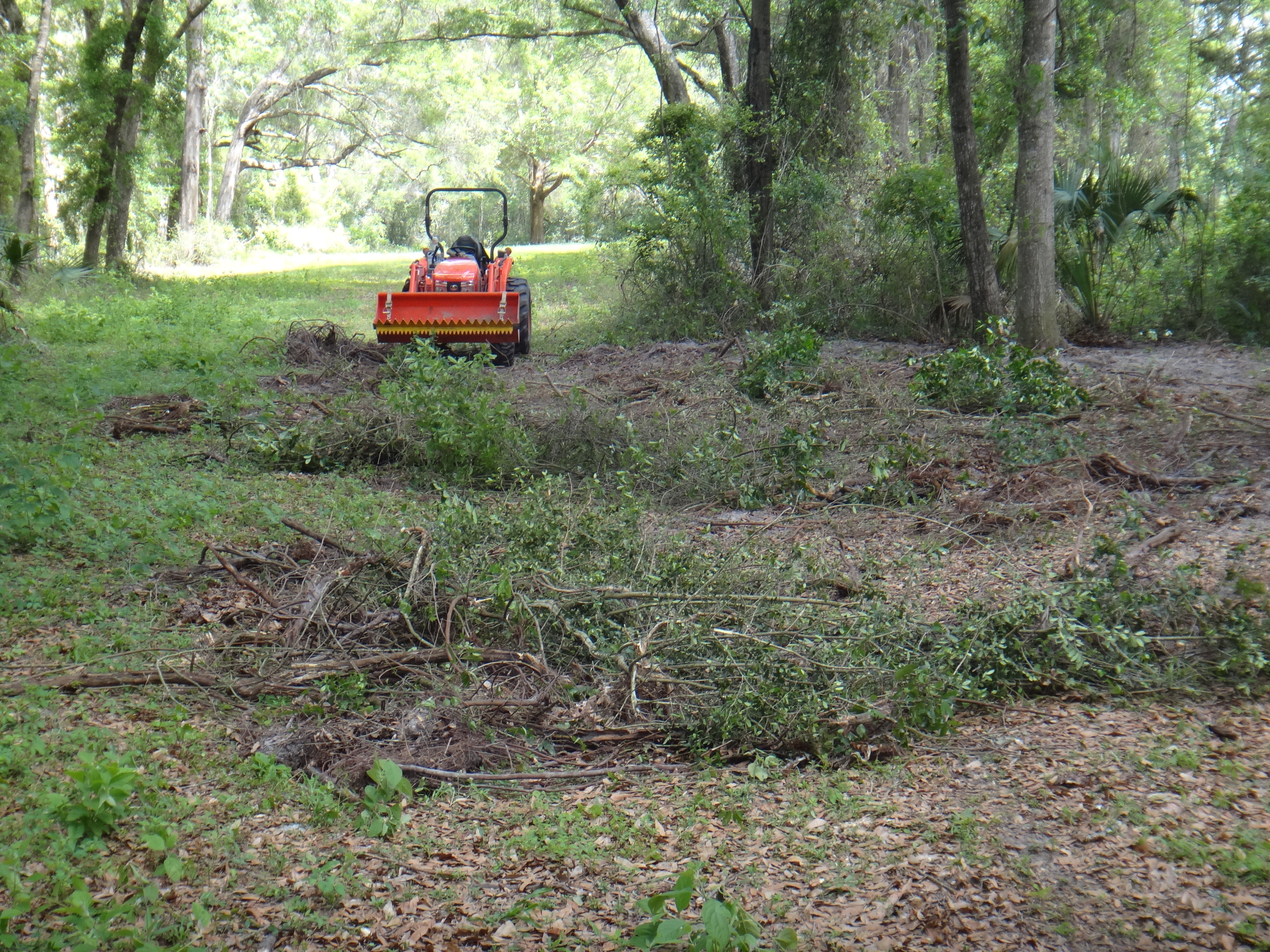

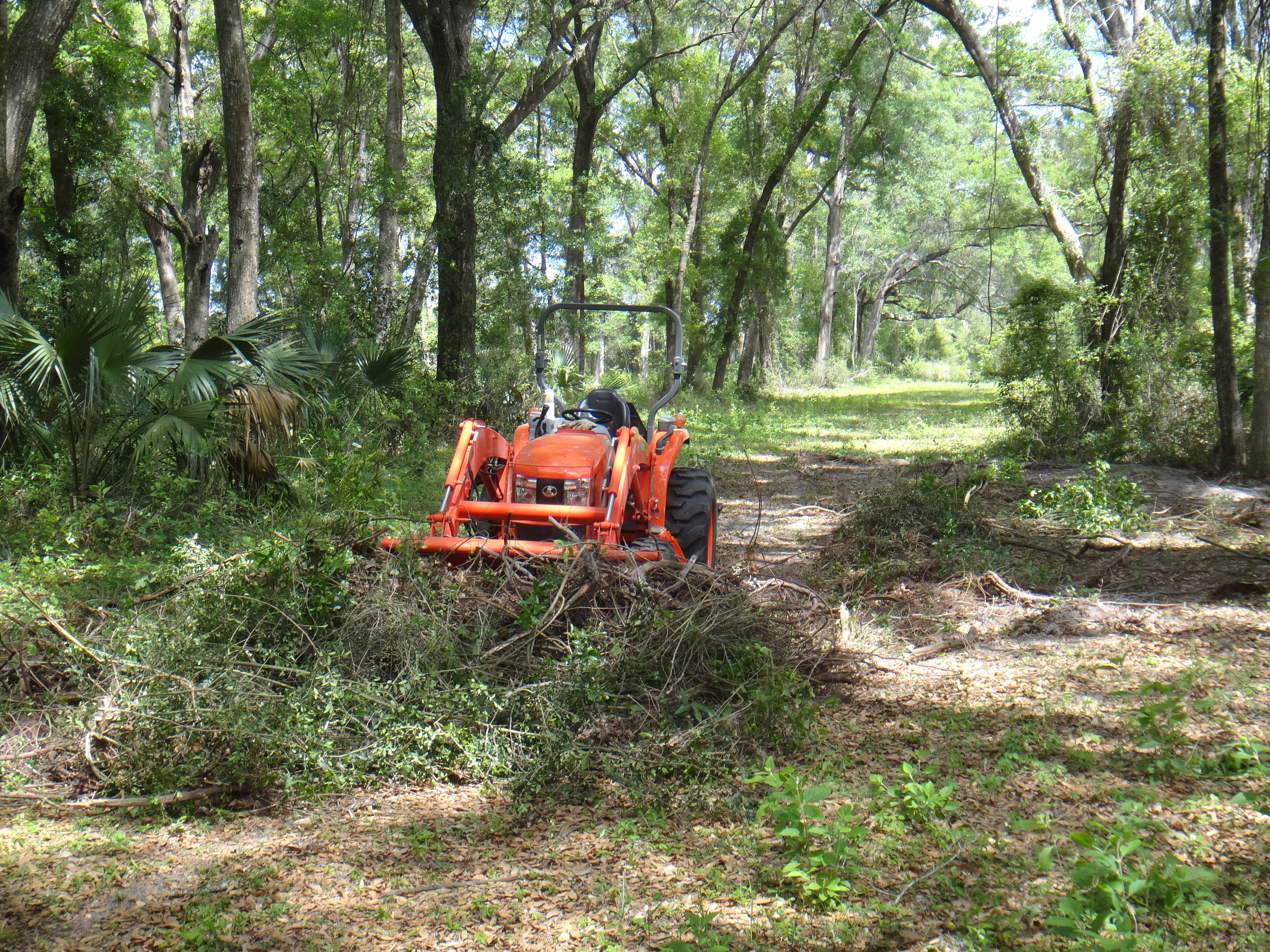

I have a Kubota L3560. Enough weight, very stable, great accoutrements. If $27,000 for tractor with HST and FEL seems like decent pricing, go ahead.
I am 69-1/2 years old. I owned bare bones tractors before age 58 years. With my increasing years the long list of comfort, productivity and especially Kubota's HST PLUS transmission options are well worth the money.
Most shoppers bridle at Grand L prices. I have never heard an experienced Grand L owner complain they paid too much.
SSQA was not standard when I purchased in 2013. I recommend the L2296 heavy-duty, round-back bucket, which is SSQA. Grand Ls can push, especially with a Ratchet Rake attachment on the L2296 bucket. Photos from yesterday.
Mid-PTO is optional.
