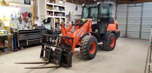

I had this little puppy on demo for a week, and no way would I trade it for any skidsteer with any special feature. Ended up that it was about two inches short to place pallets on my mezzanine, so I settled for this german Kabota.
