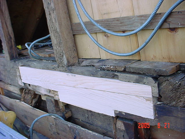

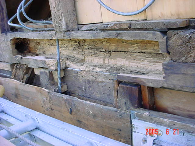

Well I really got into trouble on this old house project today. Now remember that this place was built around 1750. So it is no surprise that things will fall apart or even worse, rot away. Yesterday I started to peel the outside of the house apart to see how it was holding up. Well I found carpenter ants having a feast inside one of the beams. They are all dead now. Here are a few shots of my handiwork to repair that section. I chiseled out a 5.5" x 6.5" x 43 section inside the beam and made a new piece to replace the rotted out section. Fitting it in was the fun part. I still need to pin it in place. Fortunately this is not a load bearing section of the beam where it rotted out. Tomorrow the rest of the siding and boards get removed from this wall. I wonder what else I will find eaten away.

Here's the fixed picture. These beams are 8" x 8" and have plenty of meat on them to repair if not rotted too badly. I also replaced the vertical directly above the repair with a recycled piece of Chestnut from my barn project. It is not installed as of when this photo was taken. I did install around 8pm tonight.

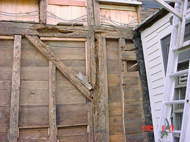

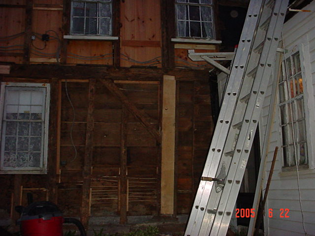

I haven't pulled the sill plate yet. maybe someday I'll get that far. So here is todays progree and more decay to fix. You'll love the crooked verticals in the picture. My daughter and I replaced this vertical beam today. I may straighten it out tomorrow. I'll have to cut into a wall to do it as the beam was exposed on the inside walls.

New post in today. The horizontal above this vertical is going to get some serious work done to it very soon. I need to remove about 4" of the width and put in a filler to repair the beam.

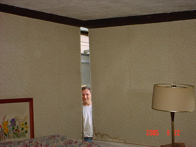

A view from the inside looking out. We didn't destroy the inside wall by jacking and removing this beam.
