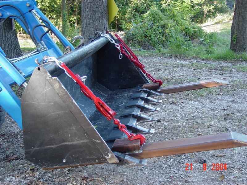

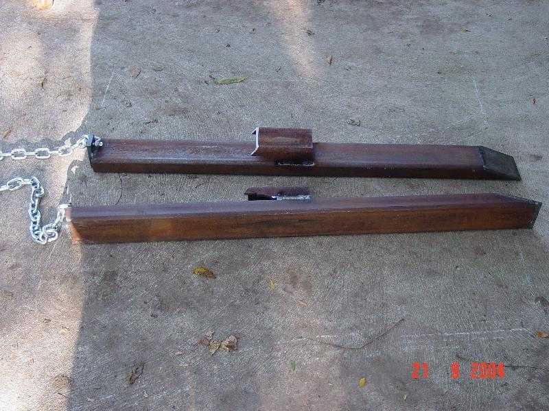

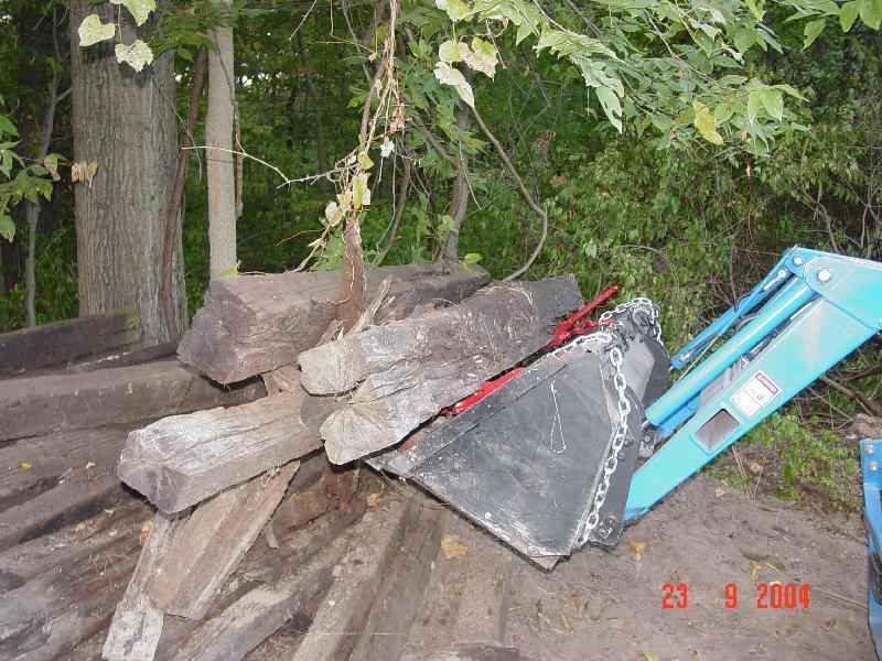

I built these short forks to move RR Ties and trees.

Here they are mounted!

, I spend a good bit of time reviewing the thead on forks yesterday and looking at all the pictures ... great info!!
Two quick questions on yours, what size tube did you use for them, and how far in front of the bucket do they go?
thanks, Andrew
   / Third Project(Pallet Forks)
Banjo ( hello Canada!) I used 2"x4" x 1/4" steel tubing with 1/4 stainless steel plate welded to the end, and I believe they are 30" long past the bucket. Here they are working!

Mansker,
They look real good and a nice advantage is that you can use them without having to take your toothbar off. With my clamp on forks, I have to take the toothbar off, and while that is a simple job, it still is a job to be done twice(once off, then back on) when I want to use my forks.

Thanks Henro! I got the idea from Jinman's forks but his looked a little too long for my purpose, I also am almost done with project 4 or 5 that I got from you on your FOPS ! TBN has sure helped me with good ideas and good people. Here they are painted to match!
