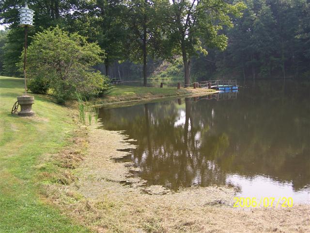

After several hours of running the string trimmer around my pond in 95+ degree weather yesterday, I awakened this morning not only with aches and pains, but with a vision in my head to build my own boom mower.
The plan;
Step 1 - Find a good running 21"+ push mower from a yard sale.
Step 2 - Remove the handles and/or misc. stuff not needed to push it around.
Step 3 - Hook up back-hoe to tractor.
Step 4 - Fabricate a bracket/mount to mower deck and fasten it to the back-hoe bucket or bucket mount.
Step 5 - Drive over to pond, extend back-hoe off to one side, start mower, adjust angle of cut using dipper arm/curl of bucket, then mow.
What do you guys think? Here's what I am needing to keep cut.

You might find it slower than by hand, if you have to place the stabilizers each set, but if not, why not? Would you want a way for the mower deck to "float" rather than have it rigidly attached to the bucket? If you had the hoe offset on the downhill side of the tractor, even on your gentle banking, would the tractor feel stable and steer straight? If the mower operates on a tilt all the time, you might want a 2-stroke to avoid oil starvation.

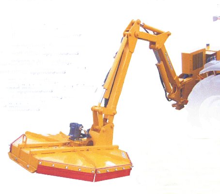

Allan those are very interesting pictures. I have a pond myself and have been pondering if there was an easier way to cut around it.
Maybe this will give you some food for thought on constructing the boom portion itself.
