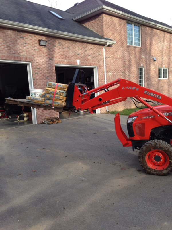

I agree you are looking at too small a tractor, but I don't think you need to go 40 HP big. Here is what a L3800 can do with 1000 pounds. image-3371286677.jpg I realize it is nearly 40 hp, but there are plenty of tractors that can match the lifting ability ( which isn't that great ) with way less HP. My tractor is only 32 hp and lifts 1800 pounds at the pins to full height.
