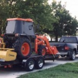

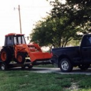

Getting too old to handle the ramps on my deckover, so I was considering a tilt, but there is too much overhang behind the axles for what I haul.
Then I saw a rollback and like the looks of it better: Heavy Equipment Haulers & Trailers for Sale in Texas | Kwik Load Trailers
Pictures from Google Image Search.
