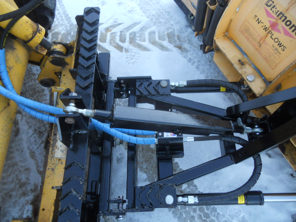

Here's one that I built. It's a little more complicated than it could be but I built in some lateral swivel so that the blade will follow the ground better on "un flat" areas. Building the ssqa part is simple and I have a very heavy SS and can get a lot of snow, plus the blade is 9'6". You want hydraulics and with a SS it's easy. Just use the factory cylinders for the plow. I added a crossover valve for hose protection when I hit something.
This shows the side tilt, it moves this far the other way as well.
That center link telescopes allowing for "float" or down pressure controlled by the "bucket curl". Built out of sq tubing and a new "butchered" cheap HF top link.
