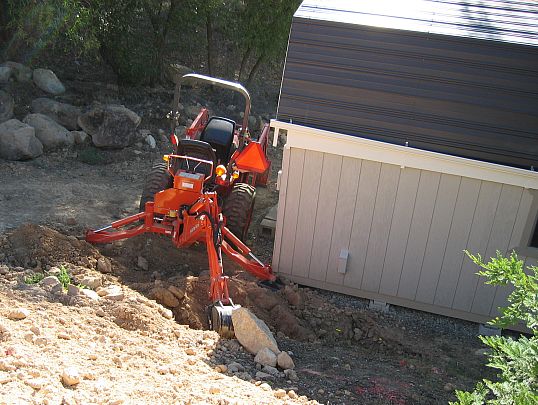

I have a B4672 backhoe on my 7610. I looked in the manual and this Kubota backhoe is also listed for application on your 7500. The backhoe kit requires some reinforced attachment points on the tractor. I don't know if that [the reinforcement kit] is part of the B4672. It was installed new on my tractor before delivery.
The backhoe digs well in the decomposed granite soil we have around here. I've also dug up some boulders that were too big to pick up with the bucket. I just scooped/scraped them out of the ground and rolled 'em out of the way.
I got a 12" bucket with mine. The smallest available from Kubota is a 10" bucket. Error on the small side unless you have soft soil. The smaller bucket puts more digging force across the smaller area--making it easier to break up the granite shale I enounter here.

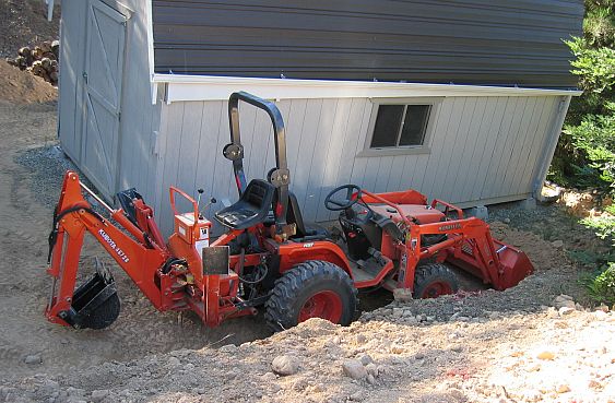

This is the Kubota taking out debris from the area dug out with the backhoe.

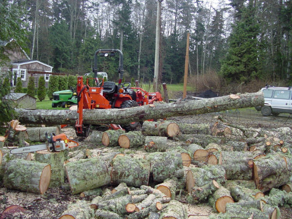

I take mine off and on a lot. My first time was about 5 minutes to take it off and about an hour to get it back on. Now I can drop it in 5 and have put it back on in 5, but if things aren't just right, it can take me 15. Probably an average of 10 minutes to put it back on. Not a big deal after some practice.
You've seen some pics of ditches. I use mine for firewood as well. Here's a pic of it with a good size log.
