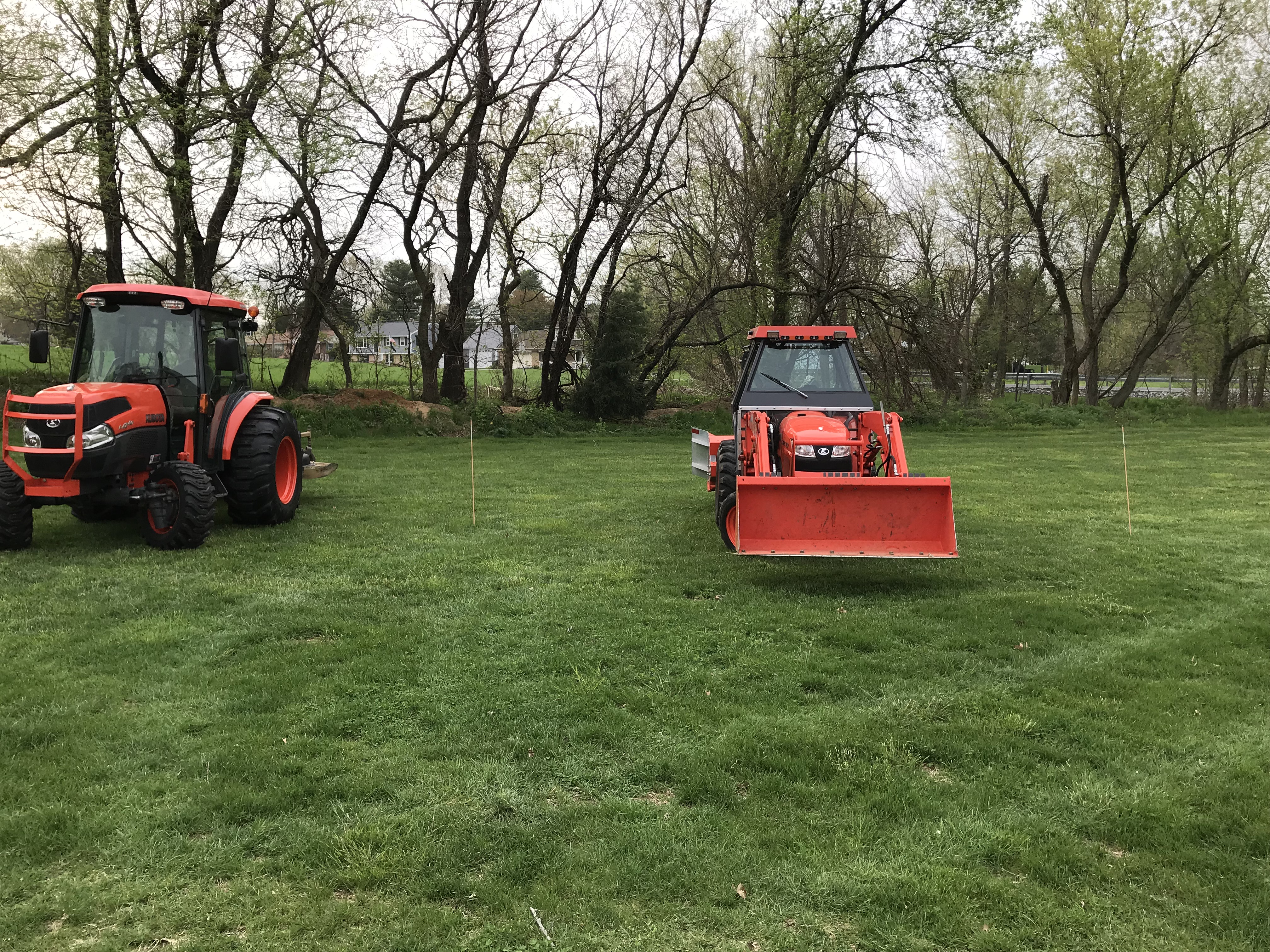

Most of my seat time is mowing. Maneuverability for me is primarily getting the RFM where it needs to be. I have posted the picture below in another thread. The L3200 and L4240 are shown having completed a 180 degree turn. I parked both tractors and stuck a driveway marker against each left rear tire. Then I drove each tractor in the tightest left turn they'd make. When I completed the 180 degree turn I measured from the driveway marker to the new location of the left rear tire. The measurement for the larger tractor was 27" less. There's one tree in an odd place here with a mulched area around it. I can now turn hard and mow around it in a circle without backing up or re-approaching it. When I complete the work on the wider deck, it may even get better. Or I'll start scalping off the high spots in the yard:)
As mentioned before, the marks at the lower right in front of the L3200 are the tracks left by the L3200. The less noticeable tracks between the tractors are from the L4240. That's how it looks in real life. It might also make difference that the rears on the L4240 are more toroidal in shape without the flat ground contact area the tires on the L3200 have and the B7500 had as well.
