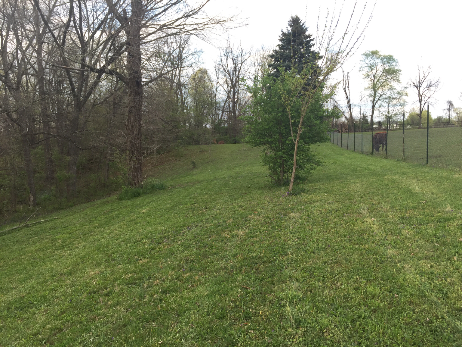

My property does have some fairly steep hills I mow which the 455 is stable on if I lean over the fender.

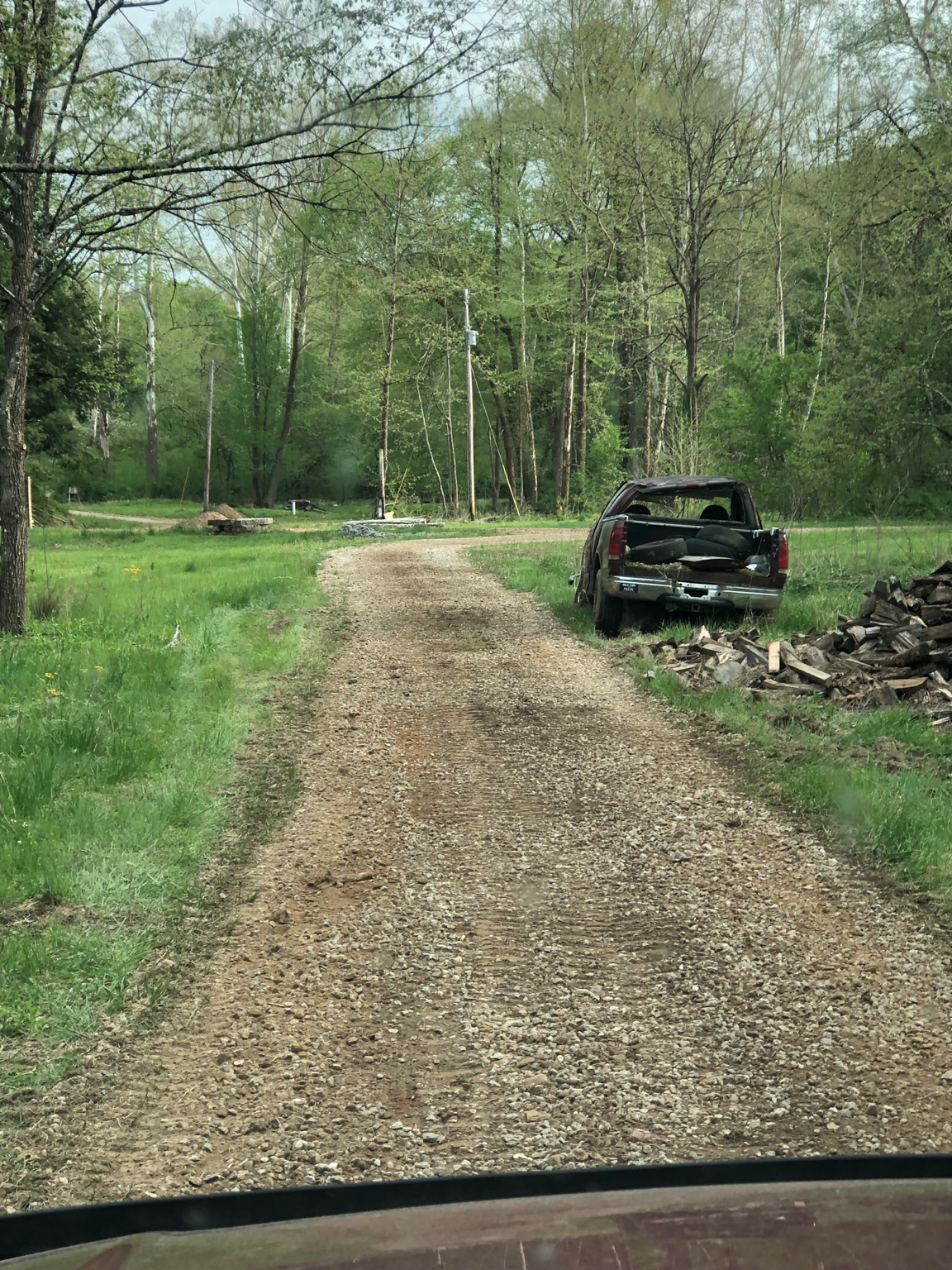

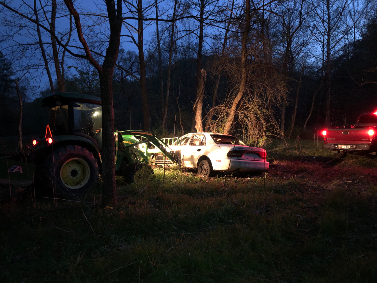

I would really like the auto connect MMM deck on the 2038R, I haven’t really seen the specs on the loader but would need it to lift around 800lbs. My 4320 lifts 1750lbs to fill height, I have maxed it out just this year but that was from lifting a car and a truck that was wrecked out of the mud and moving hay equipment I was selling. IMG_2866.JPGIMG_2875.JPG
Those are loaded up and were scrapped.

The hills on my property limit me to tractor size, I fear a 3 family tractor would be too unstable to comfortably mow with regularly. I would prob mow with my 4320 if the hills weren’t so bad with either a belly mower or rear finish mower. I’m not mowing big steep hills, they are small but are steep enough to upset a tractor.
