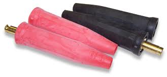

To make quick wiring connections I use the same type you find on welding leads. I have a set wired to each of the batteries mounted on the trailers & have a pair of jumper cables with these connectors on one end.

Oliver, nice idea on the welding lugs.
