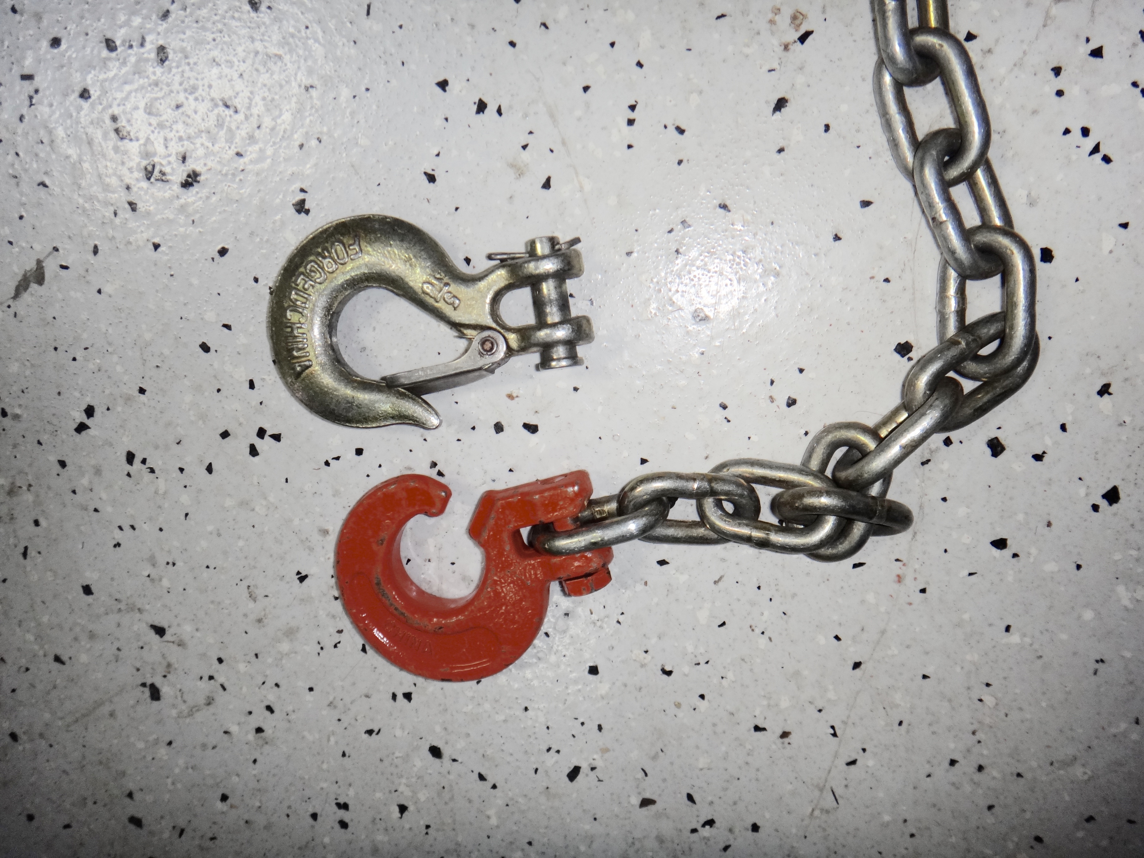

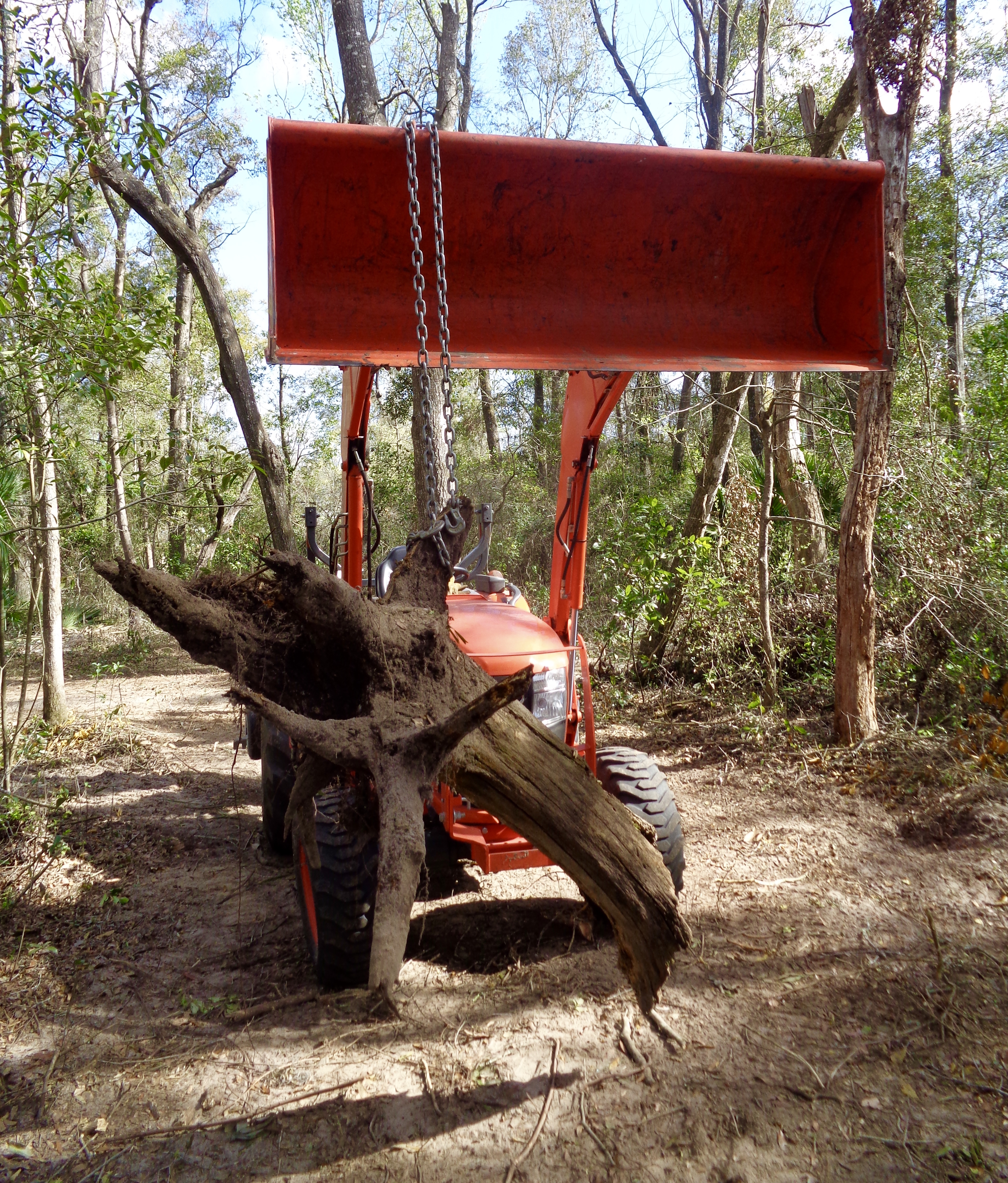

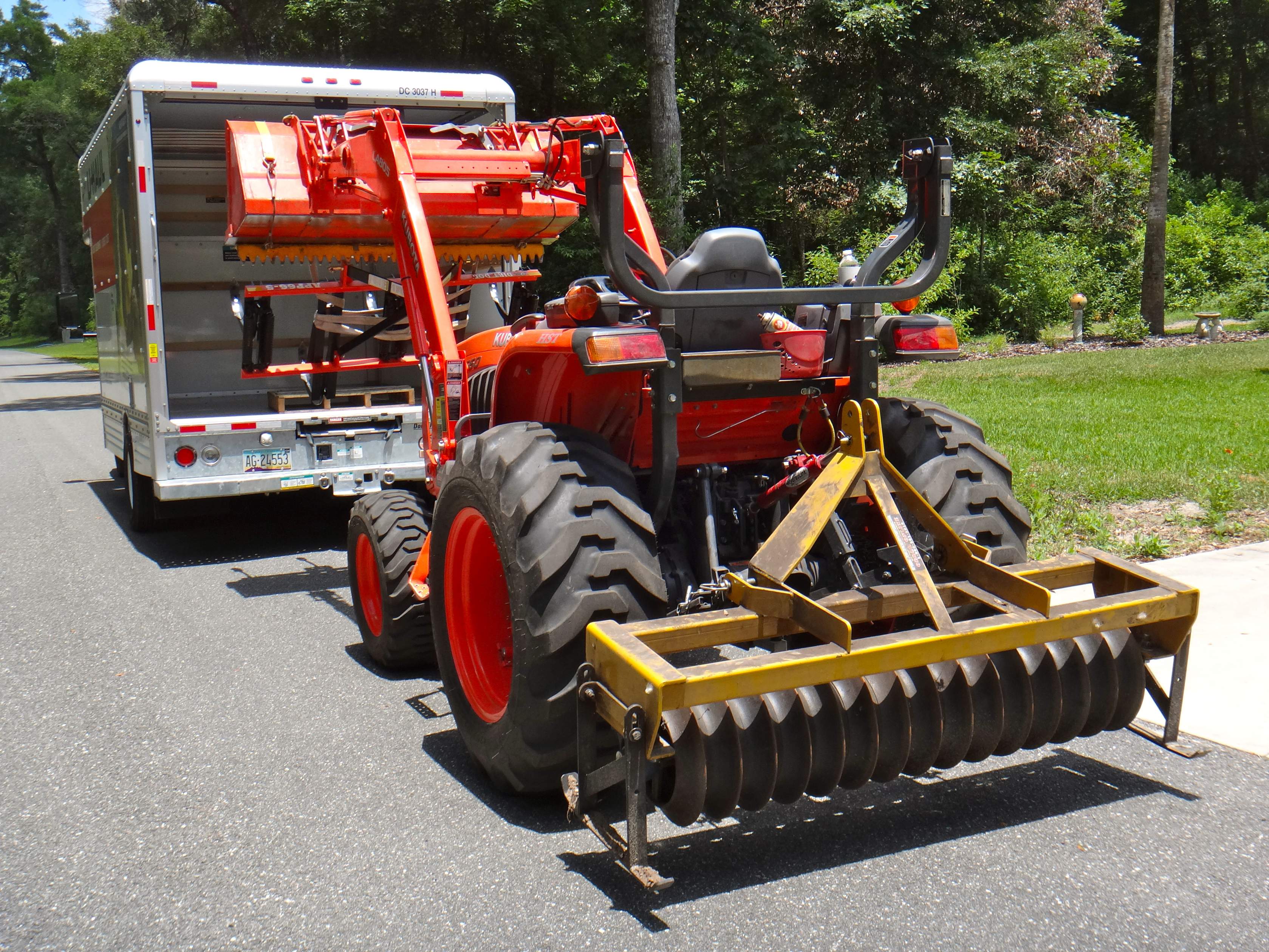

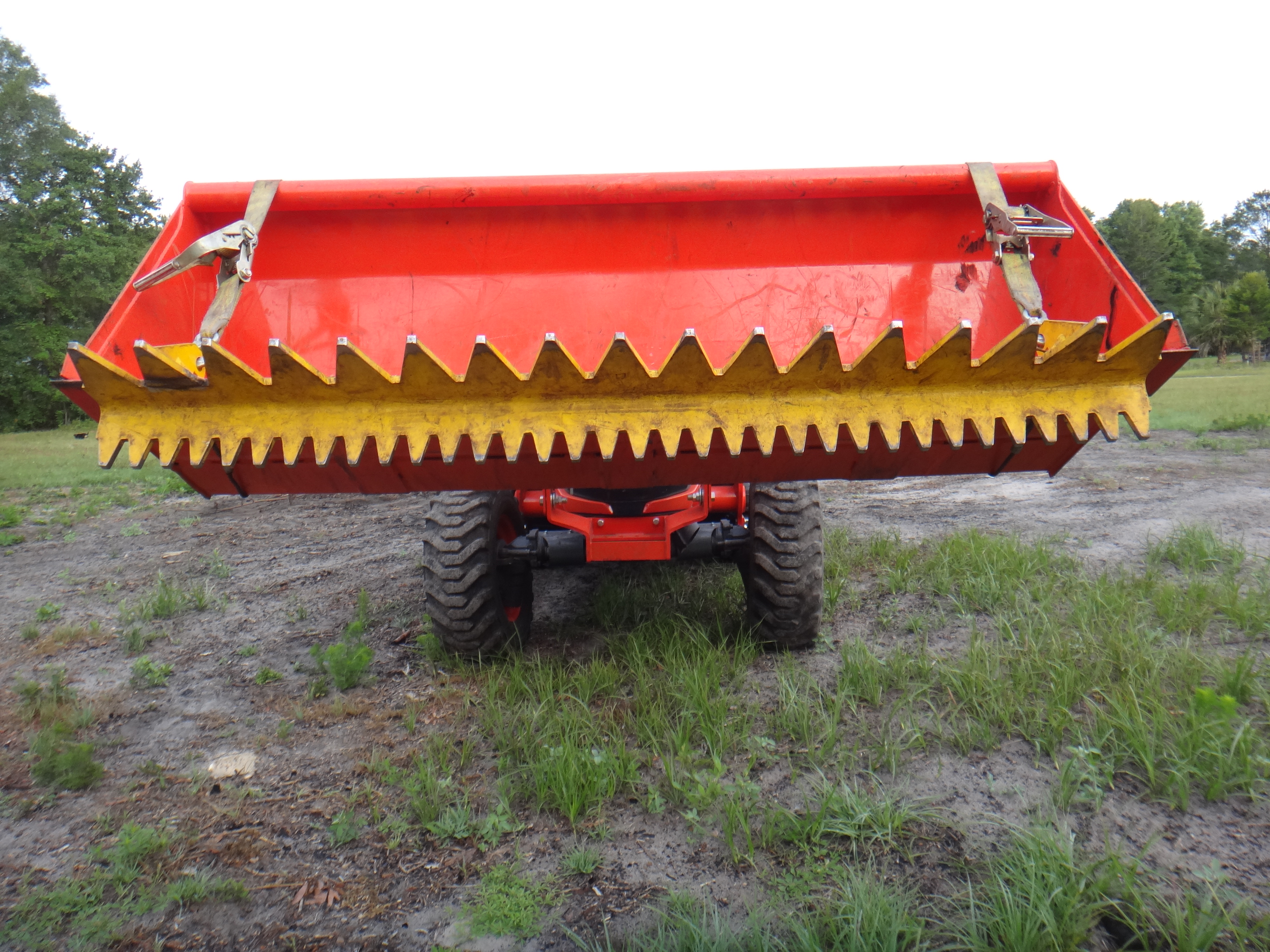

Take delivery of 60" wicked grapple and toothbar I have no way to off load delivery truck 400+ lbs
Two bucket hooks on the FEL to unload trucks. Hooks install inline with the lift arms. Photo: 300 pound Dirt Dog APP being unloaded with 5/16" chain grab hooks and chain. Counterbalance 600 pound Cultipacker. Air in rear tires.
You can LIFT to FEL capacity with chain hooks but do not allow yourself to PULL heavy loads over dirt in reverse. Connect/pull heavy loads at the rear/center drawbar.
I transport vertical railroad ties with bucket hooks regularly.
I have installed Ken's Hooks on both my new Kubotas with complete satisfaction. I also like Ken's Grade 70 forestry hooks for one end of each 5/16" Grade 70 chain. Ken's hooks are industrial art.
LINK: Ken's Bolt on Grab Hooks <<Kubota Hooks>>

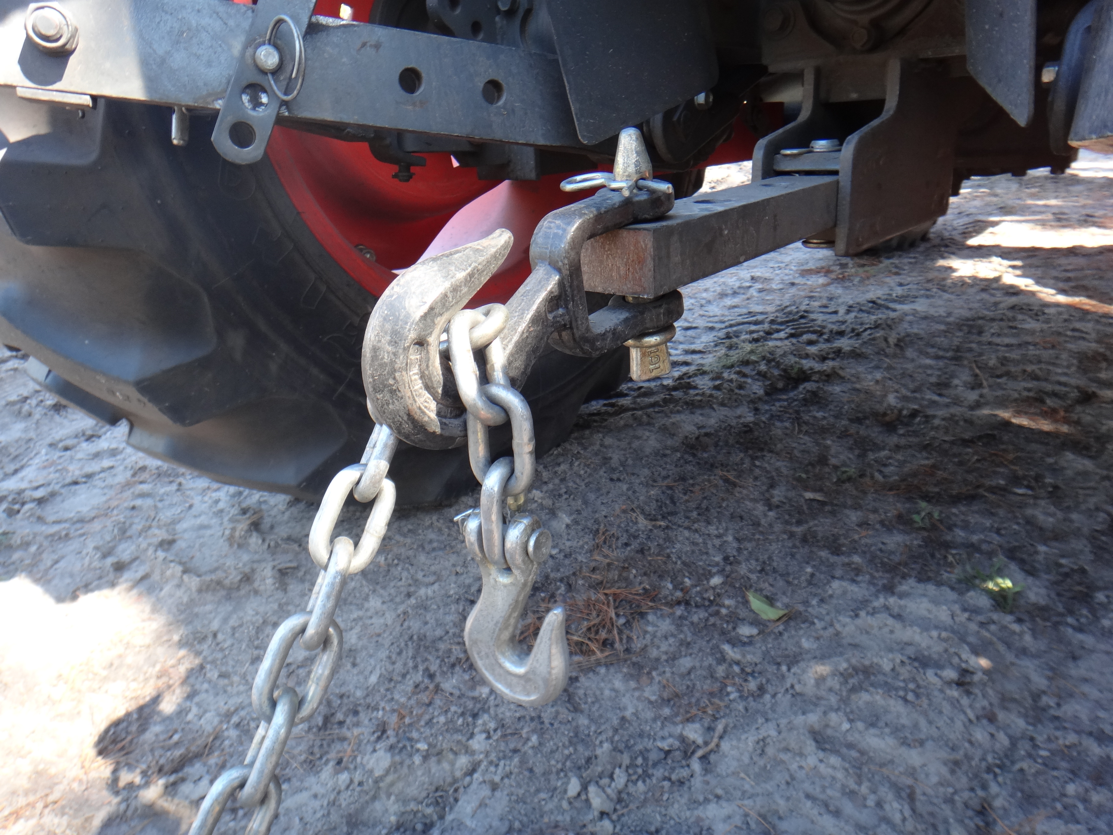

Clevis chain grab hook from TSC or Rural King for rear/center drawbar. $20. Install with hairpin clip up, or you will lose it. I keep thinking I should replace hairpin clip with a hefty cotter pin.......

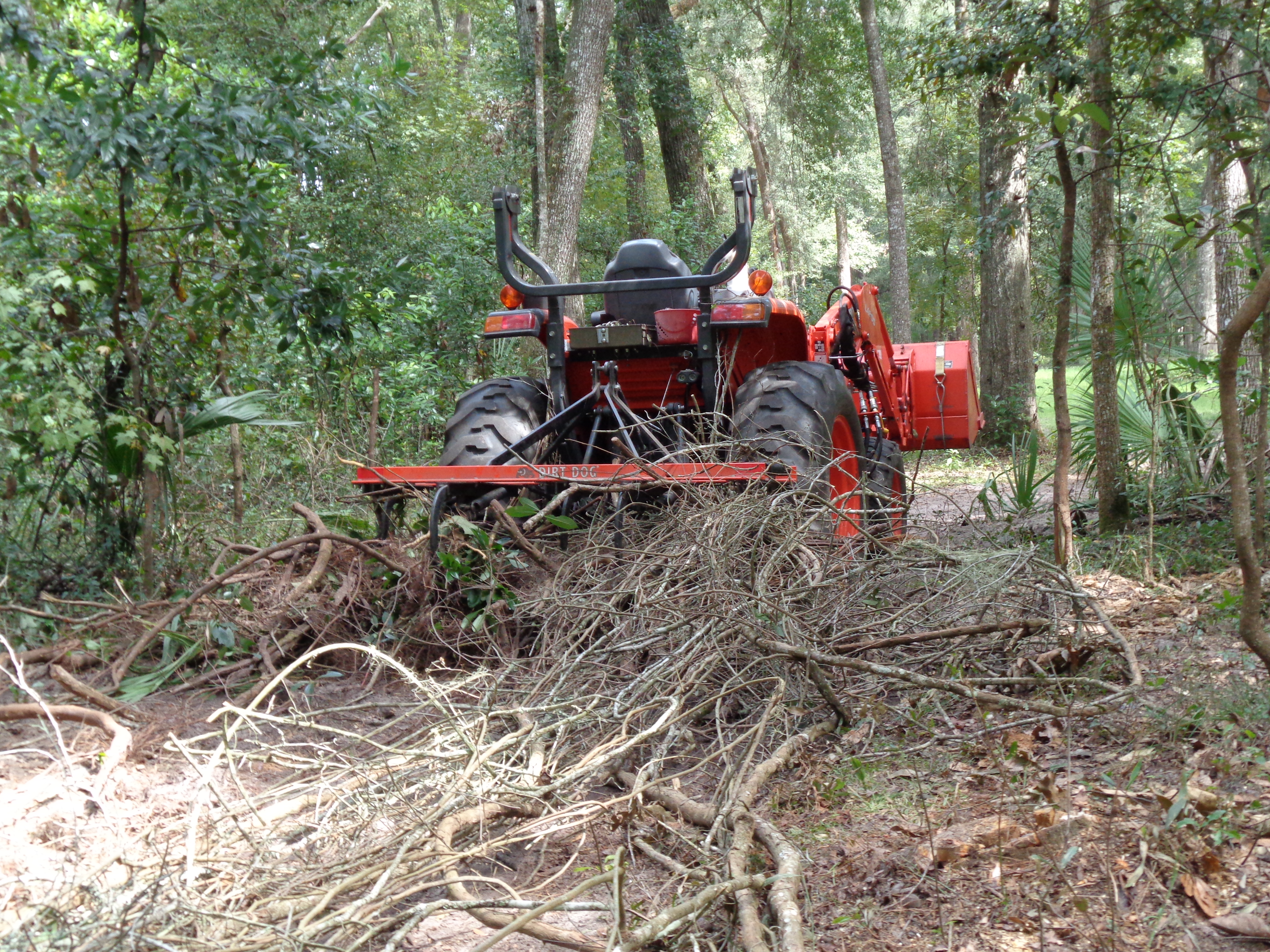

I cannot imagine why you would need both a sharp bolt on bucket edge and a toothbar.
Enlighten me.
If you will be tearing out brush and vines a Ratchet Rake is better. I pulled a couple tons of grape vines and wild climbing rose out of Oaks today. I used SSQA pallet forks for debris transport to the burn pit. Often I rake out roots and corms with my Field Cultivator then tow to the burn pit.
