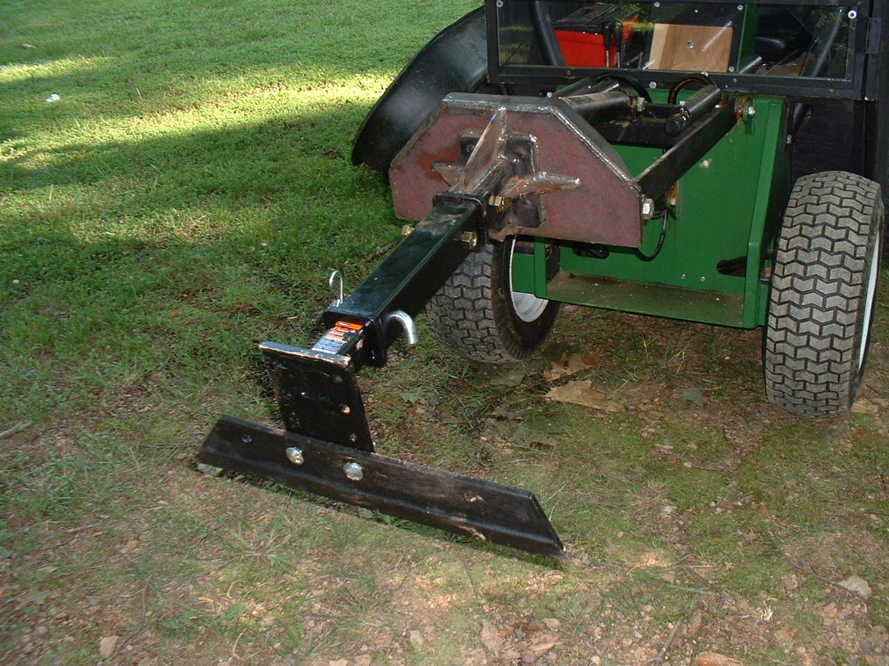

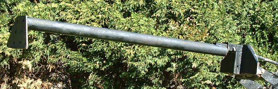

The steel box with a load of gravel will probably collapse when pulled out, unless it has a strong frame.
I would build a large "hoe style" implement to fit the loader or 3-point and use it to drag the gravel off the truck.

Go ahead and line the bed of the dump truck with the sheet metal. Build yourself a "hoe style" attachment like bcp suggests. This "hoe" does not have to be pretty. Most anything will be easier than shoveling it off by hand. Plywood sides on the dump truck. The gravel will slip easily on the sheet metal. The sheet metal will protect the truck bed.
I would forget about any type of arrangement where you slip/pull something off the bed of the truck. The weight of the gravel load will surely damage the sliding bed.
