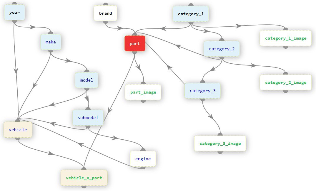

Found it on the other forum, hope will be helpful for someone. A good auto parts catalog data, free of charge, for all the models of vehicle imaginable. Great source of info
