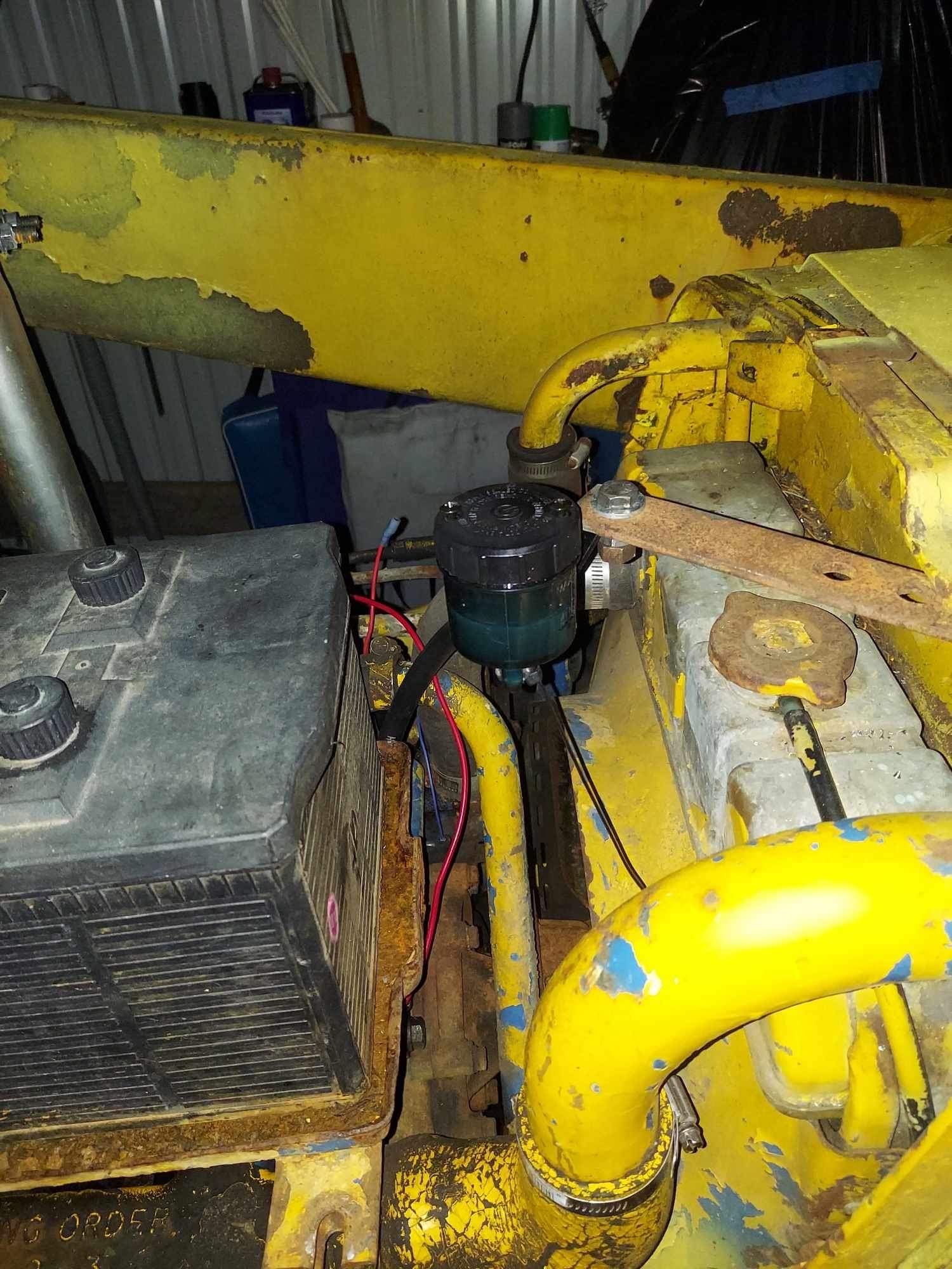

This is how I decided to add Thermostart opinions appreciated, motorcycle front brake cylinder. Discovered I needed to take the top off for it to work no vent and it took about 2 to 3 minutes for the intake manifold to get warm. Does that sound right? IMG_1484.jpeg
   / Thermostart hack #2
It should be less than a minute to heat up. Did it do that once or have you tried more than once? Probably needed to prime the line
   / Thermostart hack
Just tried it once thanks. tried it again. I don’t think it’s working right it gets a little warm but I don’t think the torch is lighting.
