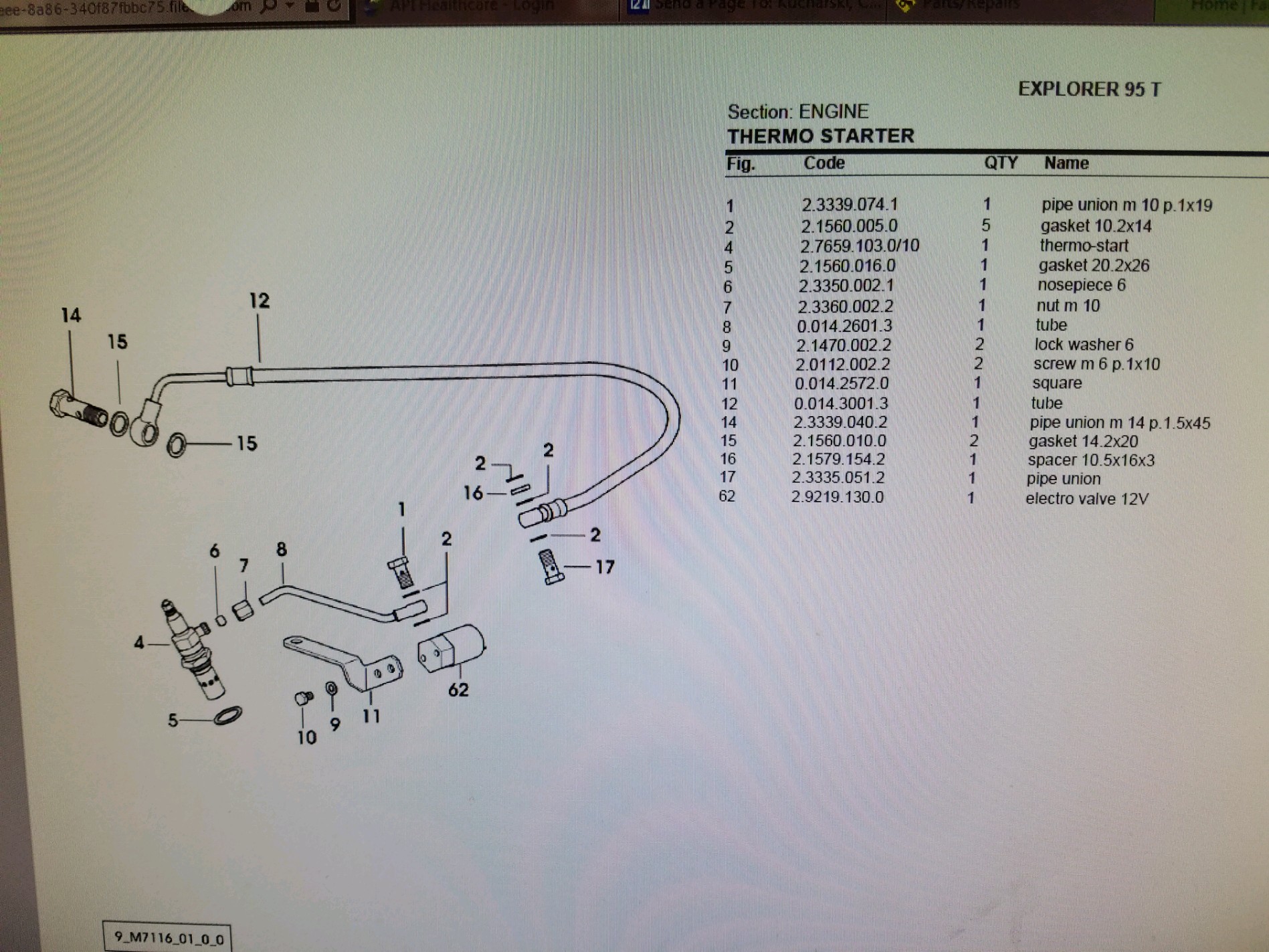

I was just thinking a picture of the set-up would really help. I replaced the thermo-start last night and since I had the parts on the hand I finally changed out the fuel filter and pre-filter. I tried it out this morning (32F outside) and it still seemed like nothing has changed but it did start. There is only 1 wire coming off the thermo-start and 1 pipe for the fuel. The pipe that connects to the thermo-start goes down to a solenoid and this only has 1 wire coming from it. I assume this controls the fuel flow to the thermo-start and maybe its bad and not activating? The wires from both the solenoid and thermo-start go back to an ECU near the dash from what the manual shows. I will try and get some photos to post tonight of the engine and the manual layout.

This is the layout from the parts manual of how it all looks. I replaced #4 and am thinking #62 may be the next culprit?...
Did you look for fuel delivery when you replaced the igniter#4?
If you remove the line going to it when you activate the system you should have a steady drip or small flow of fuel to the igniter if not no fire no heat no start.

So I finally used the Ohm meter to test the thermo-starts. I tested the old one, the new one that's installed on the tractor and also the one I have installed on my SAME (working one). I got nothing from the old and new thermo-start :( . I compared my results to the working thermo-start I have in the other tractor as well so I know everything was working as should and that I was testing it correctly. Looks like I'll be calling the dealer today to figure out return shipping and a possible replacement...
/ thermo-start issues #19
Im reading this as a smoking gun verified....new unit bad. When you get one that tests ok after you install it and hook it up to the tractor's fuel and power source, remove the input hose from the air filter and have somebody activate it (and keep it activated) while you look into the manifold and watch it function. The wire will glow red-orange for a bit, may take a minute, but should be working in about 30 seconds time line, and after it has been glowing solid for 30 seconds or so, diesel should start dripping down on the coil and as it hits the coil it ignites and the glowing balls fall to the bottom of the intake manifold. If you see that, you are good to go. Once you start rolling the engine the intake stroke will suck them into the combustion chamber.

Ok, so i got an update. I received the new thermo start the other day and its a working unit. I installed it last night and itll heat up when directly connected to the battery but it will not heat up with when i turn the key on to the heat up position. Power is going to the thermo start when the heat up light is on and power cuts off when the heat up light goes out (about 30 secs). Any ideas anyone?
