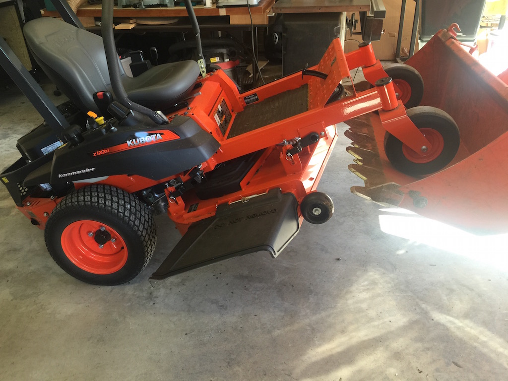

Well I took mower deck completely off. I was looking for install pics but only found one pic where I was going to try and do the install by just jacking it up without removing and quickly realized that would be too difficult as I couldn't get to the topside for some of the mounting bolts. Pic no real help but since I found it...
I honestly don't remember many details, it was pretty straight forward install once deck removed. I think the only thing I struggled with was reattaching the belt tensioning spring at the end. Good luck... I know your wife will love it.
