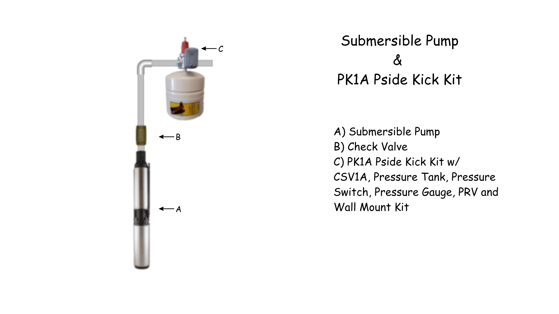

Many rural farms and ranches get water from the ground. These people know the importance of a good well with a plentiful supply of water and good equipment. Our good equipment went to hell this year. In the spring our poly holding tank 4200 gal split hear the bottom and had to be replaced after 25 yrs.
This week the pump motor died. Not a shock after 25 yrs of service, But what followed was.
My pump service guy showed up and began pulling 400 ft of stem to retrieve the pump. After pulling 150' the rig groaned to a stop. The pipe would freefall 1 foot and come up a ft only to stop the crane again and again. We speculated knowing the full depth and type of broken rock the hole was in that it could be a crushed liner, possible earthquake damage, or similar...We decided a camera should be sent down to see what the problem was. Camera guy was not encouraging...saying he was unsure he could get his camera down 250' without getting caught up on the pipe and wire and that if it looked to scary for him he would pull out and charge the full $900 fee. 😖
On to plan B. Called the driller. His records were good. We talked about the ground structure and the equipment installed. He sent me geographical records by the ft. and we discussed My options to which his parting words were GL.
We called in a big crane to roll the dice and see it we could get the pump lose or snap it off the stem or simply break the stem. Not good prospects as some of those results could result in the Well hole becoming unusable.
With the big 40T crane set up and connected...we gave the signal for a gentle pull, all held our breath. I heard the engine load and saw the boom take some weight and I thought oh no. Then pop up came a ft of pipe... and then more. 50' more at normal lifting load and we were presented wit a giant ball of pull rope (200') wadded up on the midpoint check valve with obvious abrasion signs.
Seems the original pump installer failed to secure the line to the cap and again failed to tape it to the pipe in a proper manner at the proper intervals. Frustrating but what relief after worrying about everything else that could have gone wrong.
New pump, new motor, new wire, new rope securely taped to the stem every 20', new control box and we are enjoying a drink of water that will hopefully that will last me my lifetime. :)
