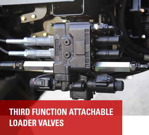

Surfing on the web I collected a bunch of informations about this factory mounted Tym T474 valve.
First, it is designed by an italian company walvoil
(hope I did not mistake about the nationality of this firm !)
You will see the valve (the SDM 104 model) on their website, including its third function actuator):
Walvoil - SDM14 - Walvoil S.p.A.
Looking at the following two pictures, you will see that the valves are the same :
The Walvoil model :
The Tym factory model :

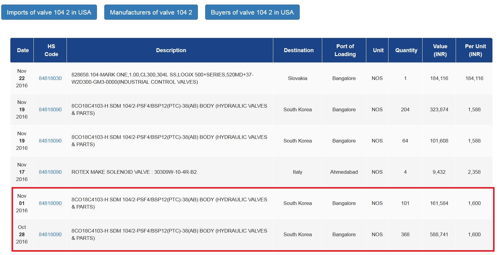

But, what is much more interesting, is that I have found where these valves are built :
In Bangalore (India) as you can see on this indian customs export form :
The price paid by TYM in 2016 for one unit is : 1600 indian rupies which make .........22 $
If I don't mistake, I read on the forum that the cost for (only !) the third function option, and not the complete valve, is around 1000 $.
Of course, there is the cost of labour, taxes, piping ect ...but ........it makes a huge difference....
Guess that if you have a Walvoil dealer in US it may be cheaper to buy the third function actuator from them !
Phil

Ya know, they call that a "Third function" but it looks to me like simply a diverter valve attached directly to the loader valve. I bought a diverter valve from Ken and installed it myself. Works perfectly. It's just not mounted directly to the loader valve. I've mounted mine onto the loader arm. Much less than $1,000! Greg
   / The true price of factory mounted Tym T474 valve #6
That TYM setup, is not a diverter valve. It's a true third function valve that is part of the main loader valve.
You clearly see both solenoids on the picture, one for extend and the other to retract.
Yes Pedro,
You are right. That's why IMHO those kind of valves are way more interesting than a simple diverter.
Phil
   / The true price of factory mounted Tym T474 valve #8
My mistake. Thanks for correcting me ptsg. I've never seen a third function valve, saw the solenoid and jumped to a conclusion. My bad. Anyways my diverter valve works just fine for me at a far less cost. Greg
   / The true price of factory mounted Tym T474 valve #9
Im with Greg i think it is way over priced for what you get if its a true 3rd function or not.
   / The true price of factory mounted Tym T474 valve #10
Thanks for the agreement Walter L, It looks simply like an attached diverter valve to me and sounds as if you need to press a switch to make it work; just like I do with my much cheaper valve! I cannot see much difference except the cost.
