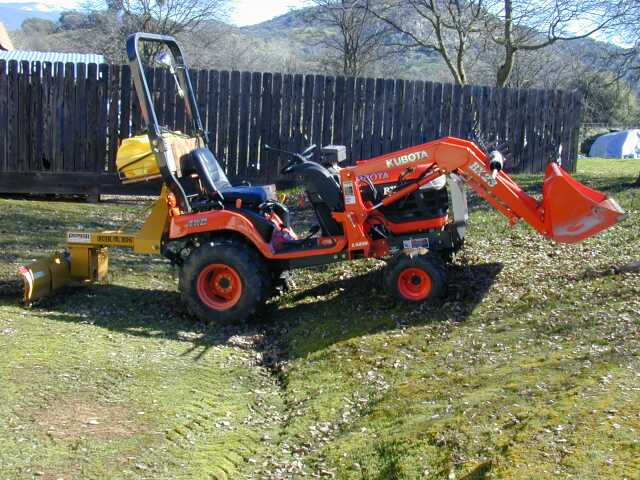

Now I will consider the "wedge factor" ... wedged the back blade 4" into the gumbo ... bummer ! Make a note Danno.

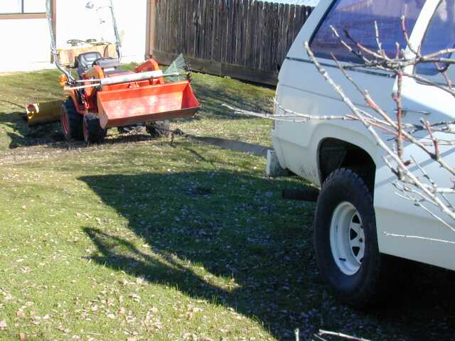

A new theorem: Don't buy a tractor bigger than the biggest machine you have onsite. The situation didn't look like much but the baby tractor sure failed to proceed or reced so ... a gallon of gas down the 4 barrel and out she comes.

I have been there twice with my Box Scraper (different spots). Both times were about 15 minutes before I had to leave for work. The BX got out on its own but a 4'x4' chunk of sod was removed each time.
