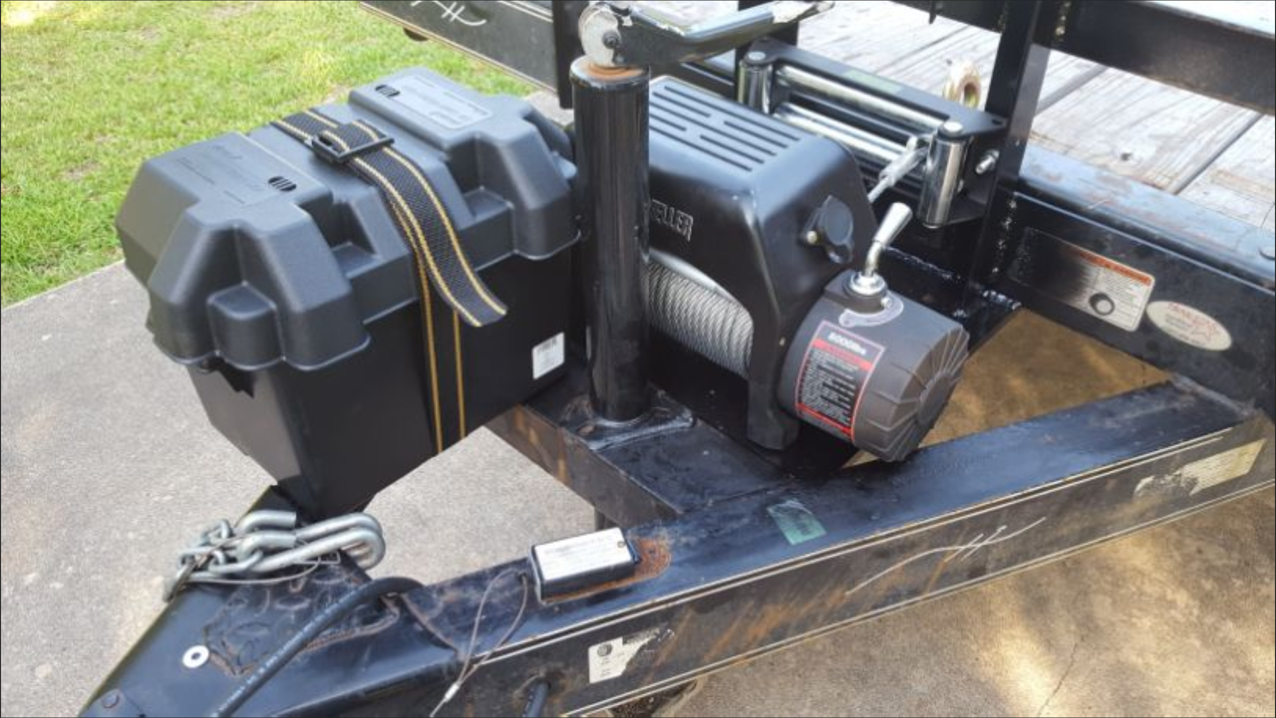

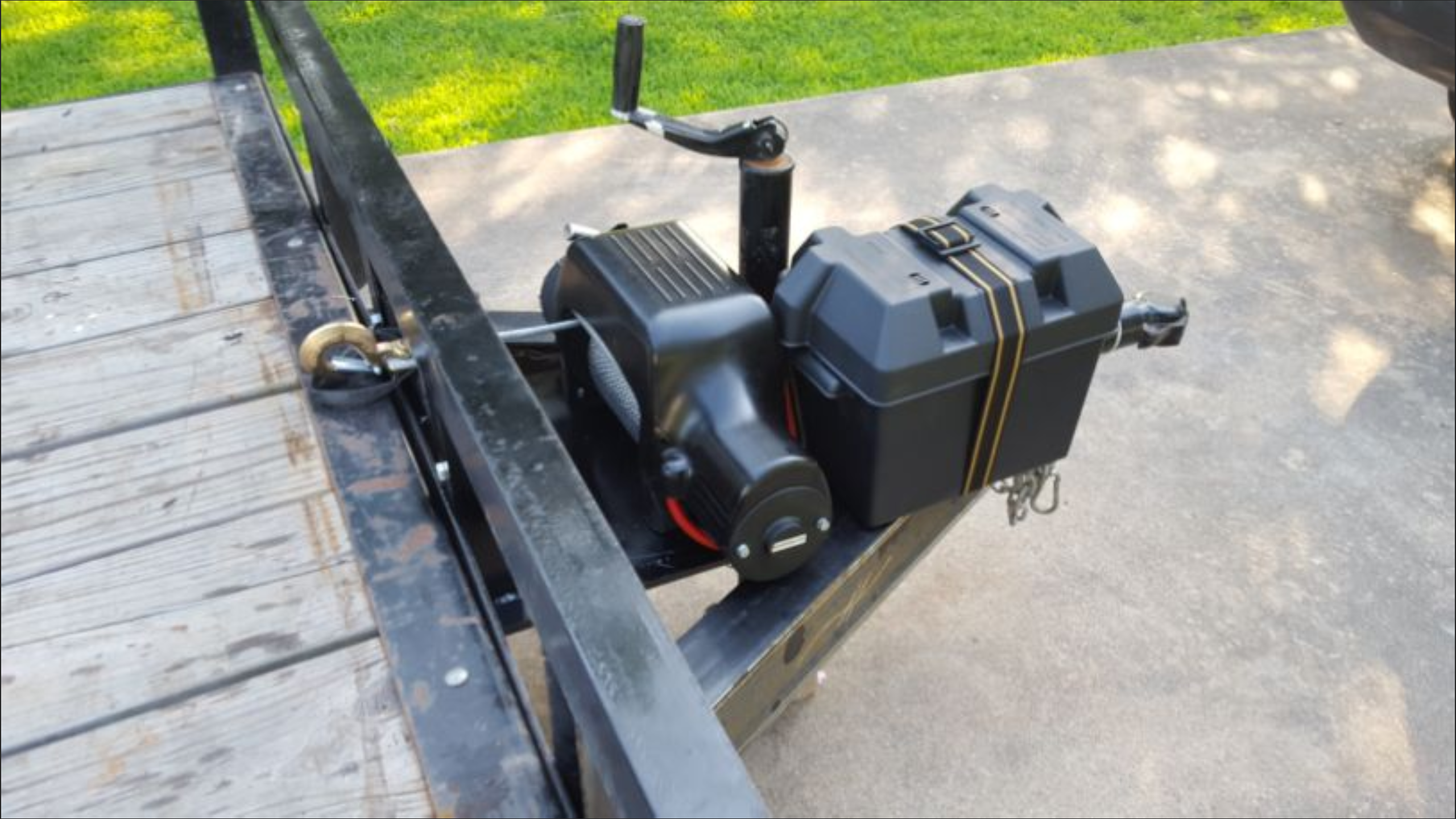

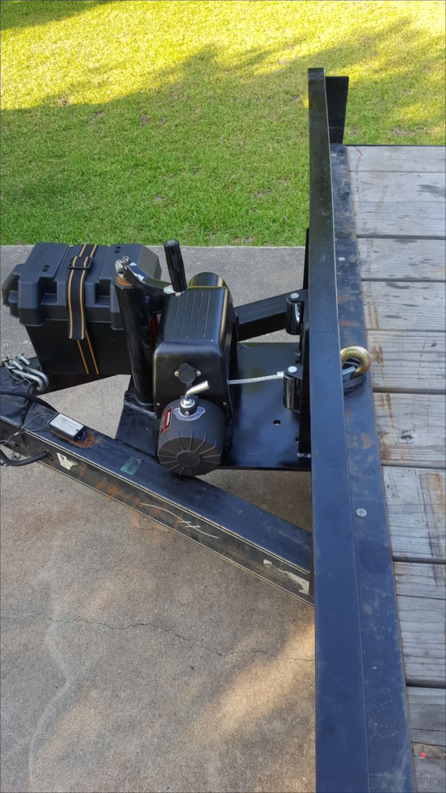

Not a repair, but a modification. I welded a plate to the tongue and mounted a winch.

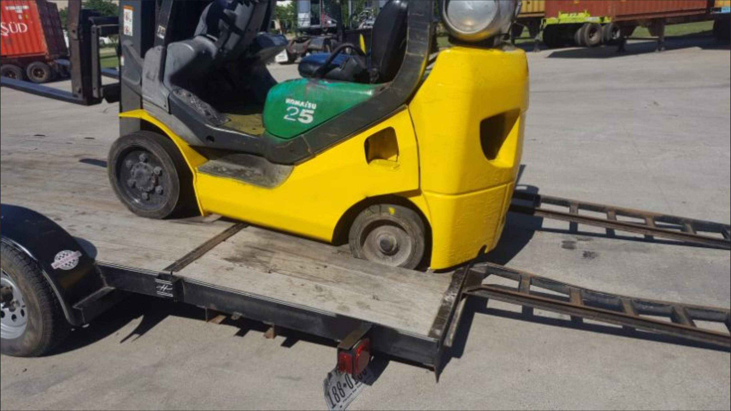

And while I'm at it, I'm going to cut off those weak pieces of angle that they stitch welded to the back for the ramps to lick into, and I'm going to replace them with a single piece of angle twice as thick, continuously welded from both sides, all the way across the back. And fabricate some sturdier ramps. That forklift mangled my ramps and half way ripped off the barely welded pieces of angle.
...before you say it, Yes, I know I had no business putting that forklift on that trailer. What's done is done, lessons were learned, thankfully no irreparable damage was done.
View attachment 573682View attachment 573683View attachment 573684

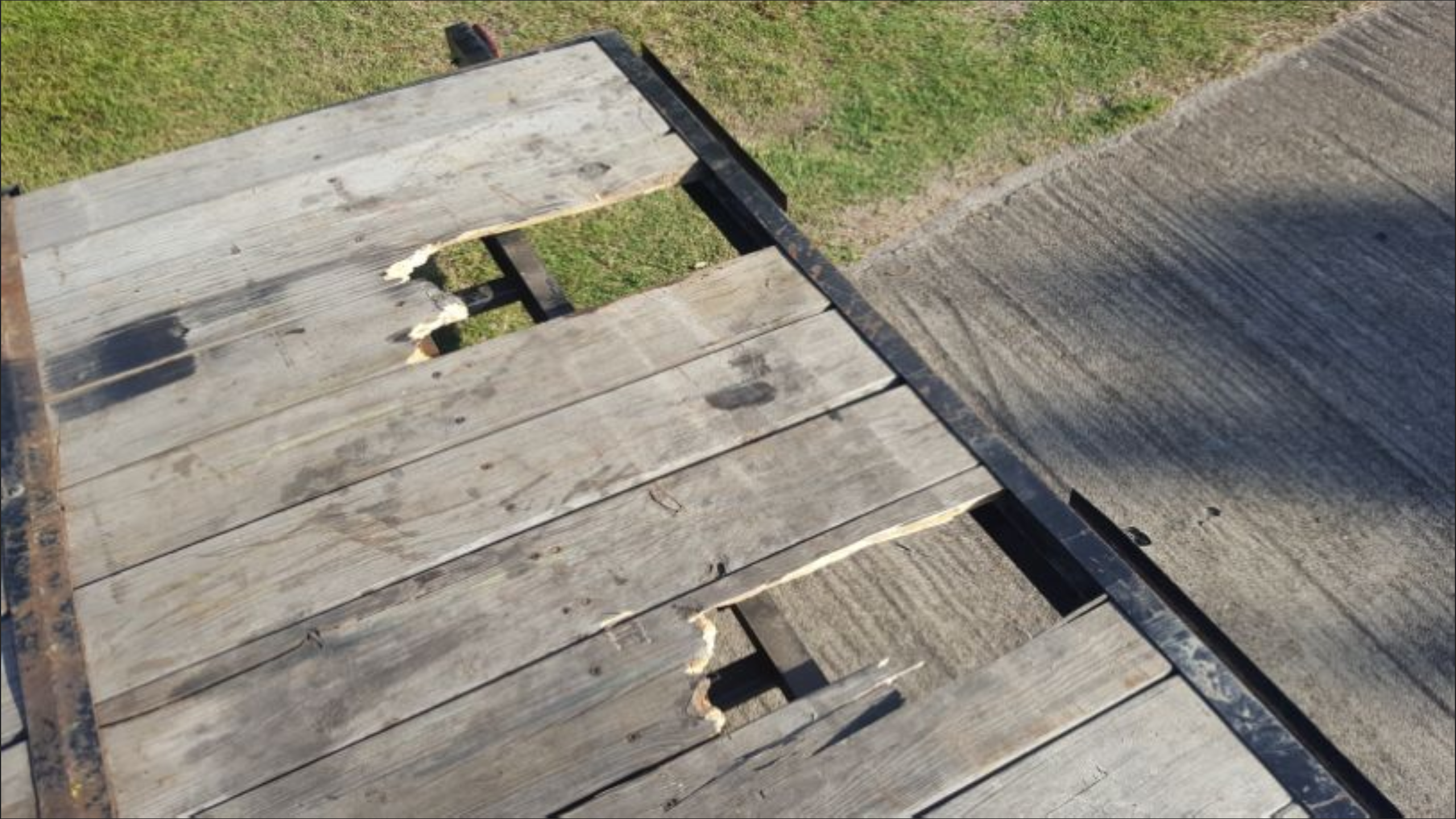

I would not get the diamond plate. It won't be as strong as wood, unless it is really thick. Speaking from experience with heavy equipment, that steel will get slick with a drop or two of rain or morning dew. I've seen more than one dozer and at least one tractor go sliding off when moist. Wood offers the best traction.
I am just wondering how you got that slick tired lift up there with those ramps. I've never gotten that much traction. The ramps can be straightened. Just flip them over and run back over them.
While the lift is probably overweight for the trailer, I've put a tractor wheel or two through boards like that myself and it wasn't overweight. What you need is an extra cross member AND Rough Sawn Oak at least 3 inches thick. That will fix your problem. The pine, which is likely pressure treated is not that strong. Replace it with rough sawn oak and it will last for years and will be much stronger and won't dry rot as fast or become brittle.

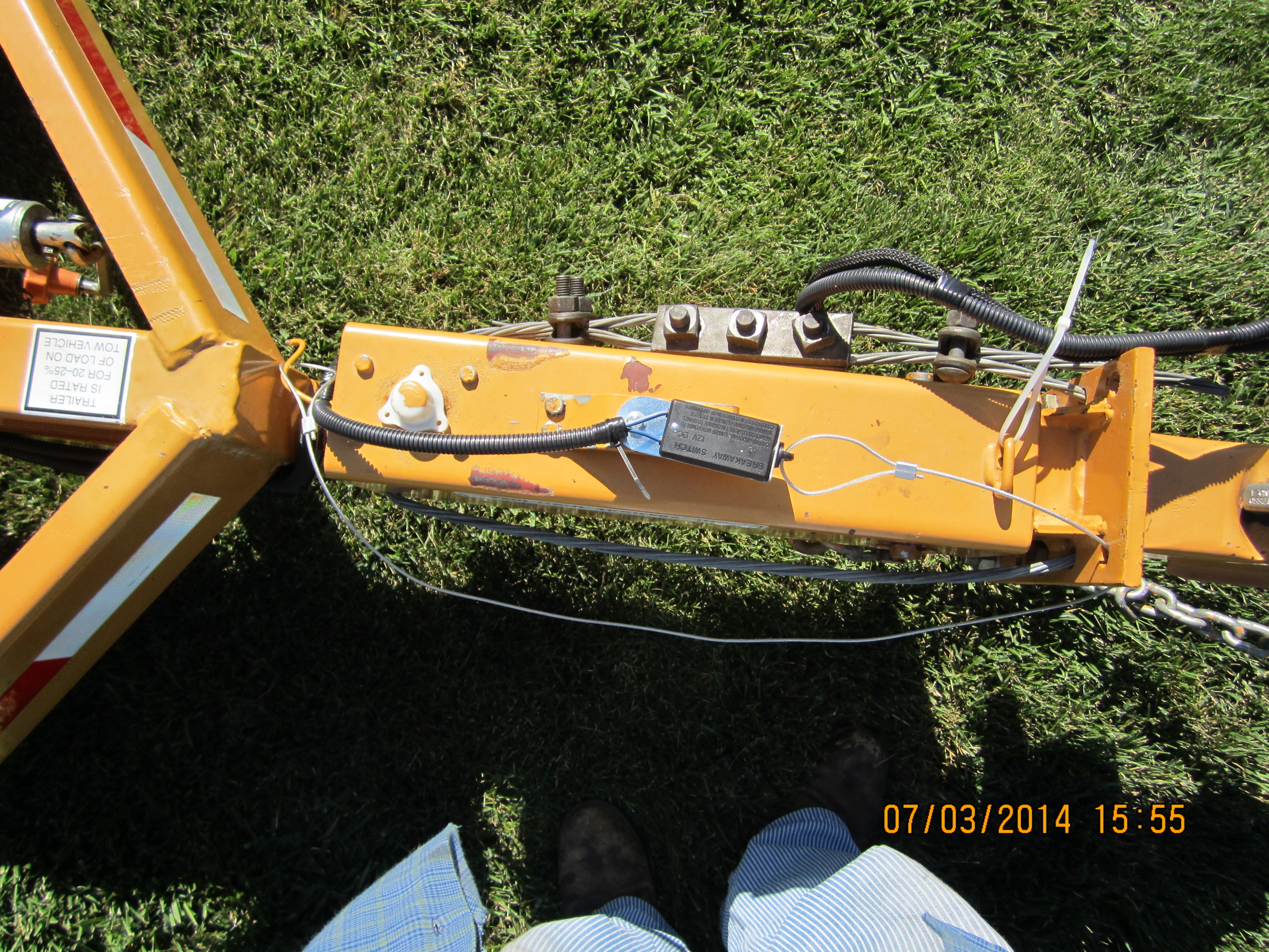

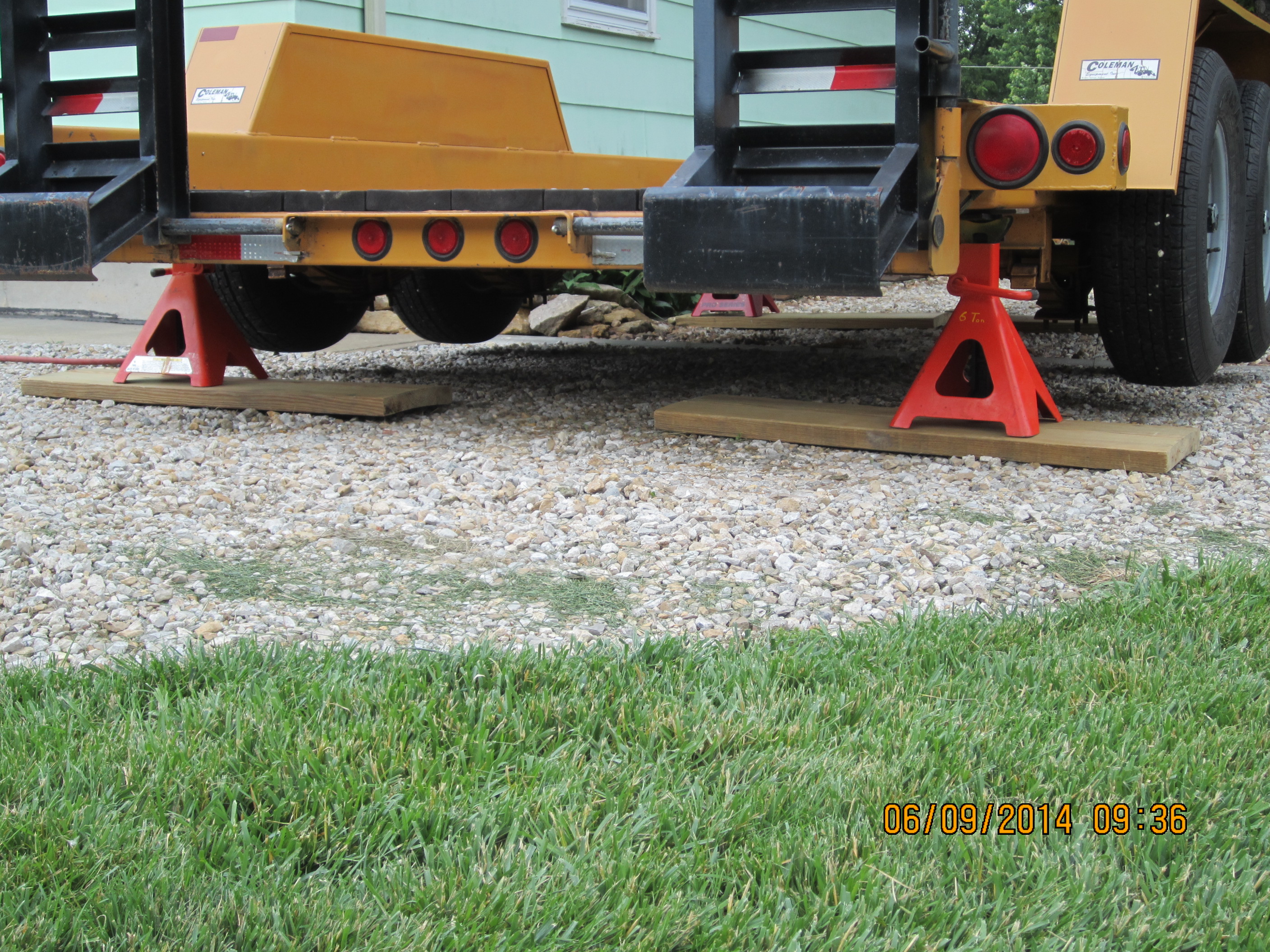

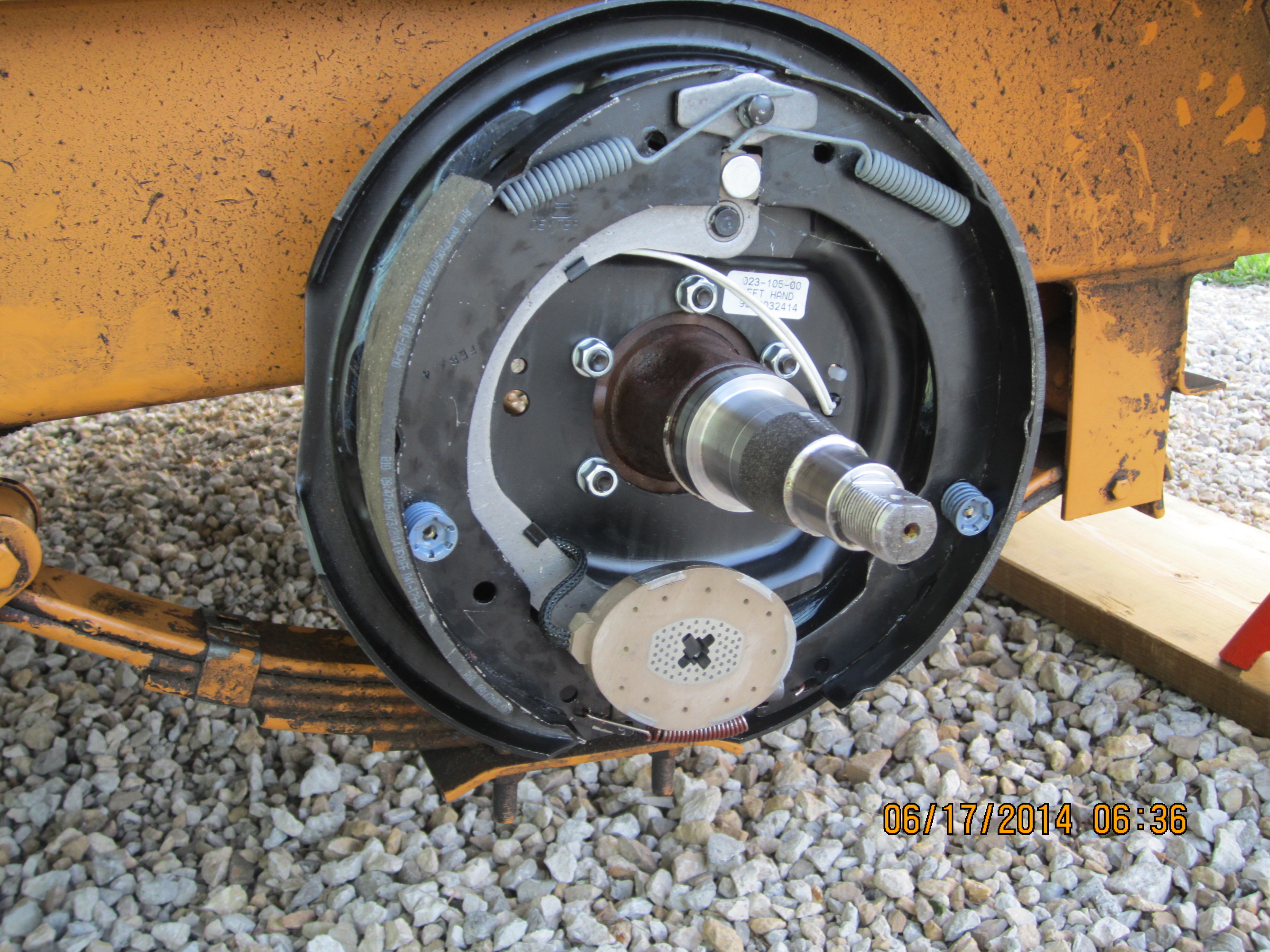

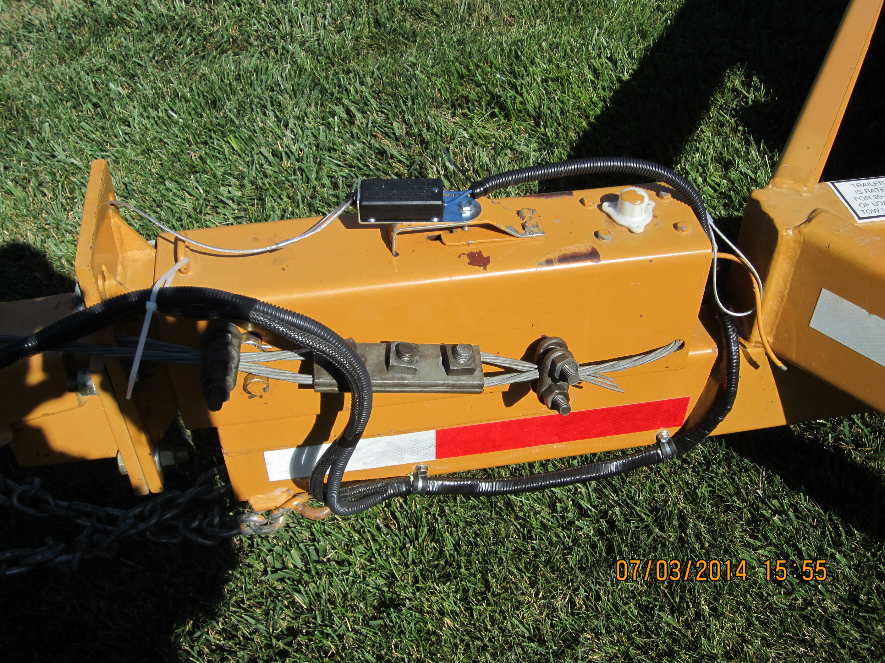

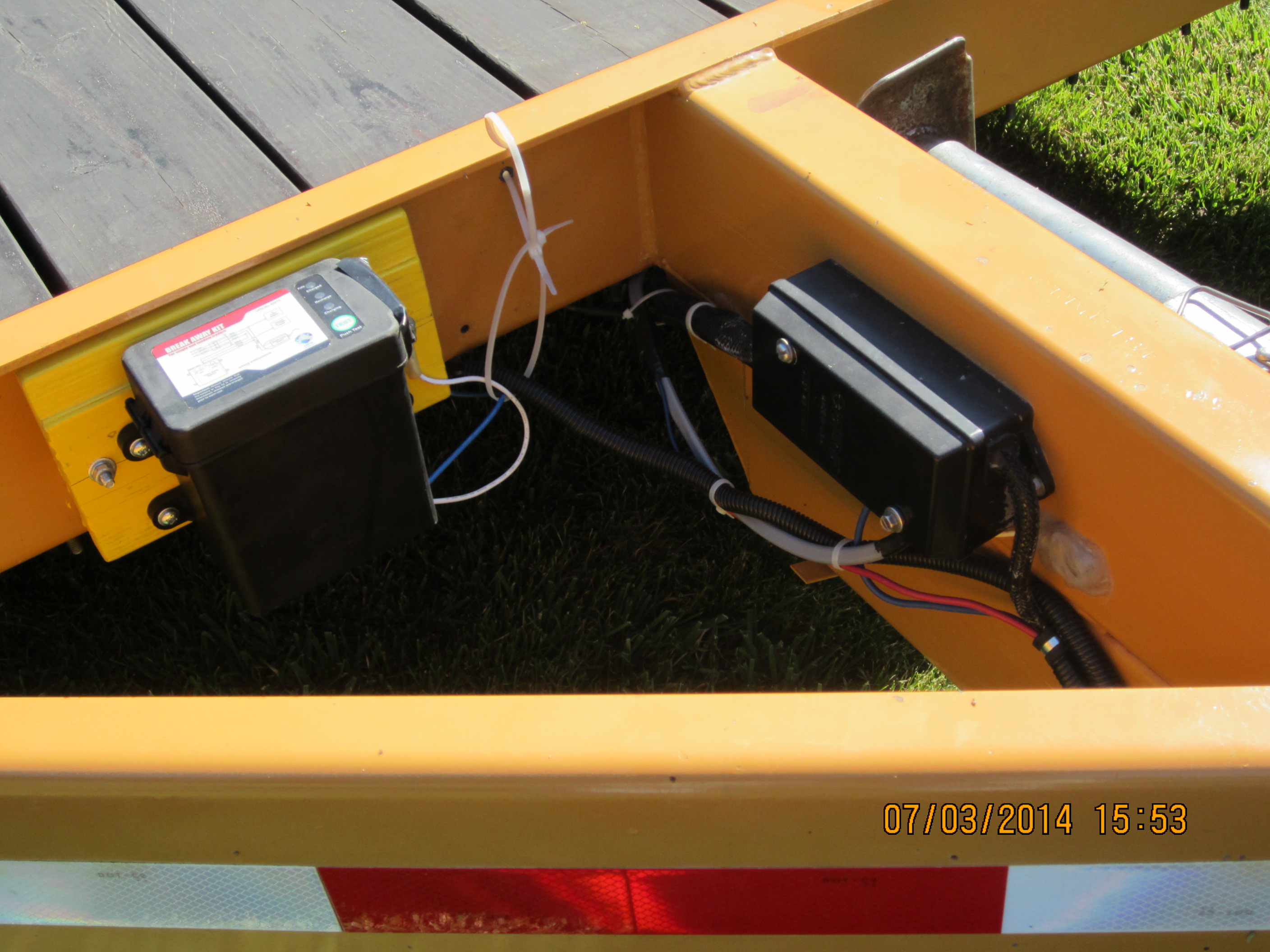

Here's some old pics.........723.JPGThis pic shows how I immobilized the Surge function of the OE.....since I'm not a welder. I was sick and tired of how the Surge brakes never seemed to be adjusted quite right such that no tire/wheel would drag and ruin a tire.
So, installing electric brakes, a controller and a break away set up was necessary. More pics now.719.JPG700.JPG722.JPG691.JPG

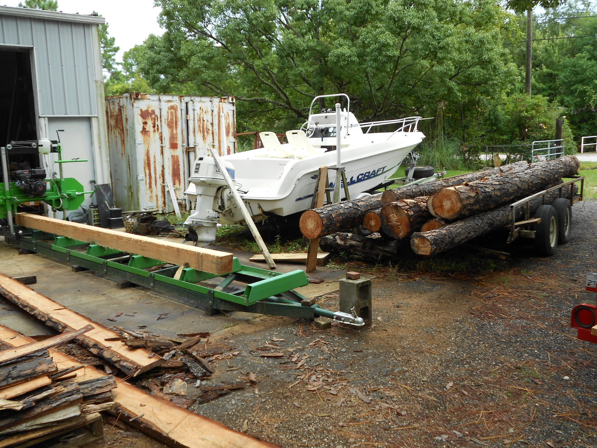

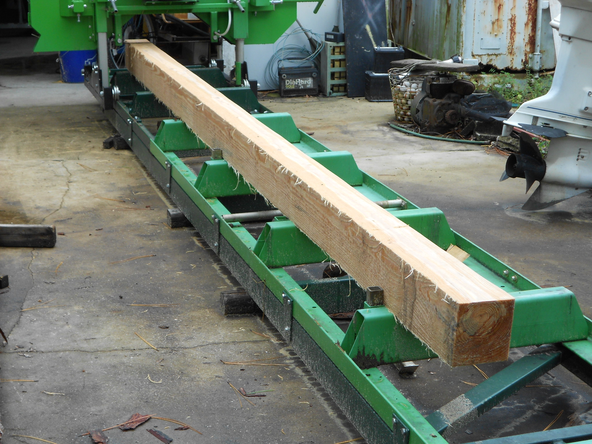

That is a trailer frame for my HF Sawmill so I could move it around and extend track to cut 16' boards.
Thanks for the tips. Now that you mention it, I do remember busting my behind on a wet steel deck trailer. I will see if I can find oak.
My method for getting the forklift as far as it got... well, that's confidential. Couldn't bear the thought of someone getting hurt trying to copy my jackassery. I've already said too much.
   / The Summer of the Trailer Repair #8
Diamond plate can be very slick and always seams to bend/warp. I like the look and function of a wood deck. Wood also dosnt rust.
Making a better ledge with a keeper bar that would act as a large washer may help keep those boards from breaking...but fork lifts have a huge amount of weight on a tiny area.
You probably will have to commission the cut at a sawmill. Get it 3" thick and bolt/screw them down GREEN. Get them tight as there will be gaps later, but I can tell you that is the best solution and will haul whatever you put on it. I've cut them with my sawmill for low boy trailer for large excavators. I grew up in the heavy equipment and tractor business. We used Oak then too. Pine was was just a short lived,weak option.
