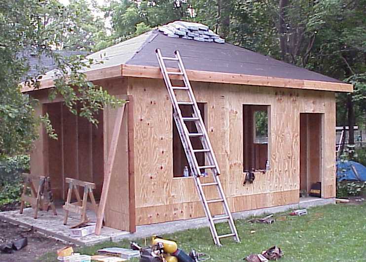

The previous post, before and after the pour shows the foundation. This set of six photos shows the construction of the shed/workshop/tractor garage built on top of that.
Photo 1: Walls up.
Cliff

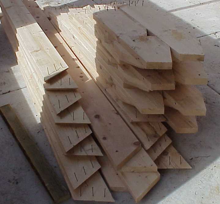

Photo 2: Rafters waiting to go up.
Cliff

   / The shed goes up. #7
Is that 14 x 20', or close to that size? and 9' walls? Roof pitch 5 in 12? Mind all these questions?
Nice looking building, siding, trim and finish (and great pics).
Thanks
My son is thinking of something along this line, but is restricted by code to be less than 150 sqft without a building permit, or by the subdivision code (don't remember which). I was suggesting an enclosed area of 10x15 for lawn tractor and garden tools, and a roof about the size and shape of yours (has to match the house -attached--style and yours is perfect) that will cover the enclosed area plus have a 'veranda' under roof for gardening work.

</font><font color="blue" class="small">( Is that 14 x 20', or close to that size? and 9' walls? Roof pitch 5 in 12? Mind all these questions?
)</font>
Yes, 14X20. Slightly more than 9' walls. 6/12 pitch. Don't mind the questions at all.
Cliff
