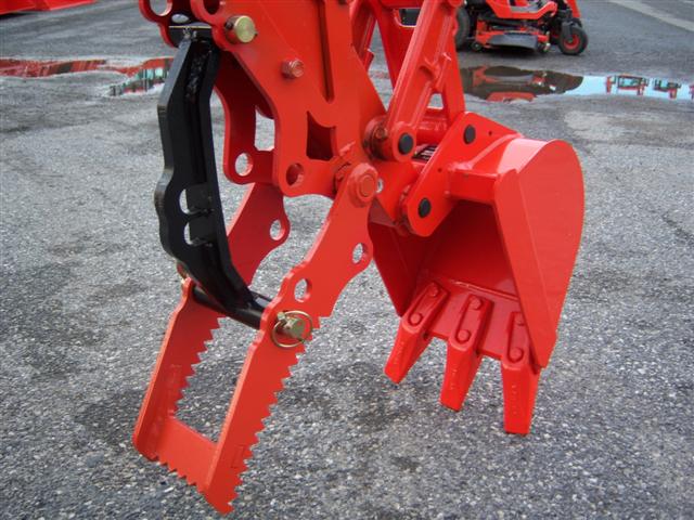

We decided to start stocking the Wallenstein for the BX24's. We specificly wanted to come up with some best practices for installation since many of you have been having problems with bolt on thumbs. We found two things that where easy solutions to the problem. 1st - Weld it! Its easy to run a bead at the joint between the thumb and boom. Just use lower power, the boom is not nearly as thick as the thumb. 2nd - Flip the bucket cylinder. Several people have noted that if the bolts slip the thumb gets pushed into the right angle hydraulic fitting. You can prevent this by flipping the hydraulic cylinder so the hose angles out away from the thumb brackets. These will be available on our website shortly.

What about a piece of 1/2 key stock welded behind the last bolt on top of boom then it still can come off if needed?

That is exactly what I did on my homemade thumb. Personally I would never weld the thumb plates on themselves...but that is just me;)

Volfandt, it looks like you have the same setup as me. I don't mean to be a wiseguy, but why would someone buy a thumb that needs modification to work properly without damaging something, when you can buy the Bro-Tek thumb that works properly to begin with? :confused:
   / The right way to install a thumb on a BX24
People reporting problems with the Bro-Tek thumb is what led us to do this in the first place.
