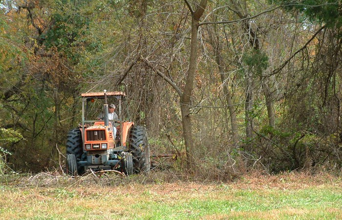

Dave..what did you pay for you 15' batwing mower? I have a 7 foot rotary cutter and it takes me darn close to 40 hours to cut my place...couldn't use the 15 foot everywhere, but it sure would cut down on the time in the wide-open areas...
   / The right size? #7
I think they are about $12K new. If you can find a used one, you may find one for $3-5K.
I am very surprised how easy I can manuver that puppy. Give me 15' 4" and I can get it through -- forward or backward.
I got mine, well, uh, for free. I just had to pay the shipping up here to Maryland from Florida. My father has a large mowing business and this was one of his many backup mowers that he let me have.
Regards,
Dave "Gatorboy" Hoffmann
Fallston, Maryland
