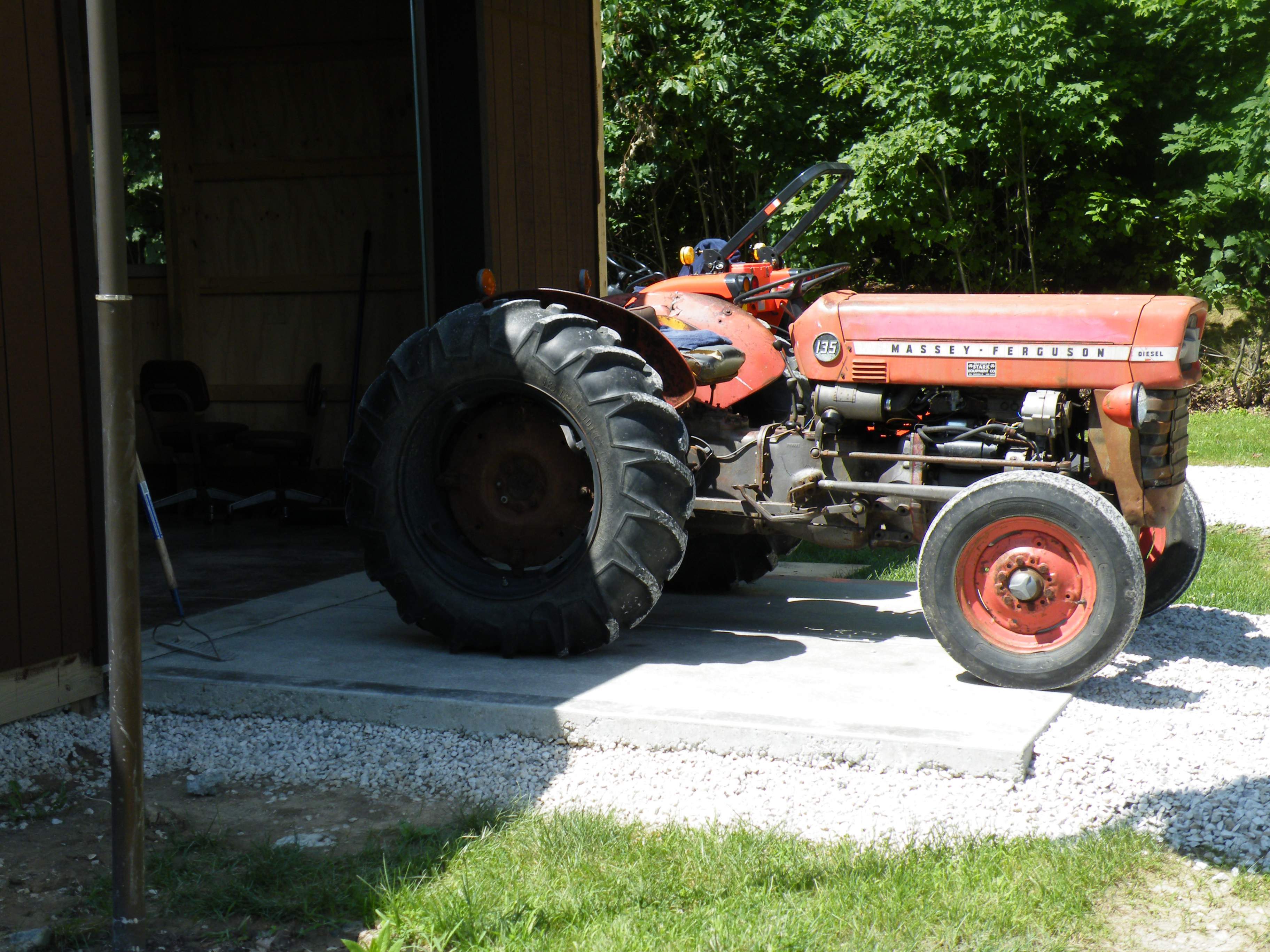

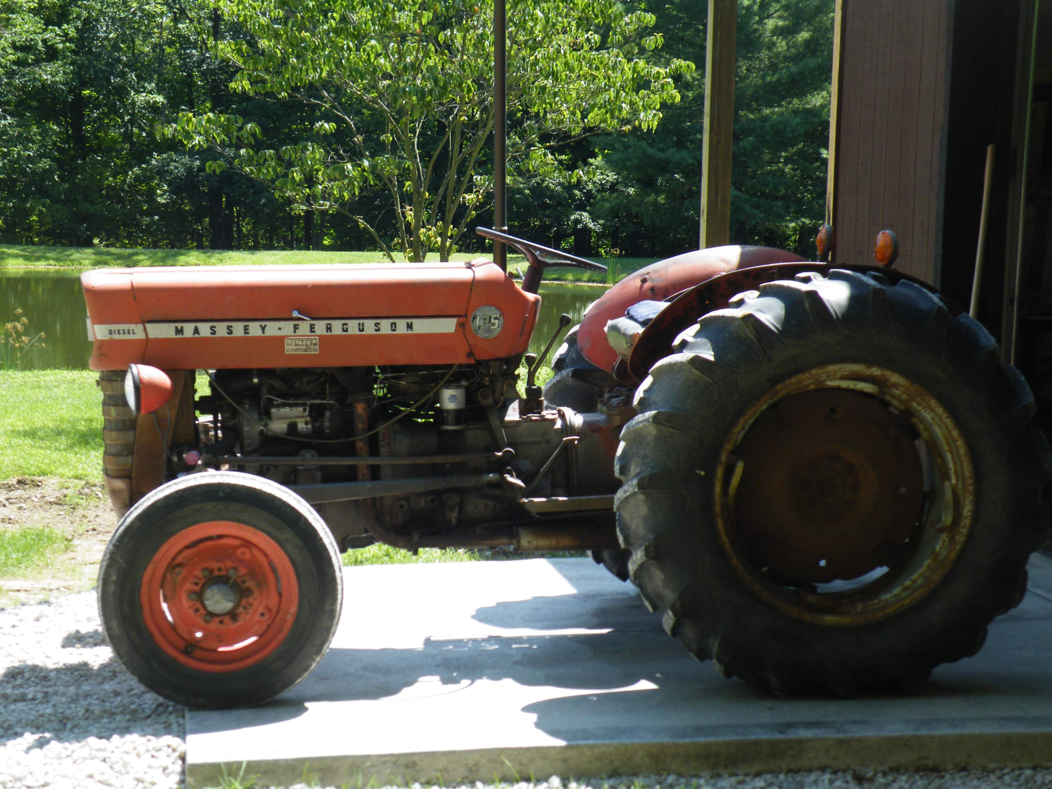

Am starting my restore on my 1967 MF135 Diesel Deluxe.
