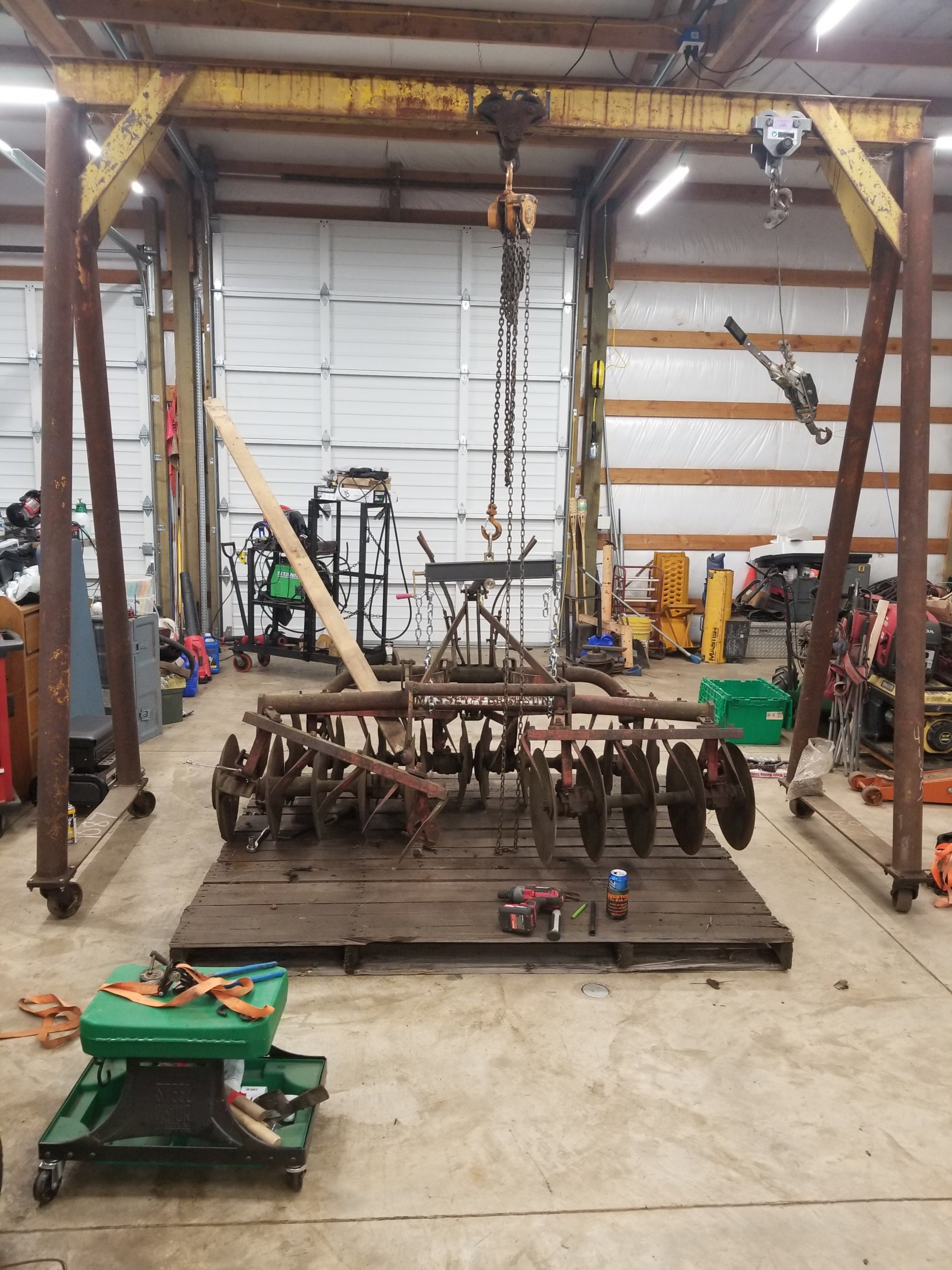

I got this thing for I think $200 or $250 around 4 years ago at auction but it needed some work, it was missing a couple pins and needed some tinkering, it sat for a while, then I moved it to the driveway hoping it would get me working on it if it was in my way, but nope... then just over a week ago I decided enough and drug it into the shop now that I have power... In a day and a half I had two of the 3 pins made and the one missing piece fabricated. All of the bearings are dry and rusty so tonight I got two of the outer parts cleaned up, still need to wire brush the inside parts before I put it back together. Next up though is twisting one of the bars by the ball back to straight, it's just 3/8" by 3" bar... :). The pictures show it partially disassembled and some of the progress, don't have a before picture... One of the next steps is getting the AC/DC stick welder from the garage and putting the AC Thunderbolt into the garage, I'd like to run 7018 for some of the next steps instead of just 6011... That vise in the in floor receiver is fantabulous though! I have a bench grinder on another post about 5' away from the vise, very handy, glad I did it... I'm aware that vise is a junk China vise, it was basically free and the 2" tube is light wall so I'm not worried, the big Columbia on the bench is for more serious work :).

My little tractor doesn't have a remote or anything but has a couple thousand pounds of 3 point lift ability so 3 point is preferred, I had a drag type disc that was way too big for a while but once I got this I sold the drag disc to a guy that turned it into fountains... lol

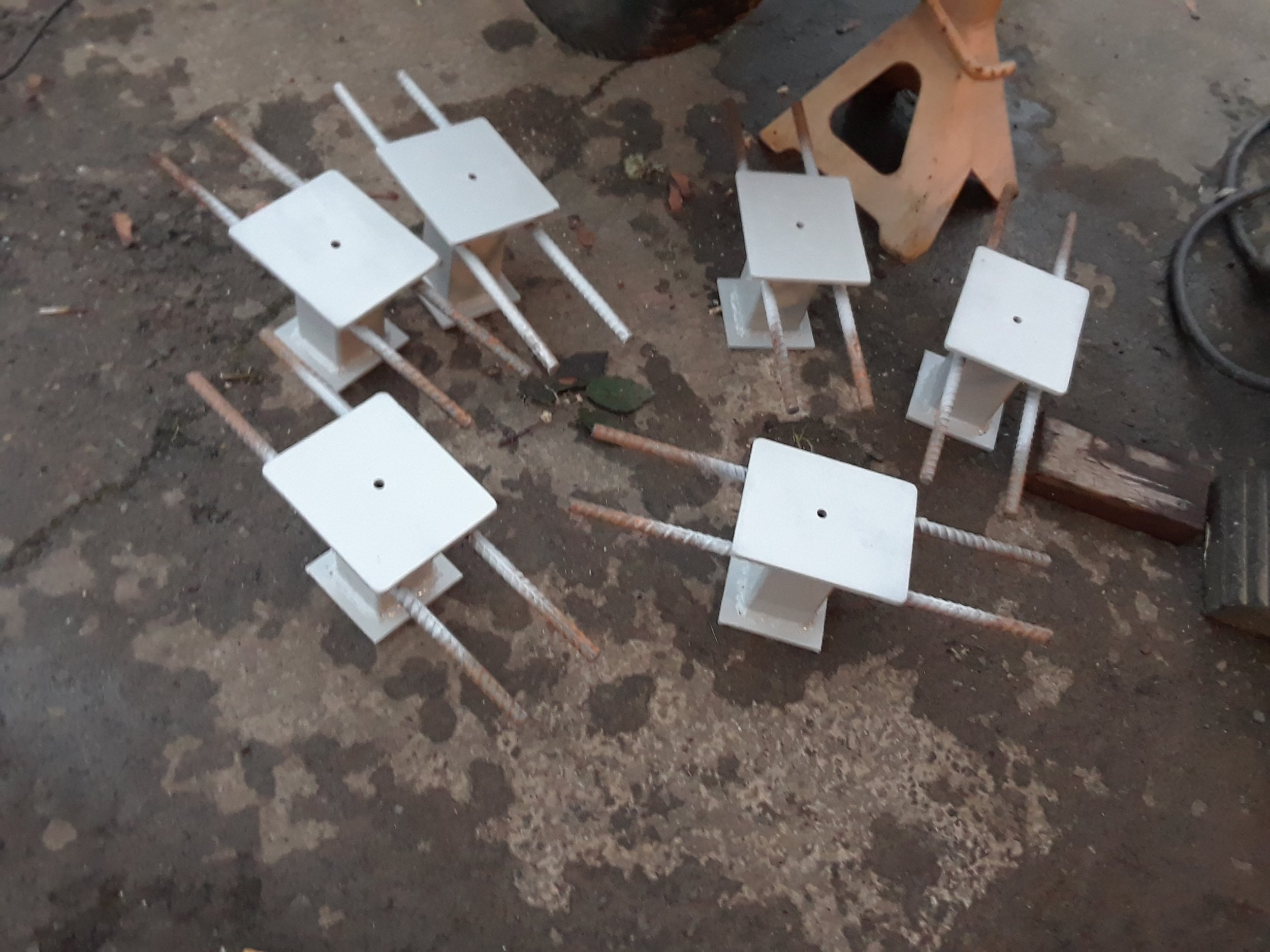

For good measure here's what the receivers looked like before the floor was poured, the short pieces of rebar were tied to the rebar grid in the floor, I put 6 of those receivers in in various areas, also put in 6 anchor pots to do some frame work on my rigs with bent frames :)

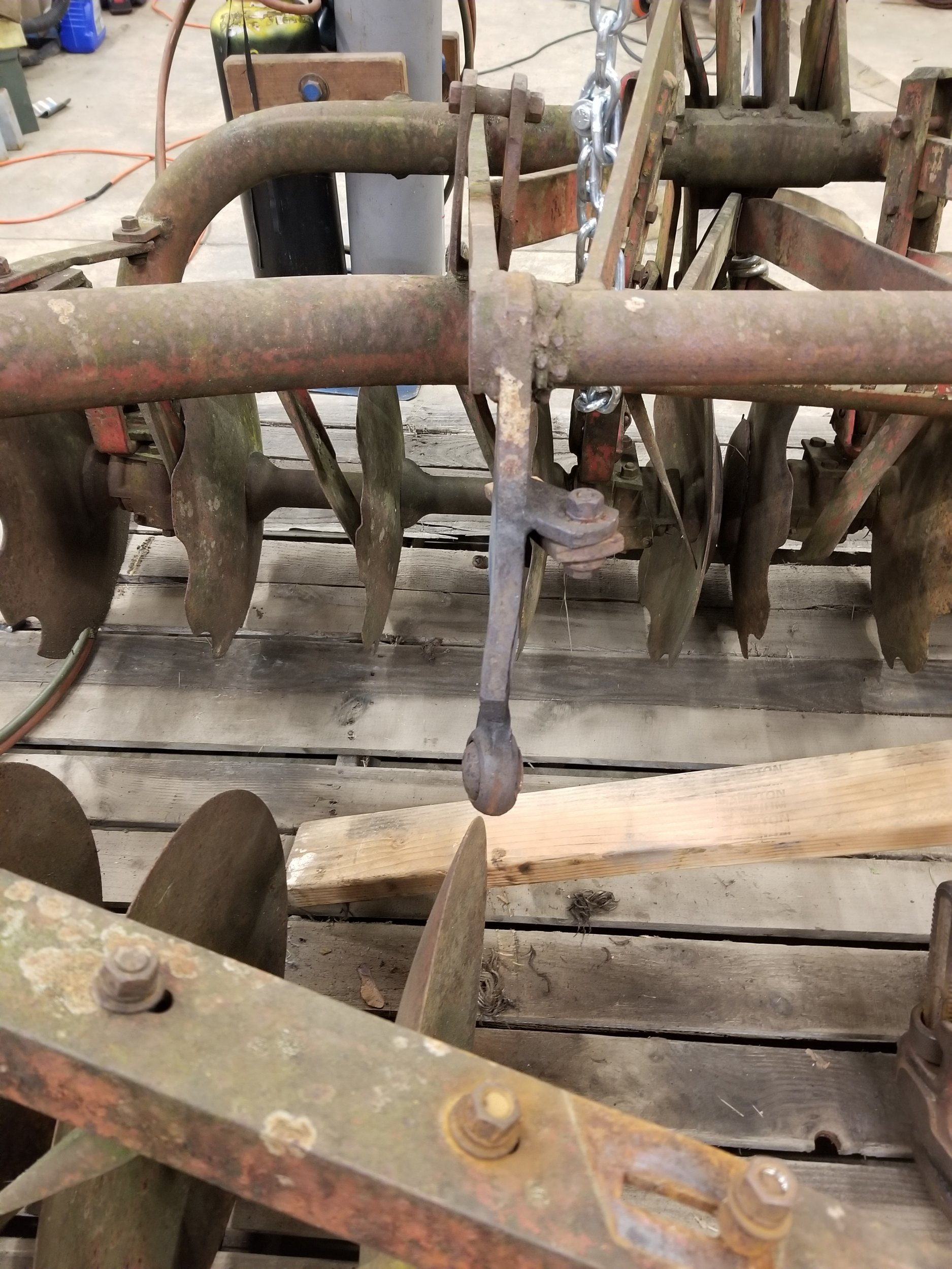

I got a cold this week which slowed me down... yesterday I took 30 minutes in the shop to untwist the twisted area on the one ball end, it's a 5/8" by 2.5" bar so wasn't going to do it cold, took the O/A torch and got it hot with the 36" pipe wrench on the link and 2" ratchet straps pulling both ways with the wife helping some and I got it straight enough, little wavy but the ball socket is at abut the right angle so good enough... Feeling better today so I'll head out in a bit and drag the AC/DC stick welder to the shop so I can use 7018 to fill in some gaps on one of the brackets from it running with that twisted bar for so long... I don't feel like fighting with 6011 on AC, I like the old Monkey Wards/Century welder better than that Thunderbolt but no regerts... maybe update pictures later tonight...

Here's early on in straightening the one arm
Here's after I got it as straight as I think it needs to be

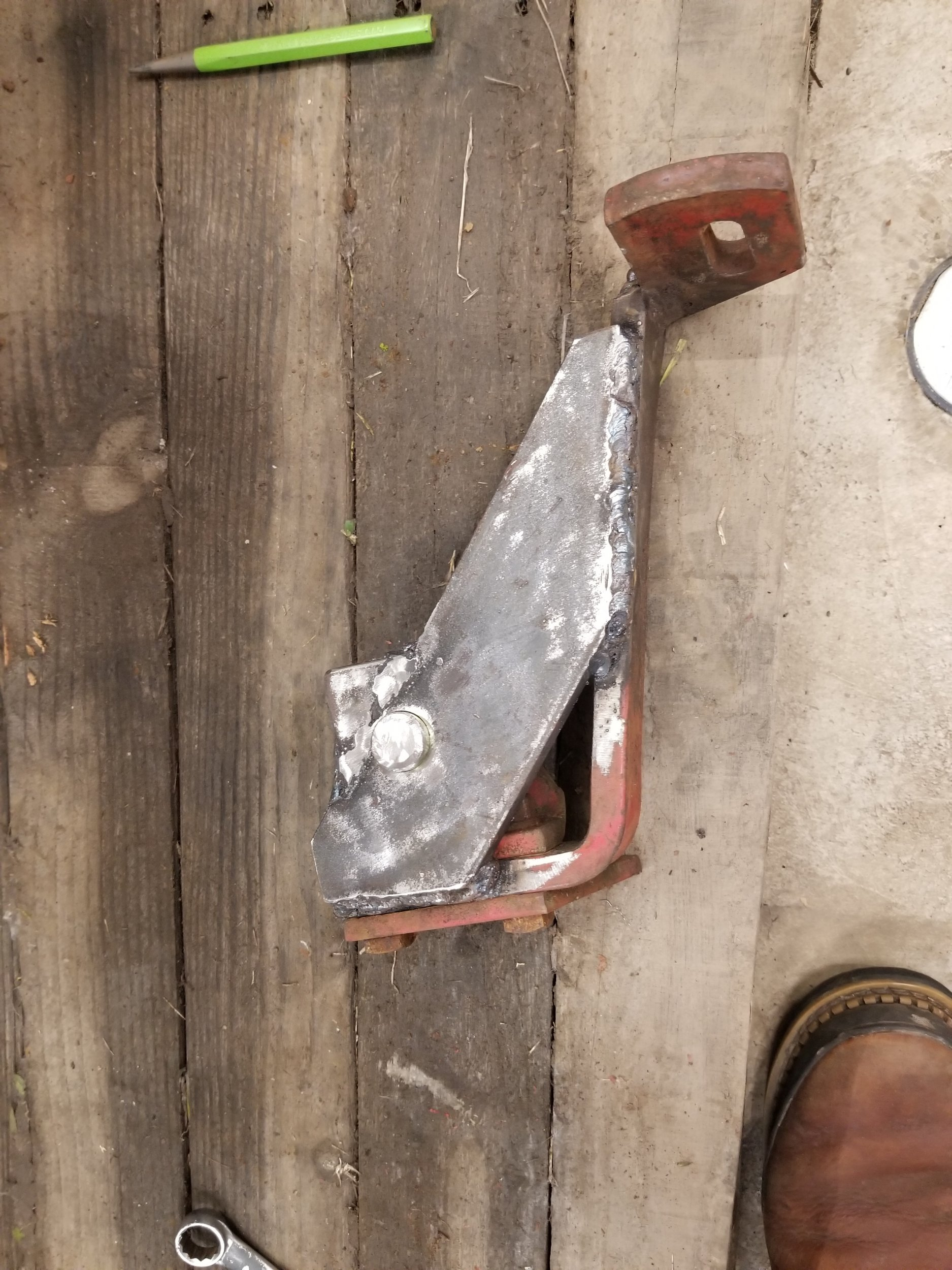

Here's the one piece I had to make, it was missing the angled piece of 3/8", I'll admit I was kinda winging it at first and the hole ended up needing to be right on the edge so I ground the sides of the corner I cut off and welded that in place, should be plenty strong...

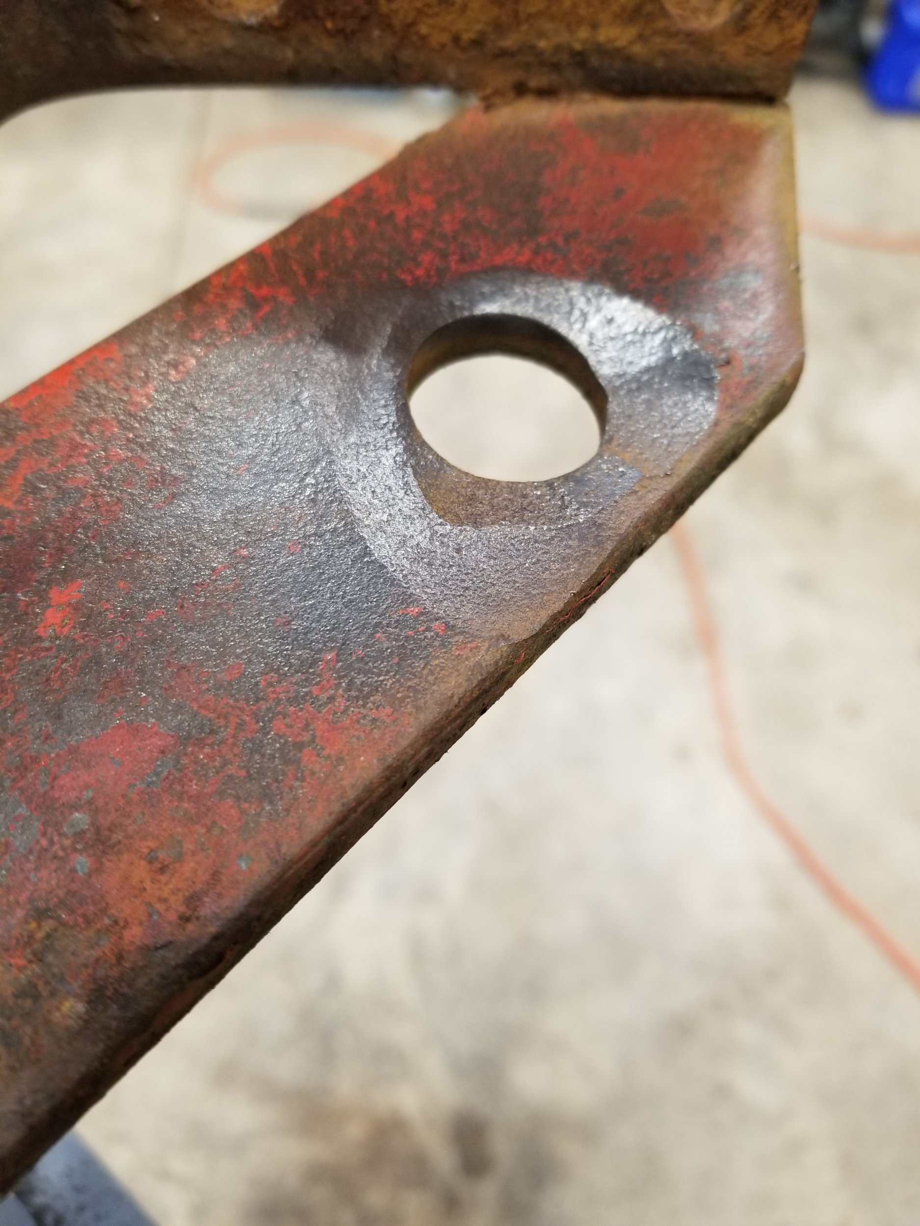

Here you can see where the area next to the ball on the twisted part wore, it was also bent so I straightened it in the press before welding, I cleaned it up more before filling it with 7018 then grinding smooth and dremeling the welds some

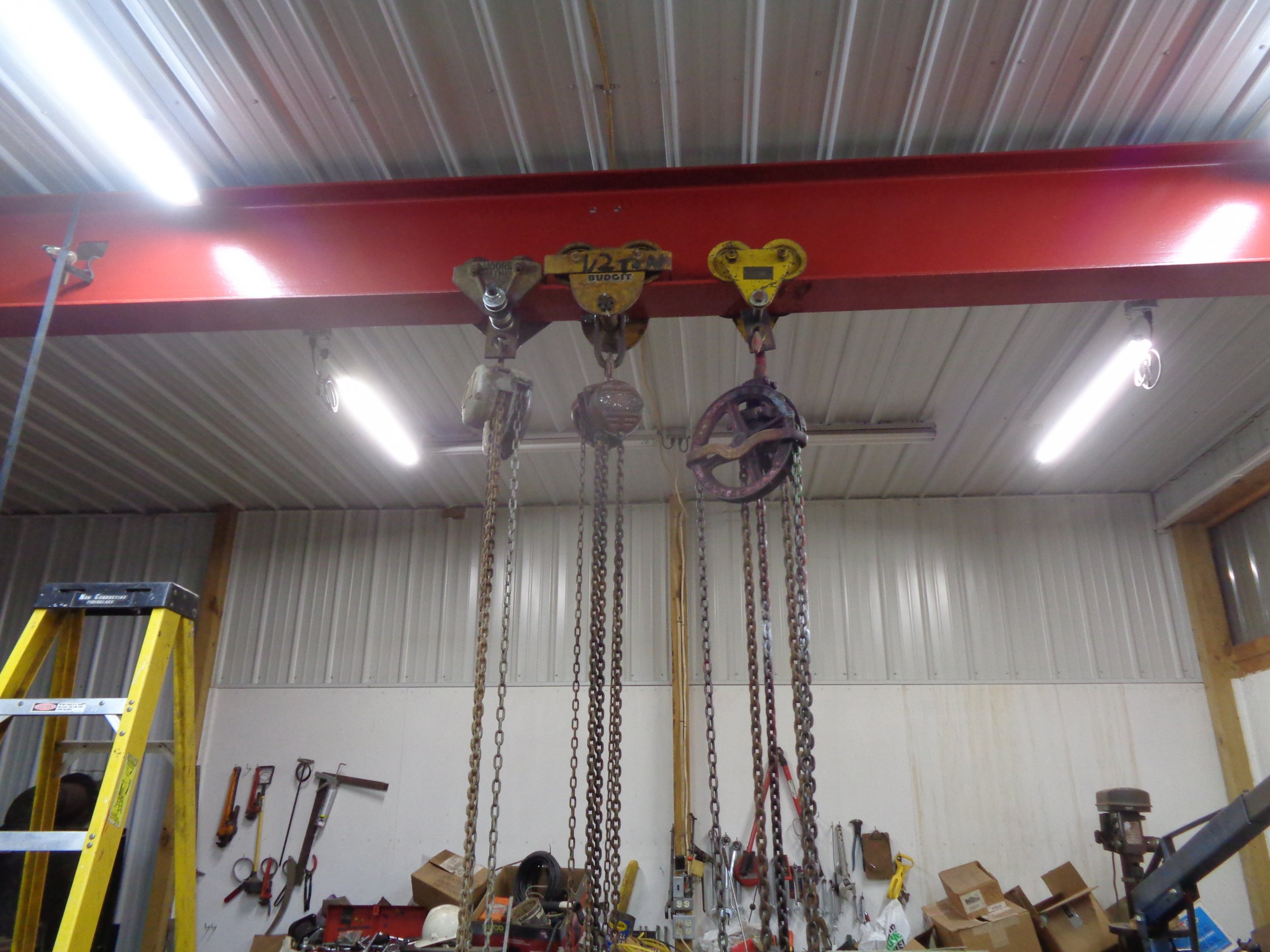

I put a 15" I-beam spanning my shop with 3 trolleys and chain hoists on them. I have 3 more to put on there. Seems you never have enough. Great for splitting tractors parking it parallel with the beam, you can have a complete smaller tractor hanging there in pieces.
