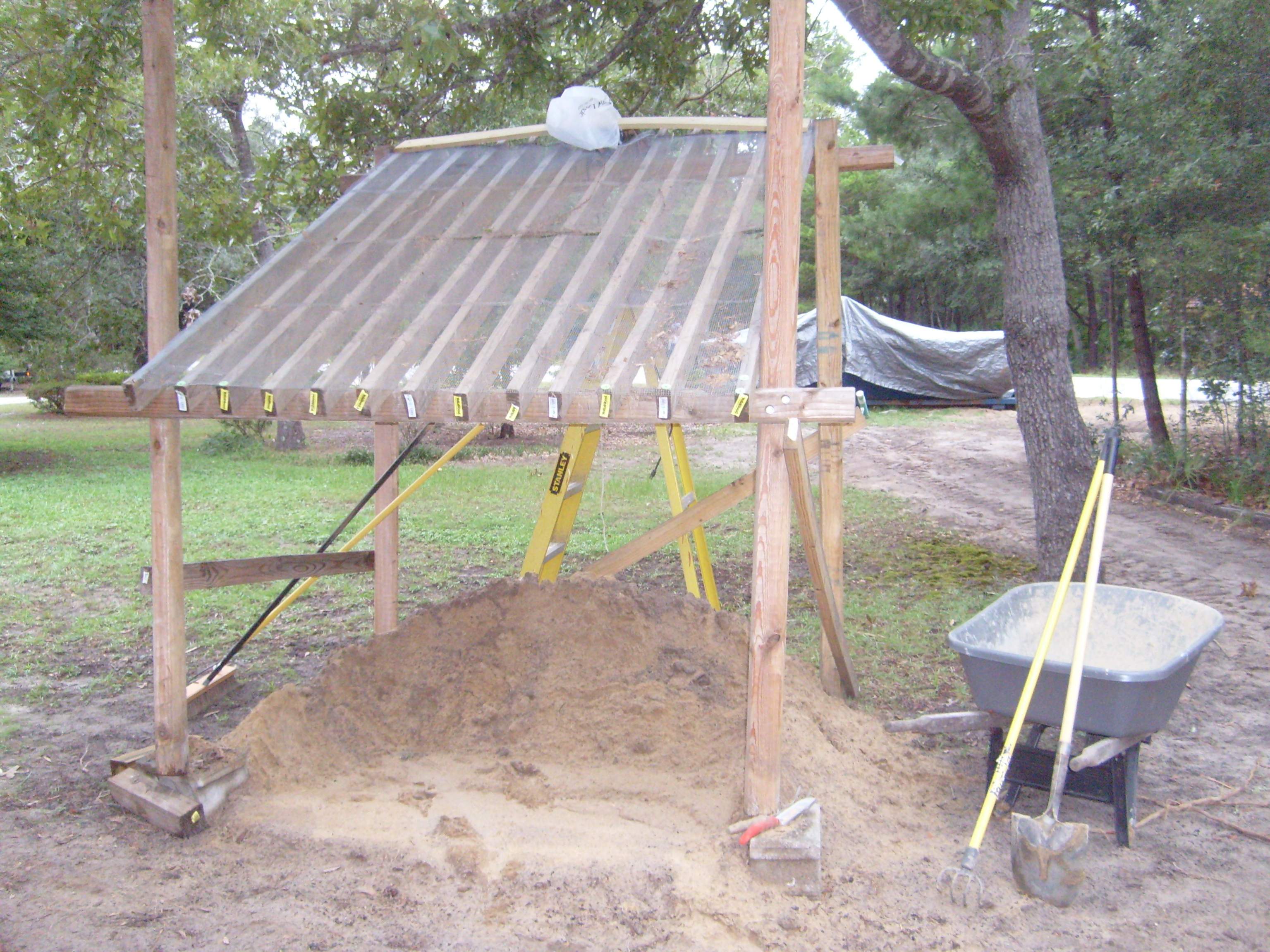

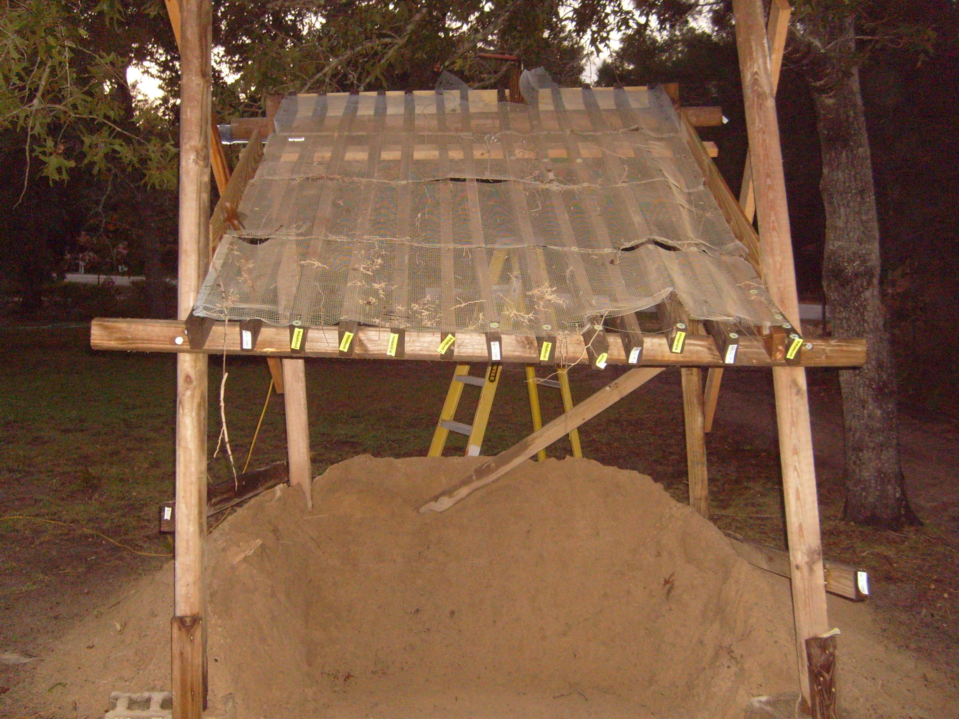

We rented a long dumpster to put all the cut off damboo into, and decided that we would remove and discard the top layer of dirt also. The dumpster people were OK with that, but we suggested that they are crazy for letting us do it. I had to use the tiller to break the clumps enough to get the loader bucket to penetrate anywhere inside the area.

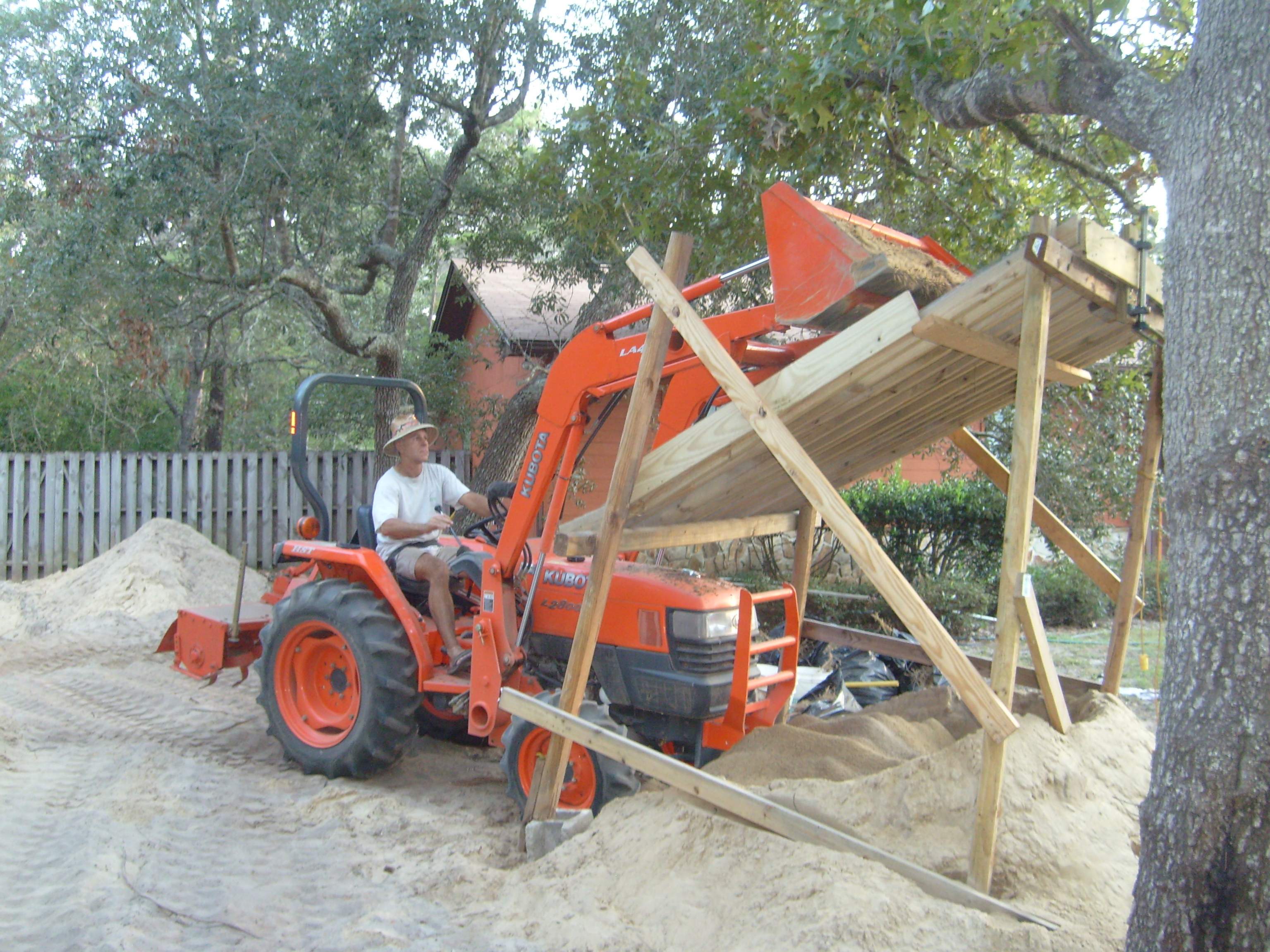

After the third dumpster we figured out that this would be expensive, so we changed the plan to sifting the roots from the dirt and putting the dirt back. Hence the invention part. I had read here on TBN a few years ago that somebody in the northeast had built a rock screen so separate rocks from dirt. Same thing, I figured. A quick trip to the store, and we had everything we needed to sift our pit clean. Kind of.
A test dump proved fairly quickly that the sand won't just fall through like it did in the dream. To convince it to move rapidly it wants to get moved around. I dug around in the back of the shop and pulled out a small motor. An iron bar and a few short hours later we had our first shaker ready. It was a small 12VDC motor from a scooter that the kid down the street had junked when the battery went bad (he didn't know he could just buy a new one). The problem was that it was round motor with no good way to attach it. It worked great! For about 45 seconds, when the motor twisted around in the straps I had mounted it in, the bar hit the edge of the screen frame, the motor stalled, and began producing a LOT of smoke in the few seconds before I could turn it off. Strike one.
Back to the shop. This time, a motor from the old garage door opener, and it's even mounted on a plate for convenience! This one ran just about as long as the first, and then the motor mount bolts sheared clean off. Strike two, and time for a little more meat.

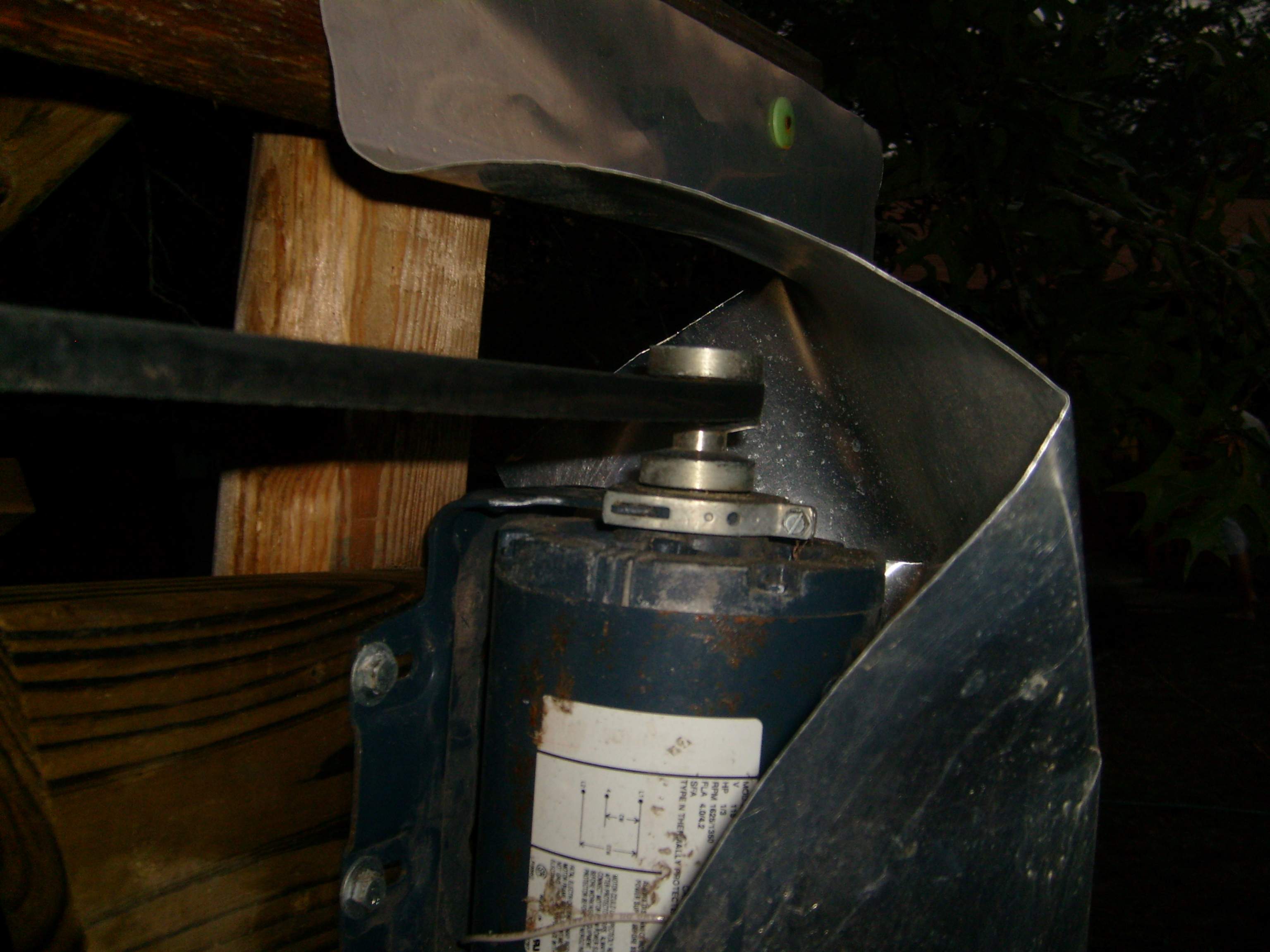

Back to the shop. Hey! That 40-year-old edger that dad had has a decent motor on it, and the blade is ready for me to bolt on a counterweight! Only a few more hours of fabrication, and we had a fine motor vibrating the screen and we were on our way to success! For a few minutes, when the bearing on the motor started getting a little sloppy. It would run for a few minutes, start getting a little hot, stall itself, and need a rest. Oil the shaft liberally, and you could go another few minutes. This was more like a foul ball, since we made a little progress. Still strike two.

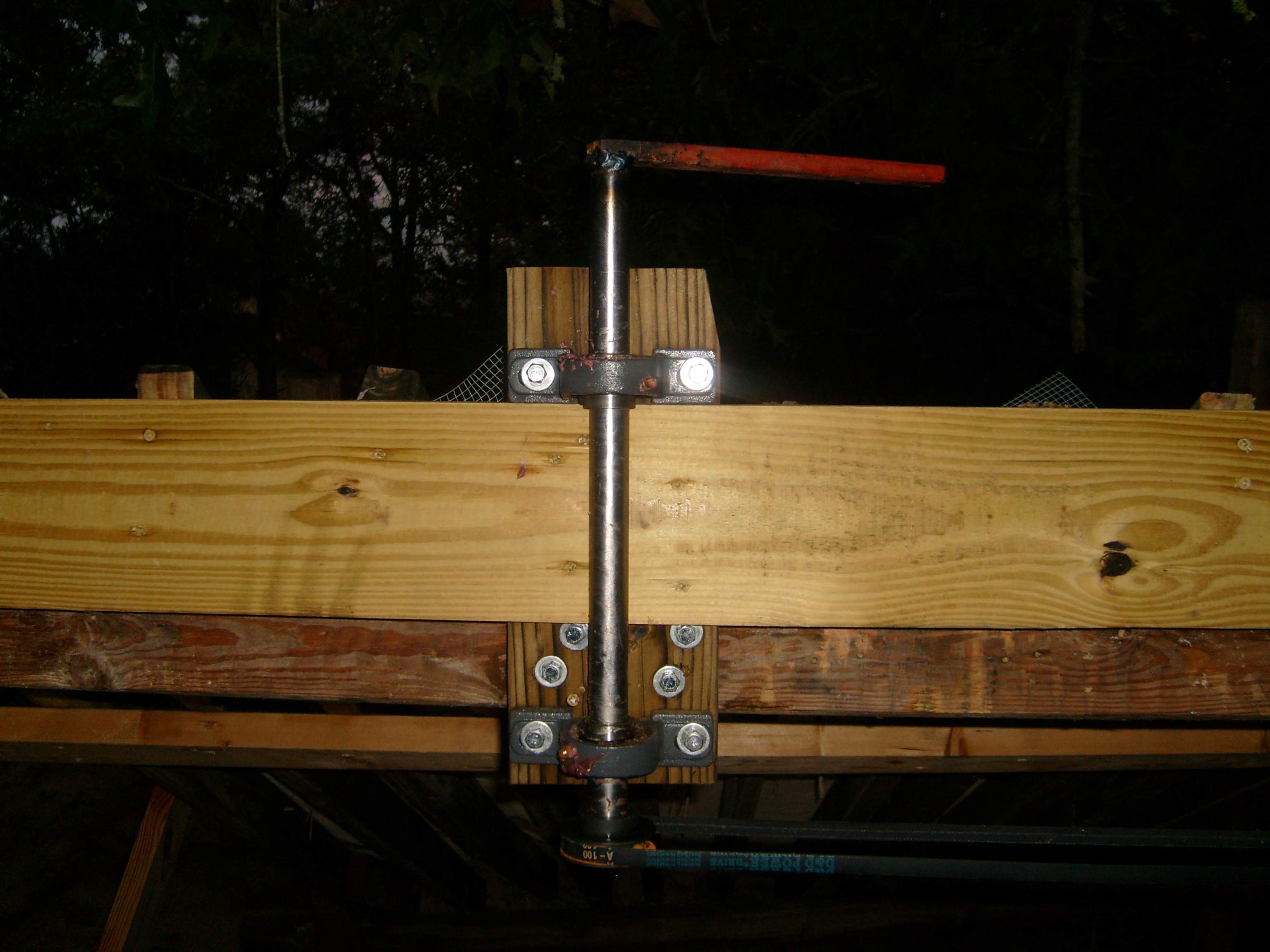

In telling the neighbor about our trials, he suggested that the only thing that would save the motor bearings is a belt drive. As luck would have it, I had to go out of town soon, and I had a chance to visit a surplus shop in a bigger city. A decent 1.5 HP motor for $20? With a double drive pulley on it? Sold! Lucky for me, I had equipment to ship back home anyway...
I bought some 1" ball bearing pillow blocks, several different pulleys, and a 100" drive belt to absorb the shock of the spinning weight, and went back into the shop. Only a few hours later, our newest shaker motor was ready! And what a beast! Plug it in, trickle the dirt onto the shaker, and watch the cloud of sand fall through below. Excellent, except...

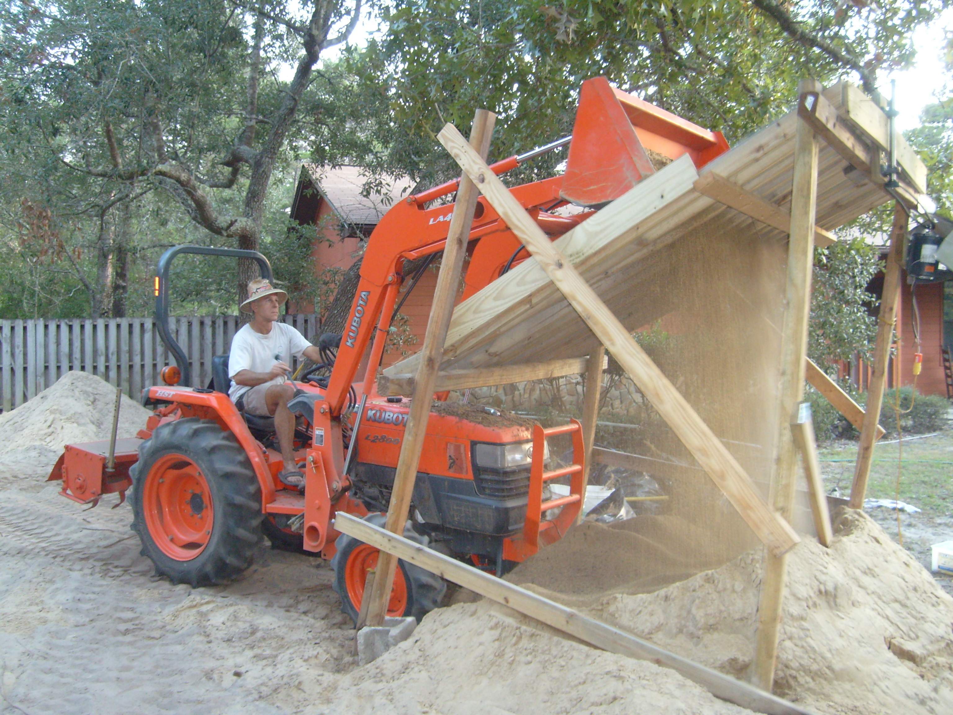

Now the thing shears off the screws and lag bolts that hold the whole deal together. Amazing. Do a few buckets of dirt, stop, get off the tractor, replace a few broken screws, get back on, start again. But did I mention progress? This thing runs best just before something major breaks, since it is the loosest then and the shaking energy can do its job. I hate to beef it up too much because it doesn't work as well. So for now, we're tolerating the stop and fix issues. We also modified the front of the screen to direct the damboo roots into a bucket instead of just dropping them on the ground in front of the screen. This improved progress a lot, since we no longer have to rake the ground after every bucket load.
I estimate that we'll have to move a little over 100 yards of dirt to complete the job, and so far we have either thrown out or sifted about one third of it. One of the tricks (aside from keeping the shaker running) is figuring out how to keep a ramp into the pit to drive the tractor in and get more dirt.

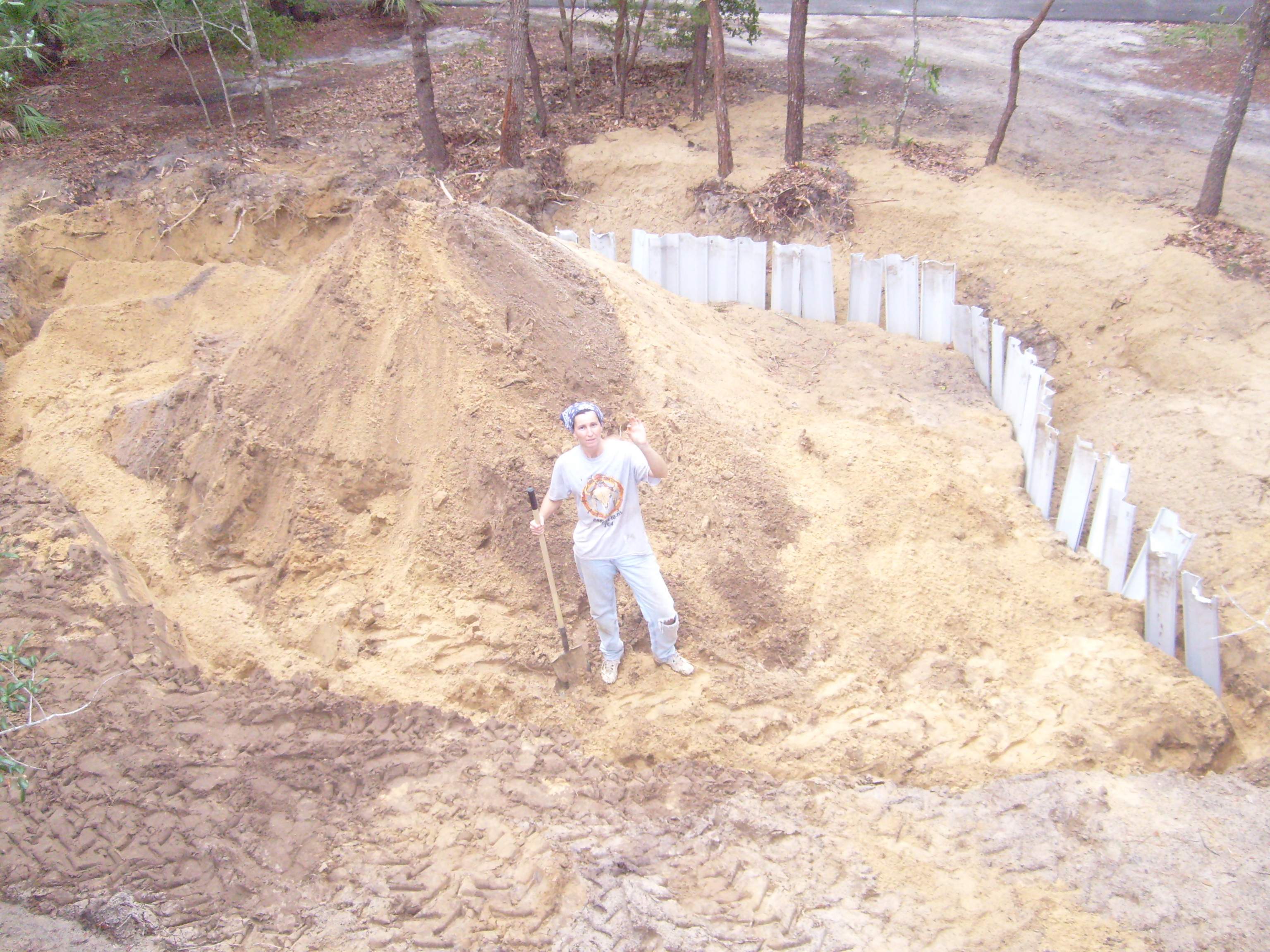

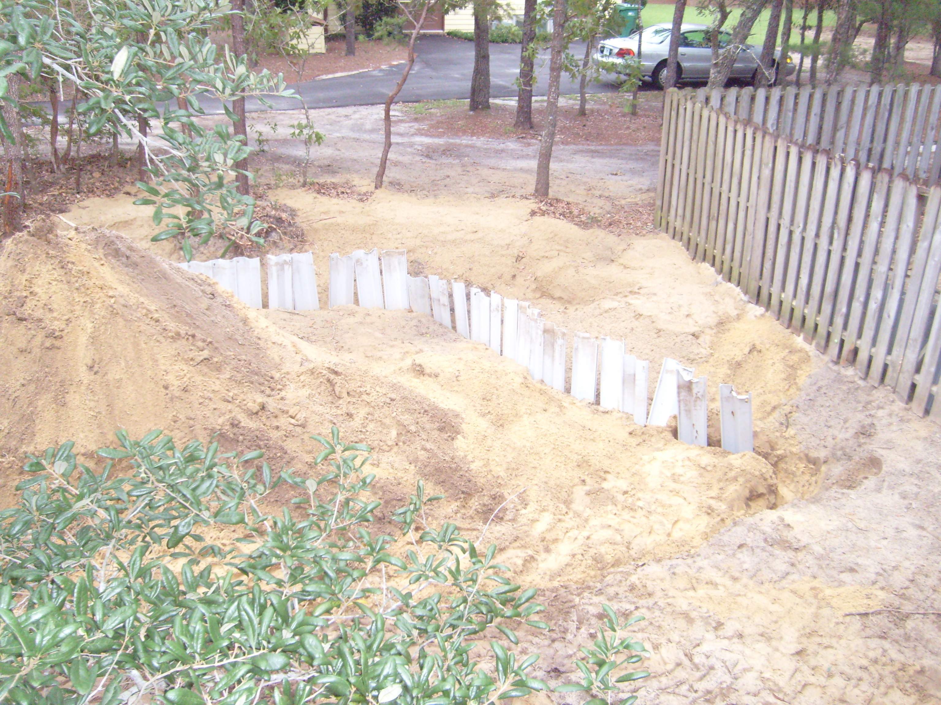

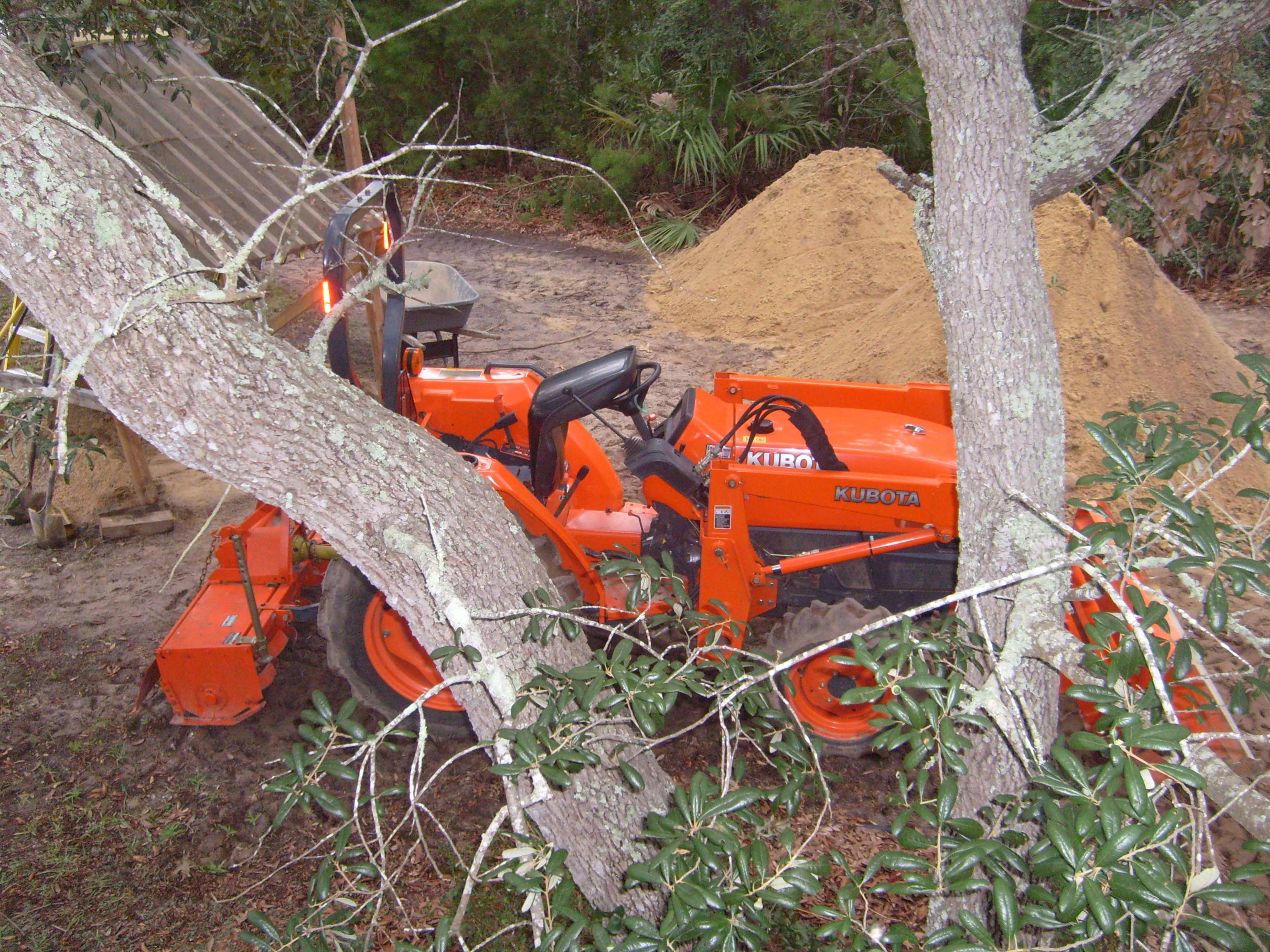

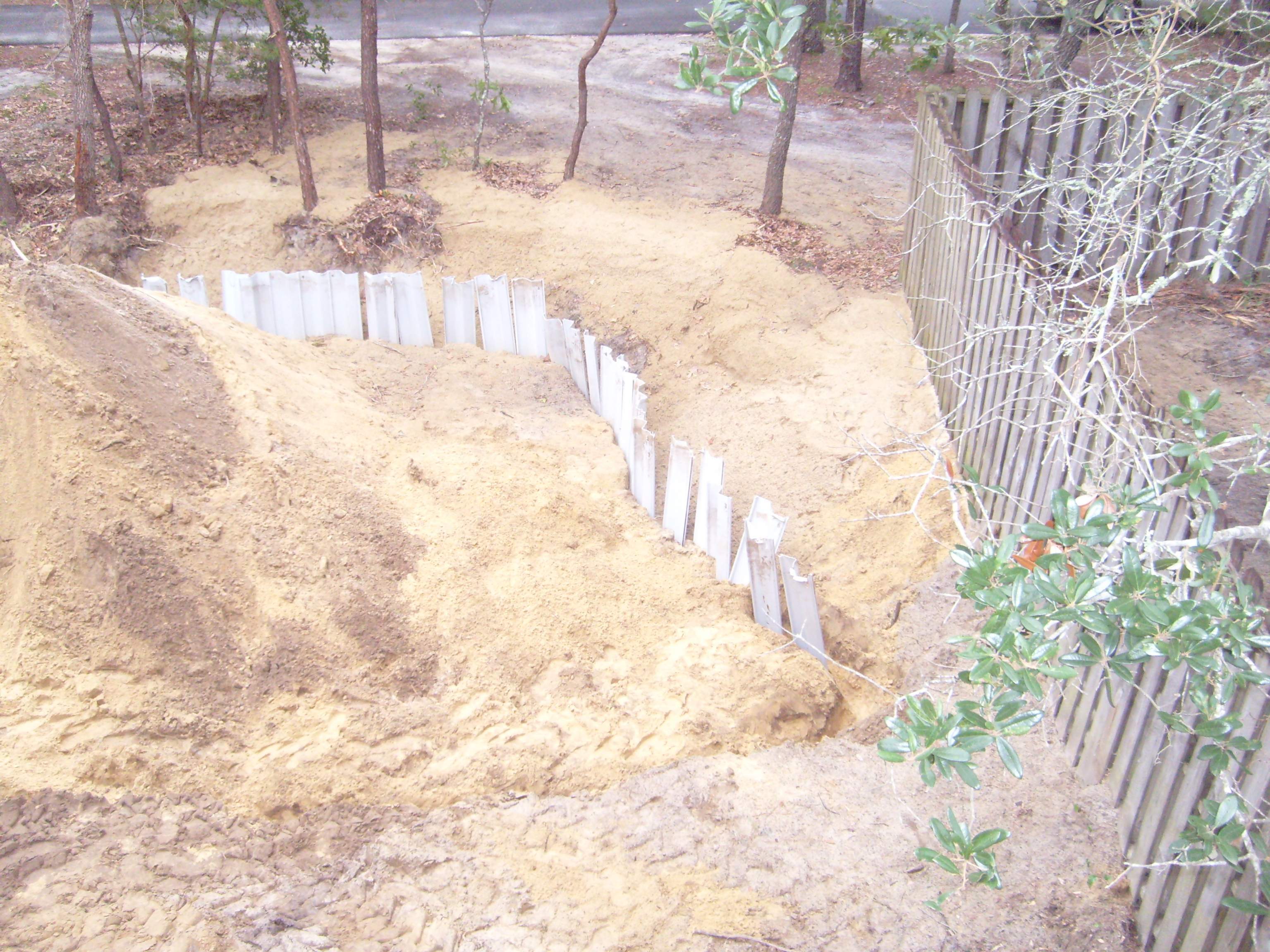

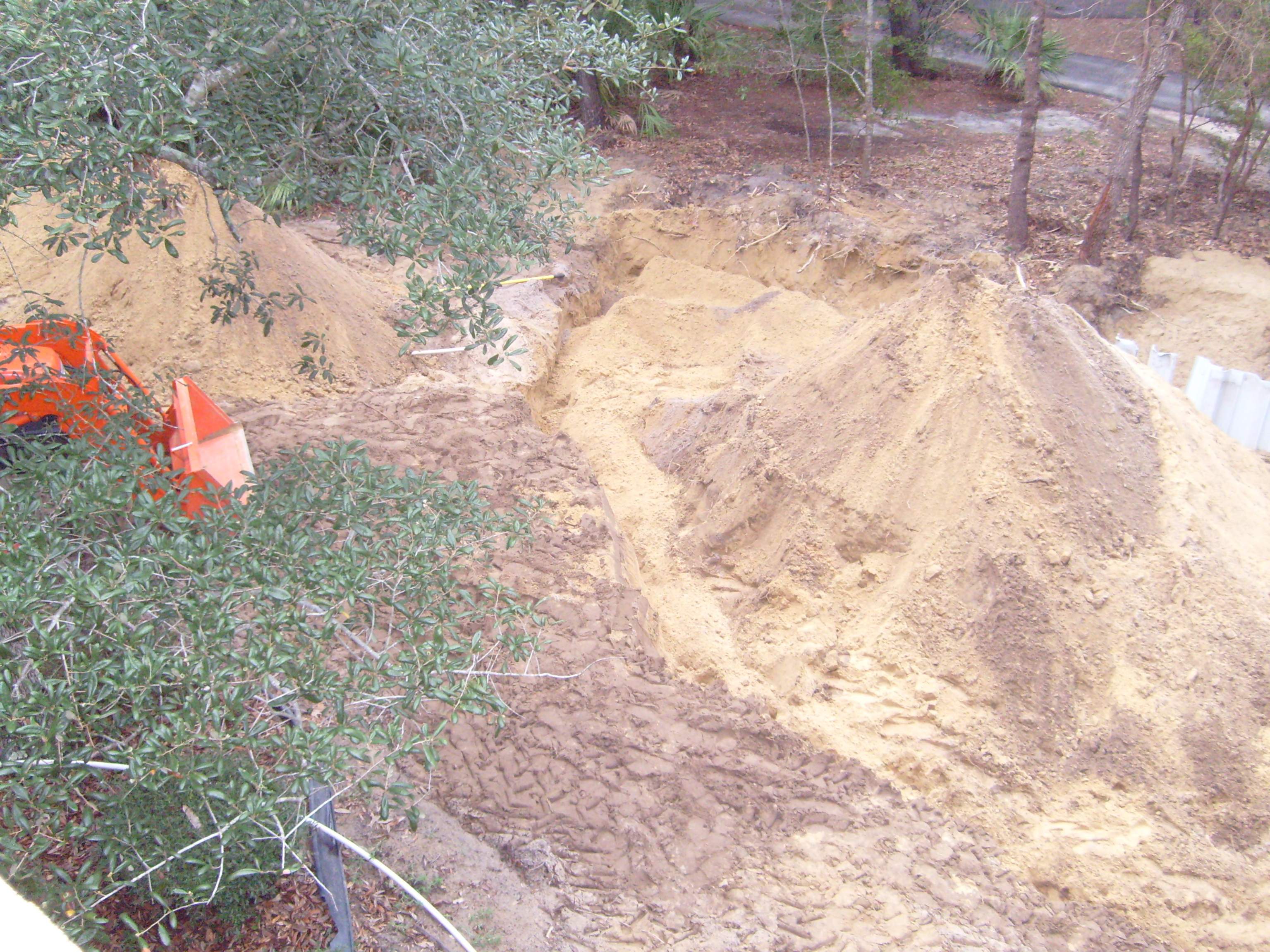

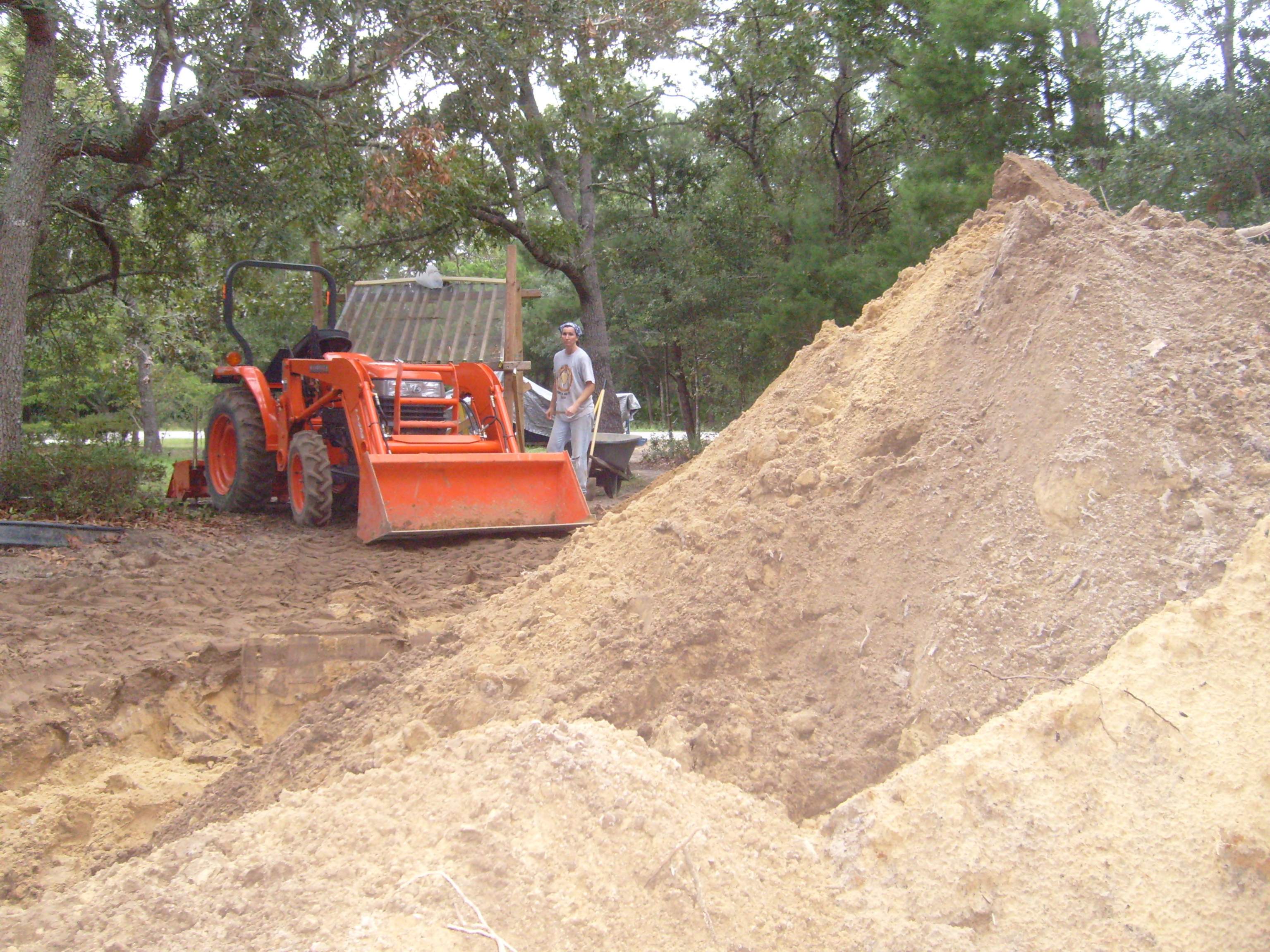

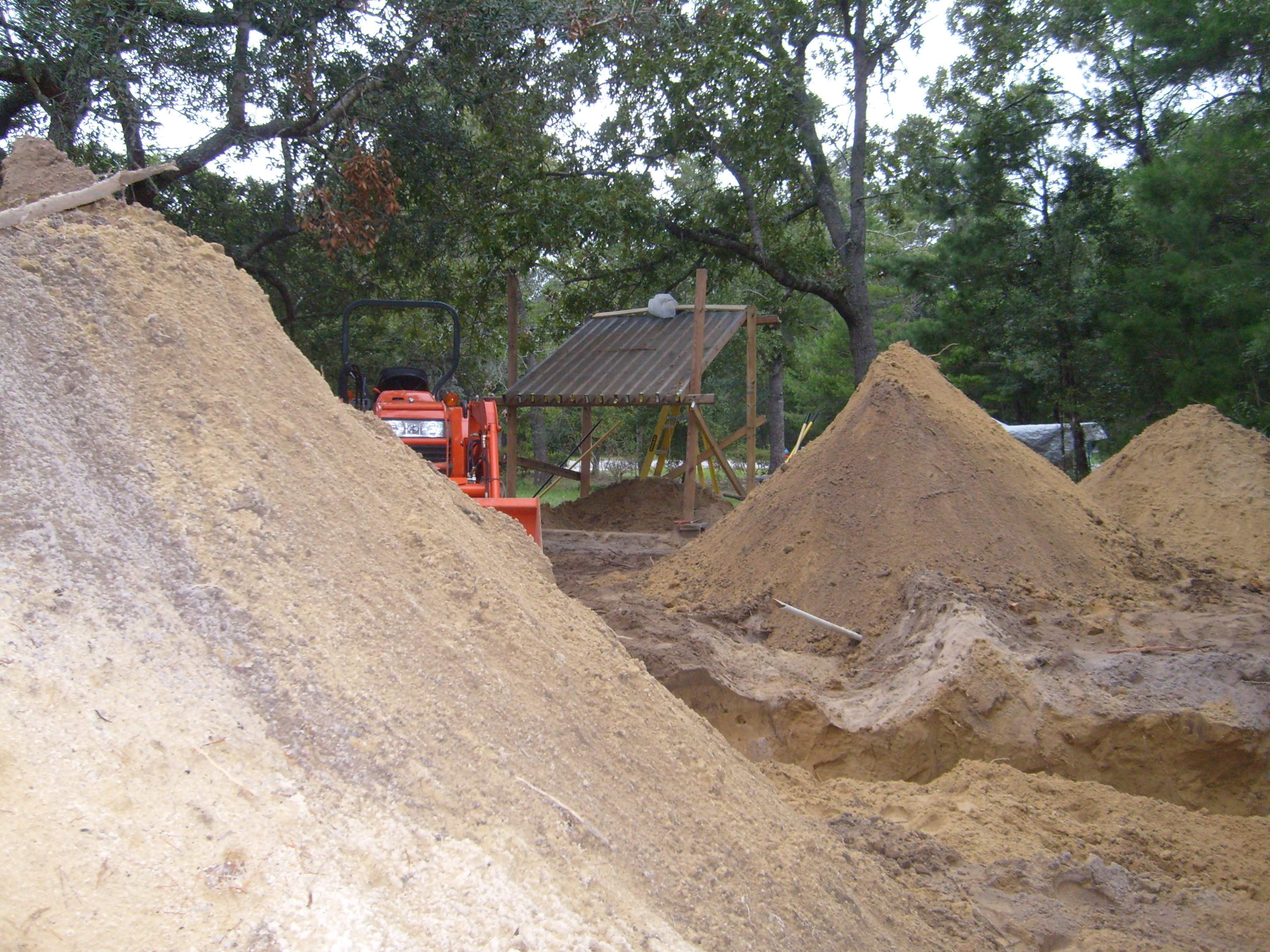

Sadly, I don't have any "before" photos to show you. The grey plastic you see was the interlocking seawall material that we are now using as the line of demarcation between sifted and not sifted. We have a pile of screened dirt out by the street (where the dumpster is in the photos) now that is about 15 yards or so, and we have another 15 yards piled up ready to sift. We're trying to dig down at least three feet everywhere in the pit, and then rake carefully over the bottom of the pit looking for any deep roots. If we find any we dig them by hand until we find the end.
Any full knuckle root will sprout, but luckily the hair roots will not. We are trying to sift so we don't have any roots left to sprout, so we expect to not use poison. If anything sprouts in the future, I'll dig it out again...
All of these photos were taken a few weeks ago. I'll try to post some new ones, including the modification to the front of the screen. By the way, the screen is 1/4" mesh.
- Just Gary

Products like Roundup won't touch bamboo. In fact, it will only make it mad. It gets a little distressed back to the first rhizome, and then the one behind it decides that it had better grow new sprouts.
I've asked around a fair amount, and most everyone says you can't kill it even with root poisons (except maybe Agent Orange, which I'm fresh out of). Our water table is only 15' to 18' down, and since we're digging down about 3' to 5' of that, I didn't want to spray anything if I can help it.
Honestly, the soil here is almost pure sand (with a touch of clay), so it really is easy to dig and sift. I did find one 3/4" piece of pea gravel last weekend. I have never seen it here, so no telling where it came from. Some areas here in Northwest Florida do have a lot of gravel, but not right here. I plan to plant a garden over the pit when we get done, just so we can watch for shoots coming up and not care if we have to dig them out. After a few years we'll let the grass invade and we'll be done...
Farmers around this region are having a problem with an invasive Asian grass called Cogongrass (http://www.cogongrass.org/cogongrassid.pdf). It also has rhizomes, and is very difficult to control. It reminds me of miniature bamboo, but Cogongrass also spreads via seeds and bird activity. Tilling and chemical sprays slow it down, but don't kill it. Bamboo is like Cogon's big, mean Uncle Guido.
Bamboo is fun to burn, since the segments explode when the water steams inside them. Sadly, you'd have to get one heck of a fire going to kill roots several feet deep. I'd rather not do that right next to the house. A good bonfire might kill Cogongrass, though, so I'll call the local forestry agent and ask if they have given that a good try.
I did save some of the shoots in the shop just in case a fishin' hole springs up in the pit...
