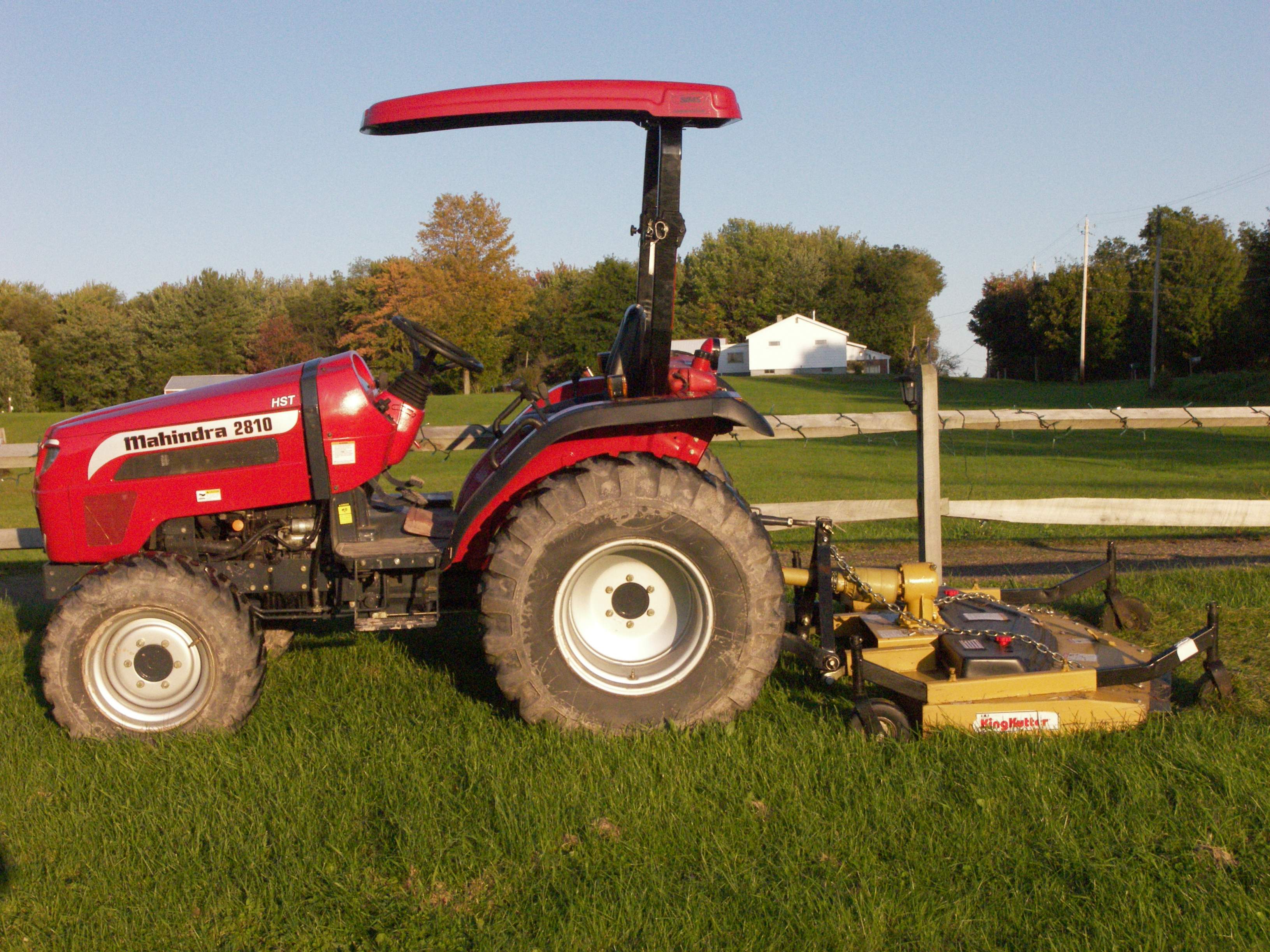

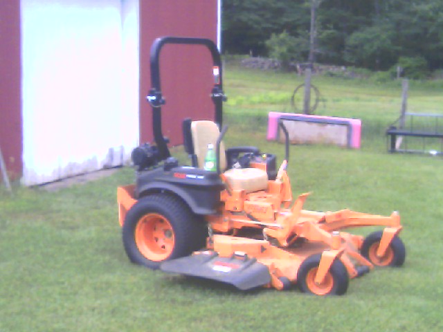

Ditto on the Zero Turn. I mow a lot of lawn each week and thought i was doing it quite fast, yea right! I bought a Skag 61" and what a difference! The lawn looks better, i cover more acrage faster meaning less fuel consumption.
I was mowing with and still do in certain areas use a Mahindra 2810 HST with a 72"KK RD finish mower. At my place this year it's going to be about 32 acres and 3 to 4 other lawn averaging 2 - 5 acres. The zero is the machine of choice on those. Some of my mowing is on soft ground and the ZTM treads lightly but you have to be careful on your turns.
In the first picture, the lawn behind the tractor looking at my house is mowed with the tractor simply because it is about 700' long, its to hard for me to mow straight lines that long with the "Z"
IMO the only problem with my ZTM . . .no cruise control. . . .John
